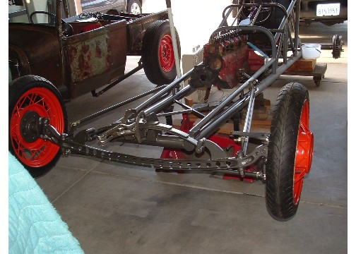

    Well I got the welding done on the front end and 90% on the steering on Monday, Sprayed the front end parts and front 1/3 of the frame with Lowe's best rattle can dark bronze, packed the front wheel bearings, need to complete steering shaft support, make the aluminum pitman arm and weld up a steering drag link, pickup the rear tires and we will have a complete roller.
    Ya it is not a lot of production for a real fabricator, but for this old timer a little each day keeps the build on schedule. I like the drilled axle more each time I look at it, brings out the "old school hot rodder" in me.

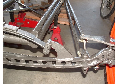

    Well I got to work on the pitman arm today and have it mounted. The front steering arm on the spindle measures 6 1/2" from the mount to the center of the steering drag link hole, so in the pitman arm I drilled 3 holes that are
    5 1/2" / 6 1/2" / 7 1/2" down from the shaft center line. I think I will be able to set the steering at the middle hole for a "neutral" setting and can move it up or down to slow or speed it up. Lot of hand work, filing and sanding. Don't need a stink-en mill, OK I wish I could afford one.:rolleyes:
    In testing it I still think I need to install a shaft support at the frame for the steering tube that comes from the box. I have more play in this area than I like. I think a Teflon block will work fine, so I will work on that later this week.
    Next on the list is the steering drag link and with that we should have a steerable car.
    Got to make a trip to **** (ThingyM) shop tomorrow to scrounge some more parts & pieces he is offering me,I "never" say no to parts.
