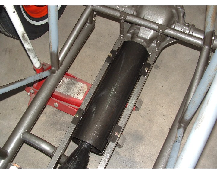

  4. Old28
    Joined: Jan 11, 2009
    Posts: 1,390
    Old28
    Well I got a little more done on the car in the last few days. Built a dual anti-rotation setup to hold the rearend in place after the KILLER 194" power house shears all eight 5/16" grade bolts that are holding it to the ch***is, What is NHRA thinking, talk about overkill.:rolleyes:
    If it keeps our local tech guys happy it was time well spent.
    Got the 5" x 20" tube cut in half with my trusty 4" cut off wheel and set in place for a trial fitting. Looks like I will have 1/2" to 3/4" clearence all around. Hope to get the tabs welded on and the cover in place on Friday.
    Next things on list are firewall, floor and shifter mount.
    HAVE A GREAT TURKEY DAY & STAY SAFE

    Well got the drive shaft cover done today and need to get into car tomorrow and get the measurements for were to place the front loop.
    Got to make sure that I have the 3" open space in front of my helmit as they have taged a few cars at our track for not having the 3" from your helmit face to the front bar face.
    Next week it's floor and firewall.
