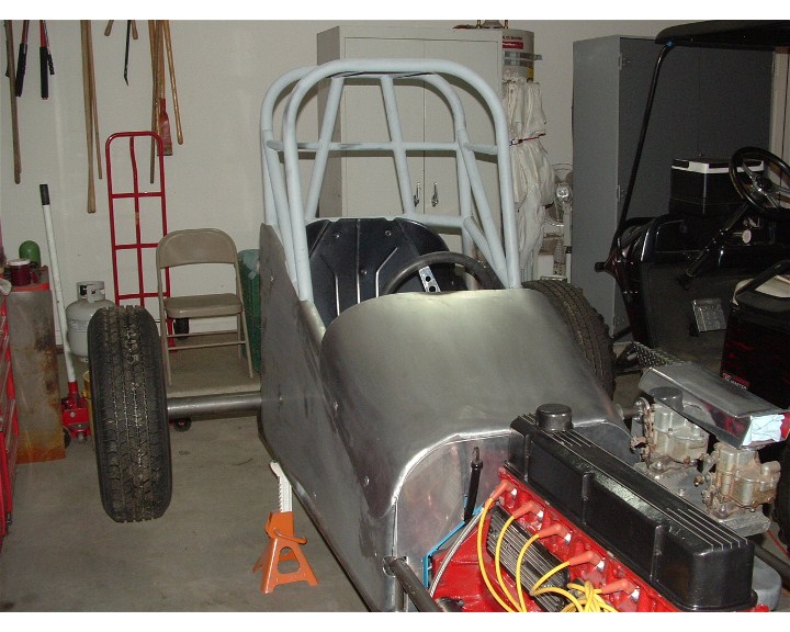

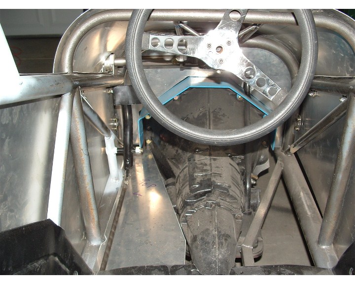

    Well this has been a good week for therapy for me as I was able to pickup the car from my good buddy Danny V how has been doing some work on the car while I am recovering from surgery. I will never be able to thank him enough for what he has done for me.:)
    The front cage section, helmet bars, brake peddle setup and the body panels were all done by him. I had started fabricating both the floor plates and the firewall before my surgery and need to finish them along with building the trans cover. I have been collecting a lot of stuff in the past 3 months and it should keep me busy for a while.:rolleyes:
    Working on the car today has been the best therapy I have had in many months, glad to have the car home.:D
    Just a few pictures of the work that was done, more later.

    Darn Tom, That is going to be one fine looking car.. Danny did a great job..

    ThingyM -- Ya ****, I am real pleased on how the cage came out and I have a good 3" clearance on the front with my helmet that should keep tech guys happy. It takes racers like you and Danny to help a old "Driver" try to be a "Builder", but I like the direction the car is going. The body panels and the brake setup look real nice.
