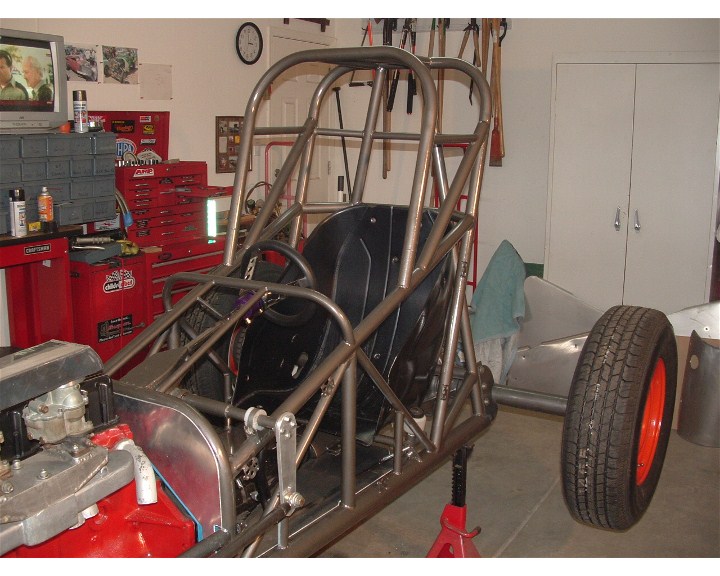

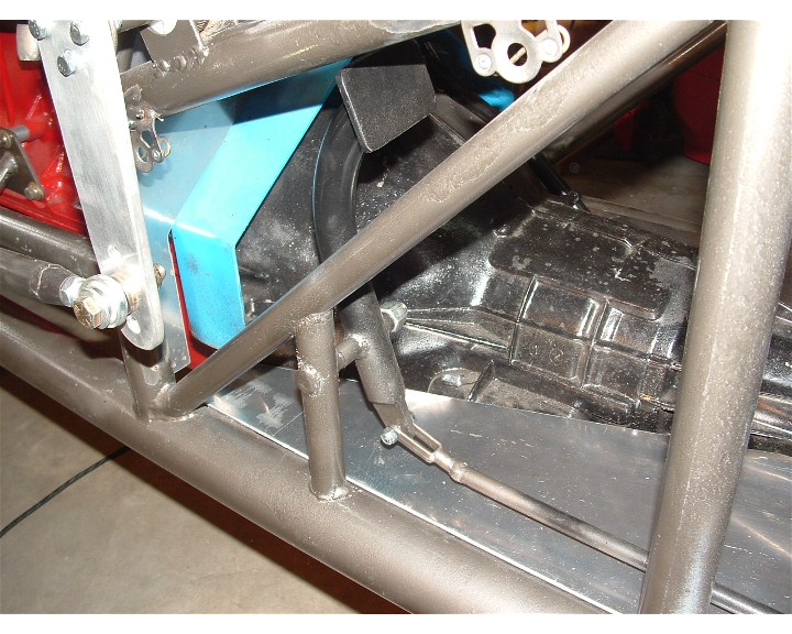

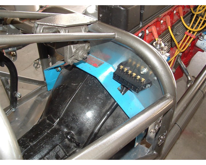

    Well I got a few more things done the last couple of days. Most of the work was on Battery Box, Electric cut off switch, Volt meter, Required tail light. Today I completed plumbing the brake system and got them working.
    Started work on the dash unit, hope to have it done tonight.
  29. Old28
    Joined: Jan 11, 2009
    Posts: 1,390
    Old28

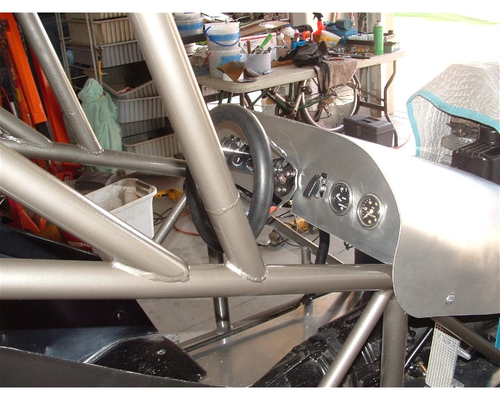

    Well I got the dash cut out and notched for the steering quick connect. Switches, water temp & oil pressure gages mounted.
    Today was the first time that I was able to get in the car and see how hard it is with the new front roll cage bar. I will say that with the dash, cowl cover and the new bars it was a little harder than before. Ain't that easy to get these old bones working again.:)
    I will say that it sure felt good after 4 months recovery (still have a ways to go)just to sit in the car again. I feel good sitting in seat, the new front cage bar is a solid 3" from my helmet face front. I am a little tight in the leg/foot area and will have to redo the brake peddle and move it forward. I will be cutting another 1 1/2" off the dash bottom for a little more clearance.:D
    Was able to get my measurements for the driveshaft and my shifter mount today, so I can start working on that stuff next week.
