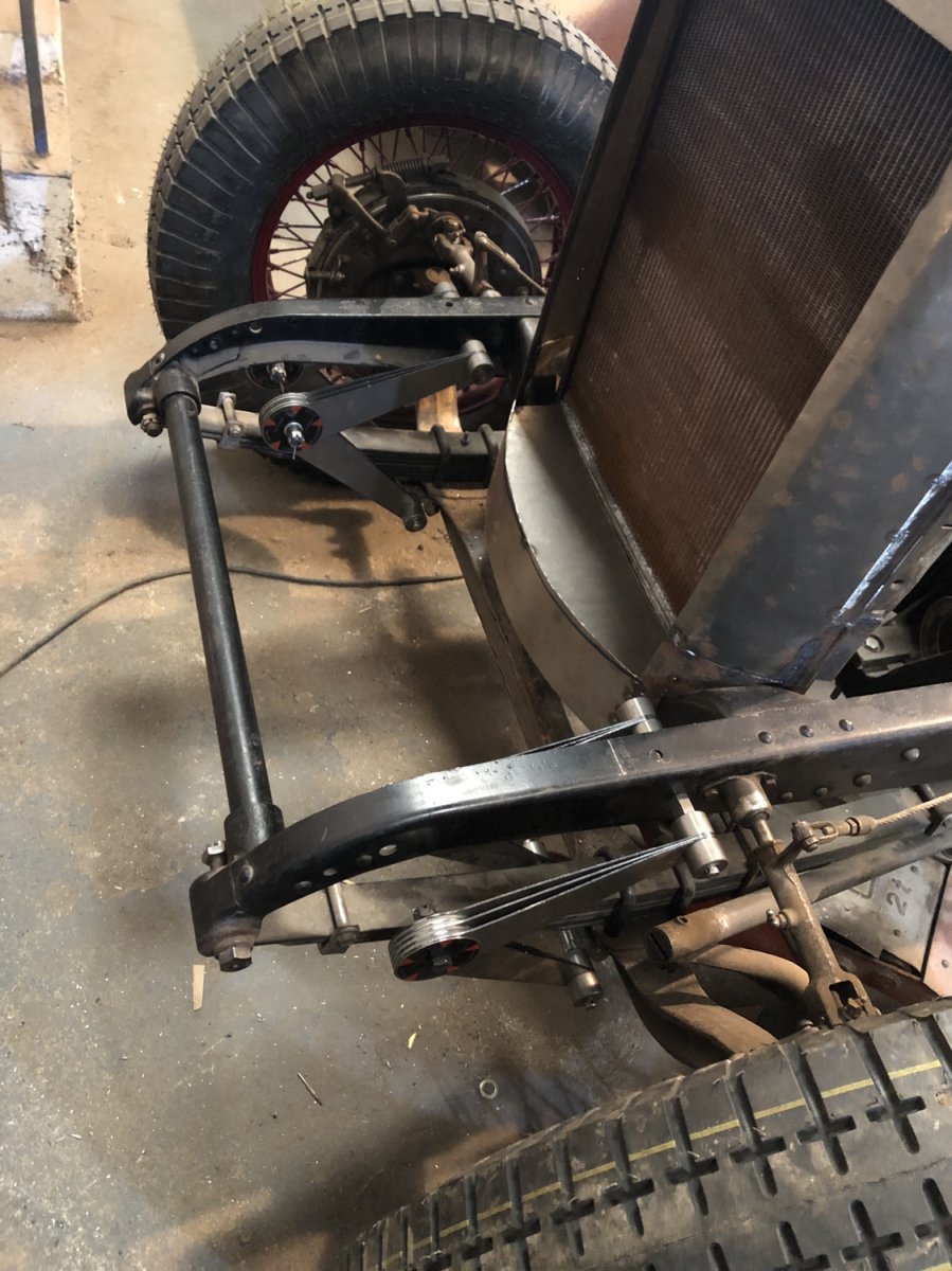

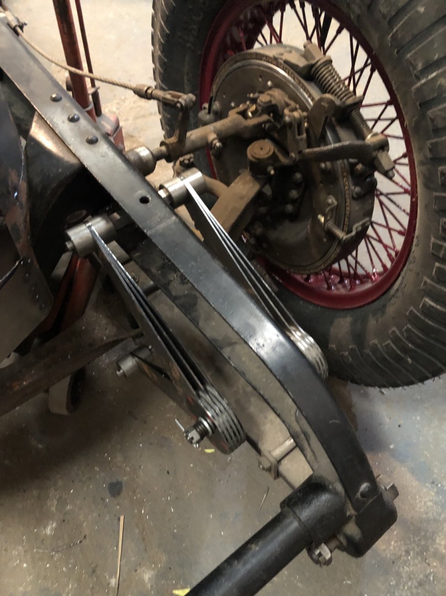

    We made our own set of friction shocks.
    4 in front and 2 back in the rear.

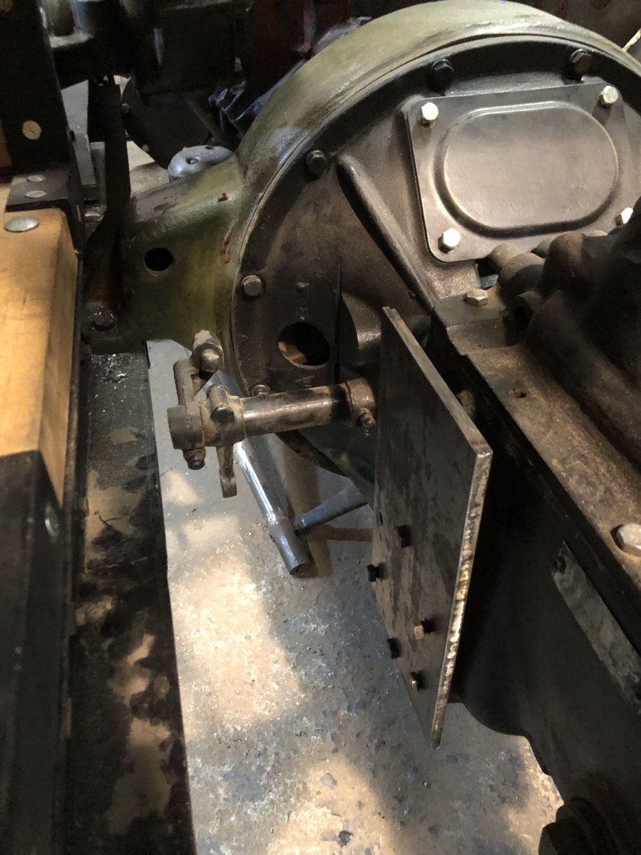

    We cut a steel plate to act as support for the pedals axle.

    Here the Seagrave has a lateral power exile to the water pump. We’ll cover it with the steel plate.

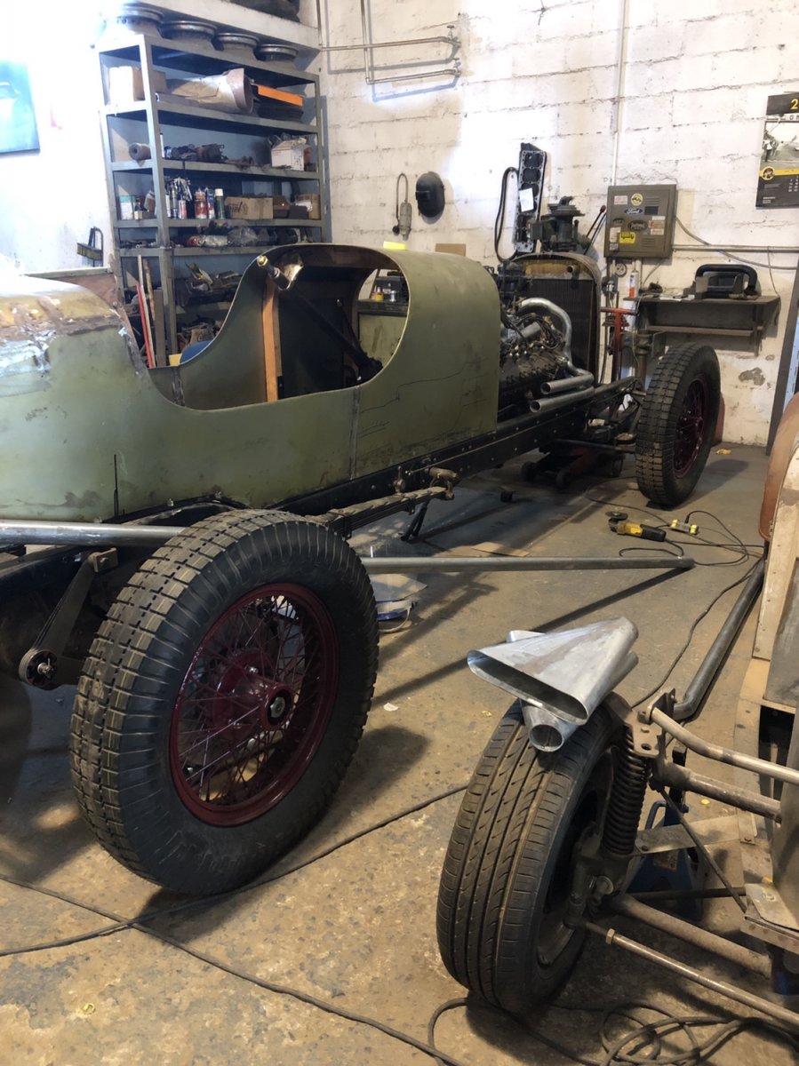

    We took the body off from chassis to make the steering and fuel line installation.
    Two people can easily handle the whole body.

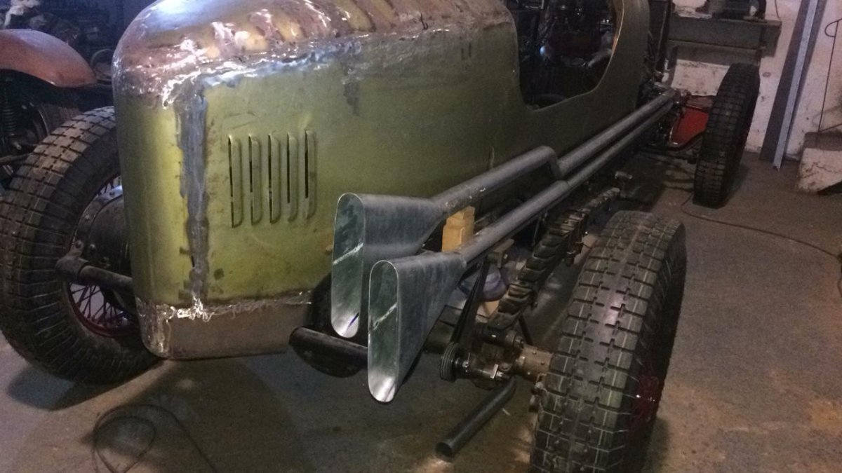

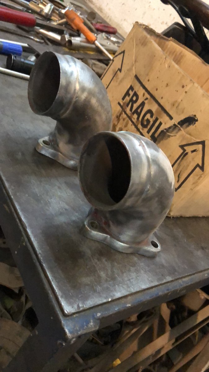

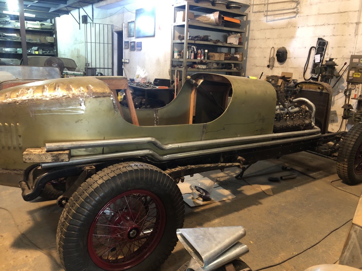

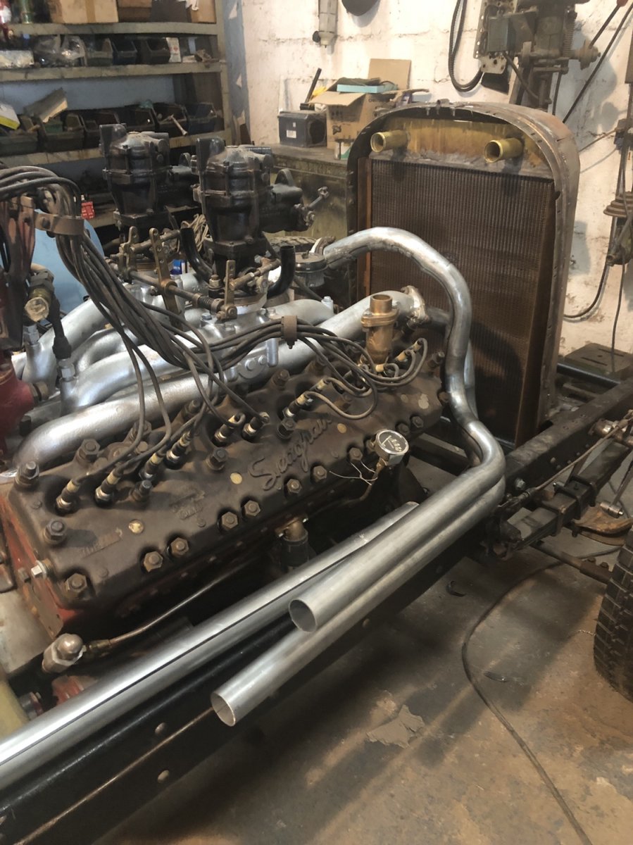

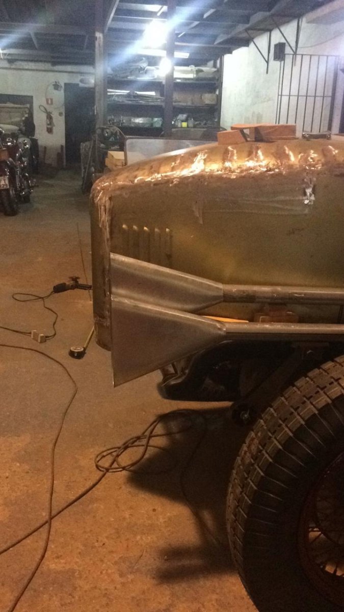

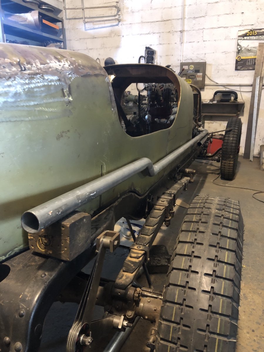

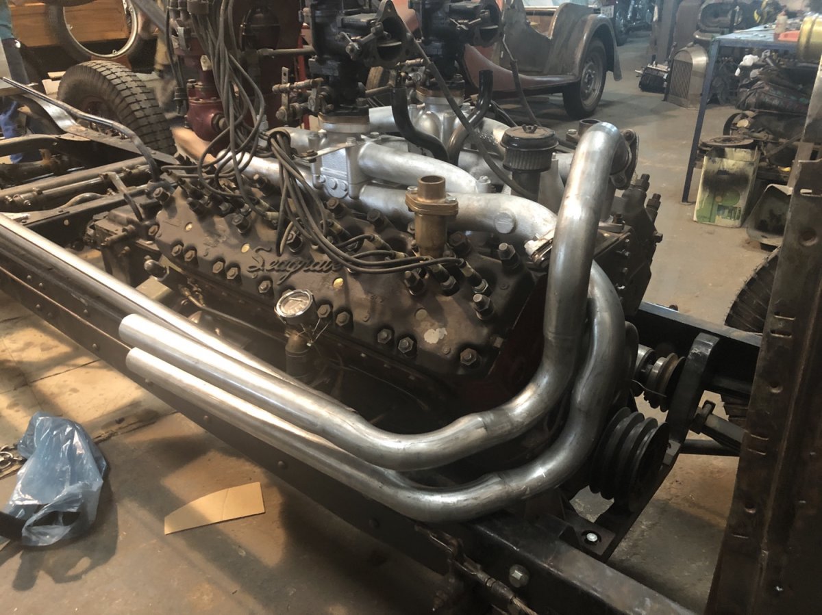

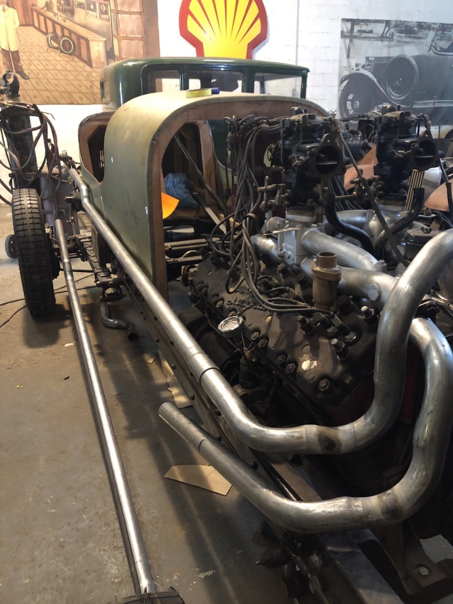

    Carburetors air inlets.
    We made some tubes for the exhaust.
    IMG_2608.JPG IMG_2708.JPG IMG_2719.JPG IMG_2720.JPG IMG_2721.JPG 5239fd0b-edb3-40b6-845f-29d45de51ee1.jpg
    Megaphone Pipes.
    Enviado do meu iPhone usando H.A.M.B.

    Love the exhaust, especially the tips! From my experience, you might be a little disappointed at how quiet it might turn out to be. After I got the two 180 degree turns to bring the exhaust around the front of the engine and then ran it through over two 20 foot lengths of 2 1/4 tubing, it was downright mellow!
    Stogy, chryslerfan55 and Drmalacarne like this.

    Thanks!
    I’ll try to post a video with sound soon.
