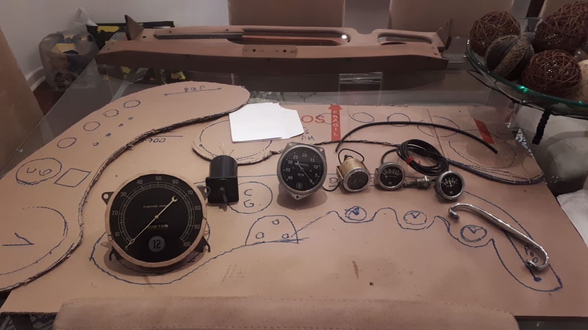

    Dashboard layout done.
    Now we’ll cut a 6mm stainless steel plaque to make the base to the clocks.
    Enviado do meu iPhone usando H.A.M.B.

    What is that speedometer out of?
    www.speedoservice.com
