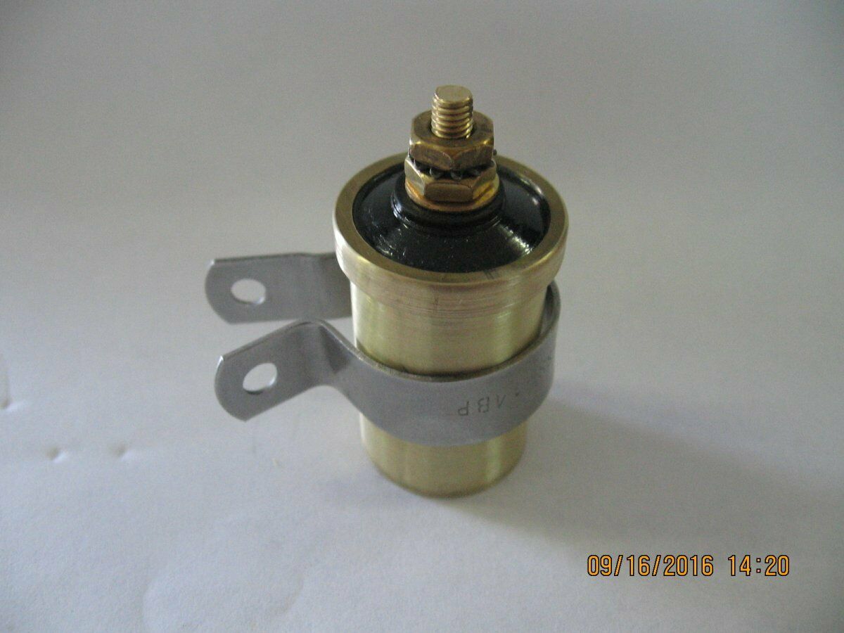

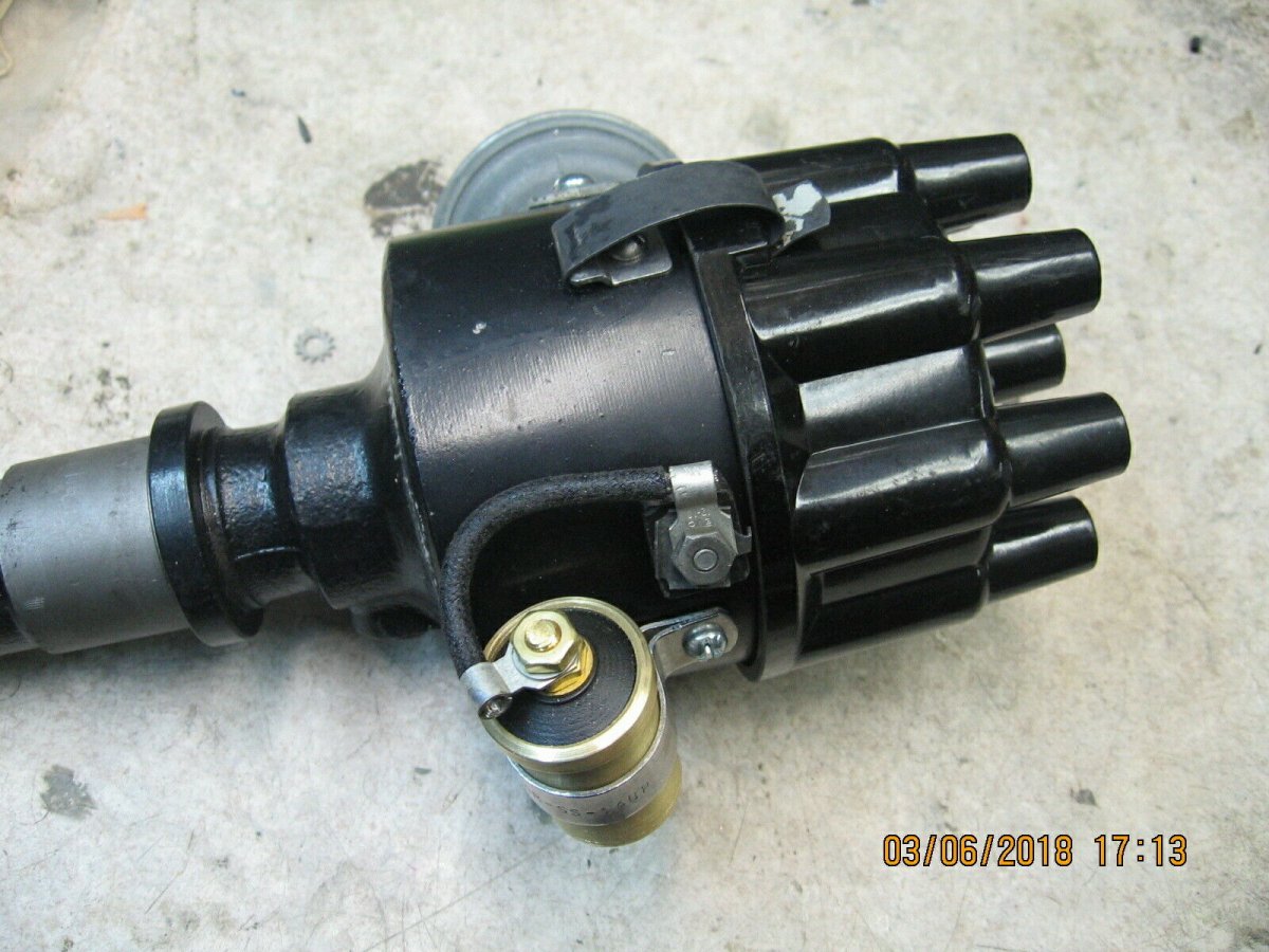

  7. tubman
    Joined: May 16, 2007
    Posts: 7,945
    tubman
    One last note on condensers. If you can't find any to fit inside the distributor, you could always run an externally mounted condenser. All the Mallory and other racing dual point units did, as the second set of points took up the space inside the distributor usually occupied by the stock condenser. They are quite easy to mount and hook up. The only problem with this is that a stock type condenser looks kinda crappy hanging off the side of a dual coil, dual point distributor. The original Mallory's used a proprietary big brass condenser that looked liked it was meant to be there. Unfortunately, they are hard to find these days and unsplit ones are very expensive. In a bit of shameless self-promotion, I will mention that I am now producing replacements for these. Here are a couple of pictures.

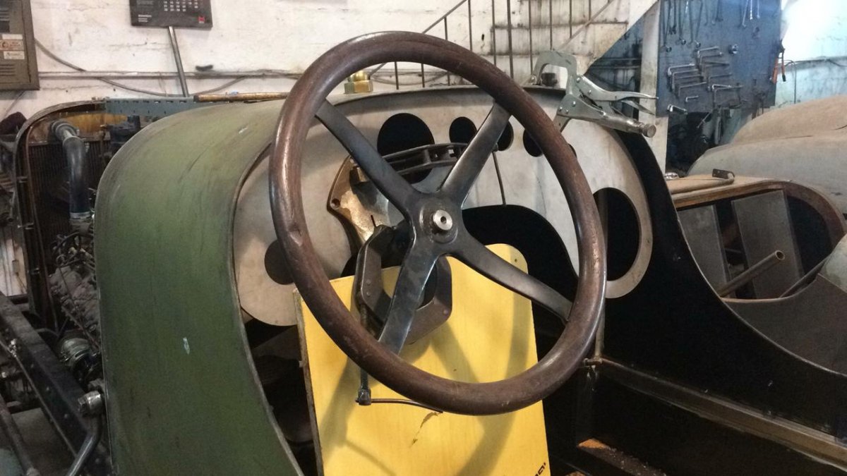

    We are using the original 1926 Buick steering drop support.
    Às Dashboard we cut a 6mm stainless steel sheet.
    Gui
    Enviado do meu iPhone usando H.A.M.B.

  20. tubman
    Posts: 7,945
    tubman
    The dash and the column drop look like they were made for each other. Come to think of it, they probably were!.:rolleyes:
  21. Rickybop
    Joined: May 23, 2008
    Posts: 10,477
    Rickybop
    That's a hefty dash panel.
    Stainless. 1/4"?
    No bracing needed.
    It IS the brace. LOL
    Yup...
    This thing's gonna last forever.

  23. tubman
    Posts: 7,945
    tubman
    Just out of idle curiosity, how much does that dash panel weigh?
    Deuces, Stogy, loudbang and 2 others like this.
  24. Drmalacarne
    Joined: Sep 3, 2019
    Posts: 283
    Drmalacarne
    Some 12 pounds.

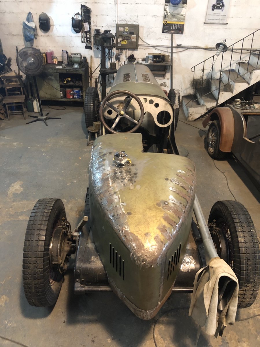

  25. Drmalacarne
    Joined: Sep 3, 2019
    Posts: 283
    Drmalacarne
    IMG_3940.JPG IMG_3941.JPG IMG_3943.JPG IMG_3944.JPG IMG_3945.JPG IMG_3946.JPG IMG_3948.JPG IMG_3950.JPG IMG_3953.JPG
    Now we’re molding the hood.
    We decided to put some louvers over it and in the side too.

  27. pumpman
    Joined: Dec 6, 2010
    Posts: 2,674
    pumpman
    Coming along nicely, definitely has the look. Was the thickness of the dash to add structural support to the body also?
    Deuces, loudbang, 41 GMC K-18 and 2 others like this.
  28. Rickybop
    Posts: 10,477
    Rickybop
    Finally, some good overall pictures. Starting to look like a car. Looks great.
    Did you mention what color you might paint it?
