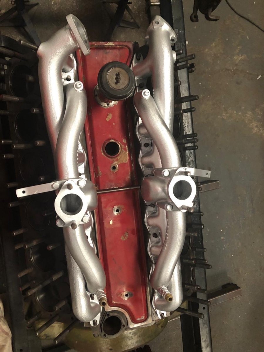

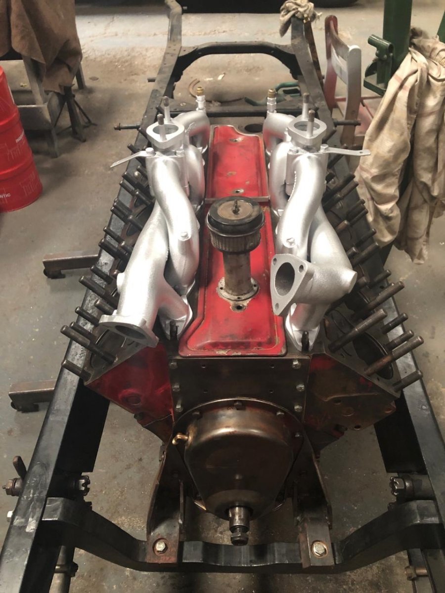

    After partial rebuild the engine went to the ch***is.
    Looks like a porcupine.
    We found a nice position for the V12 heart of he Hot Rod.
