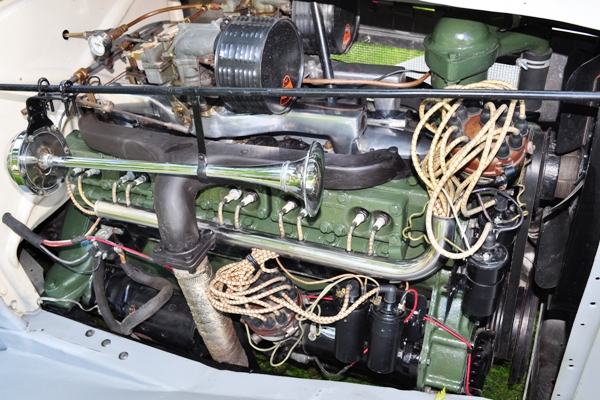

    Thanks for the tip about the ignition wires colors!
    Your engine is beautiful!
    I’ll take a picture of the distributor cap soon.
