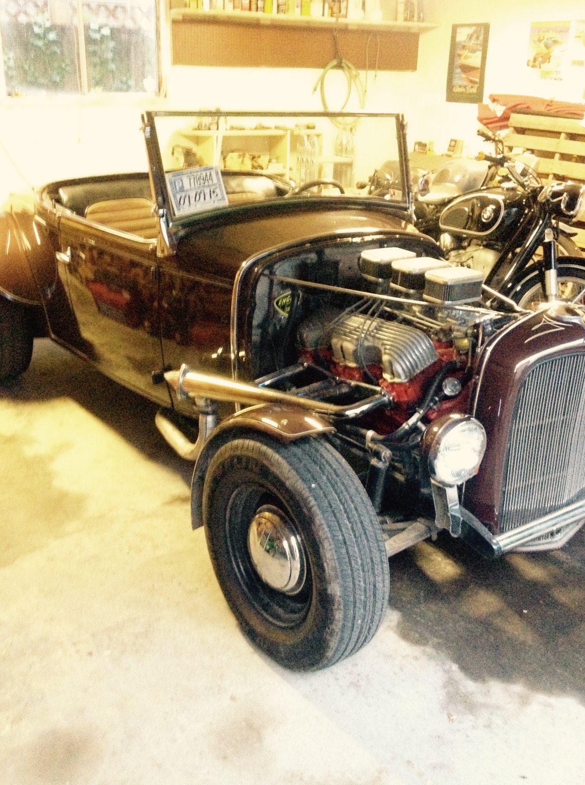

    I've got a tiny pinhole leak at the bottom of the radiator in our recently-purchased '30 roadster. The previous owner says to tip in a little Silver Seal. I've heard this stuff can plug up engine water passages but the previous owner says "Pffft!" and the guy at the local NAPA says he's heard it works and has never heard of any problems. What's the skinny?
