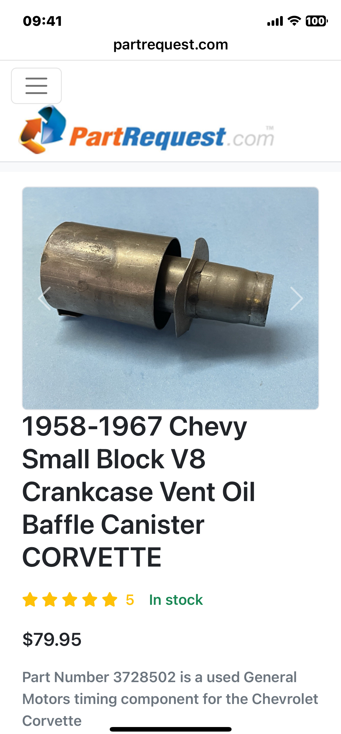

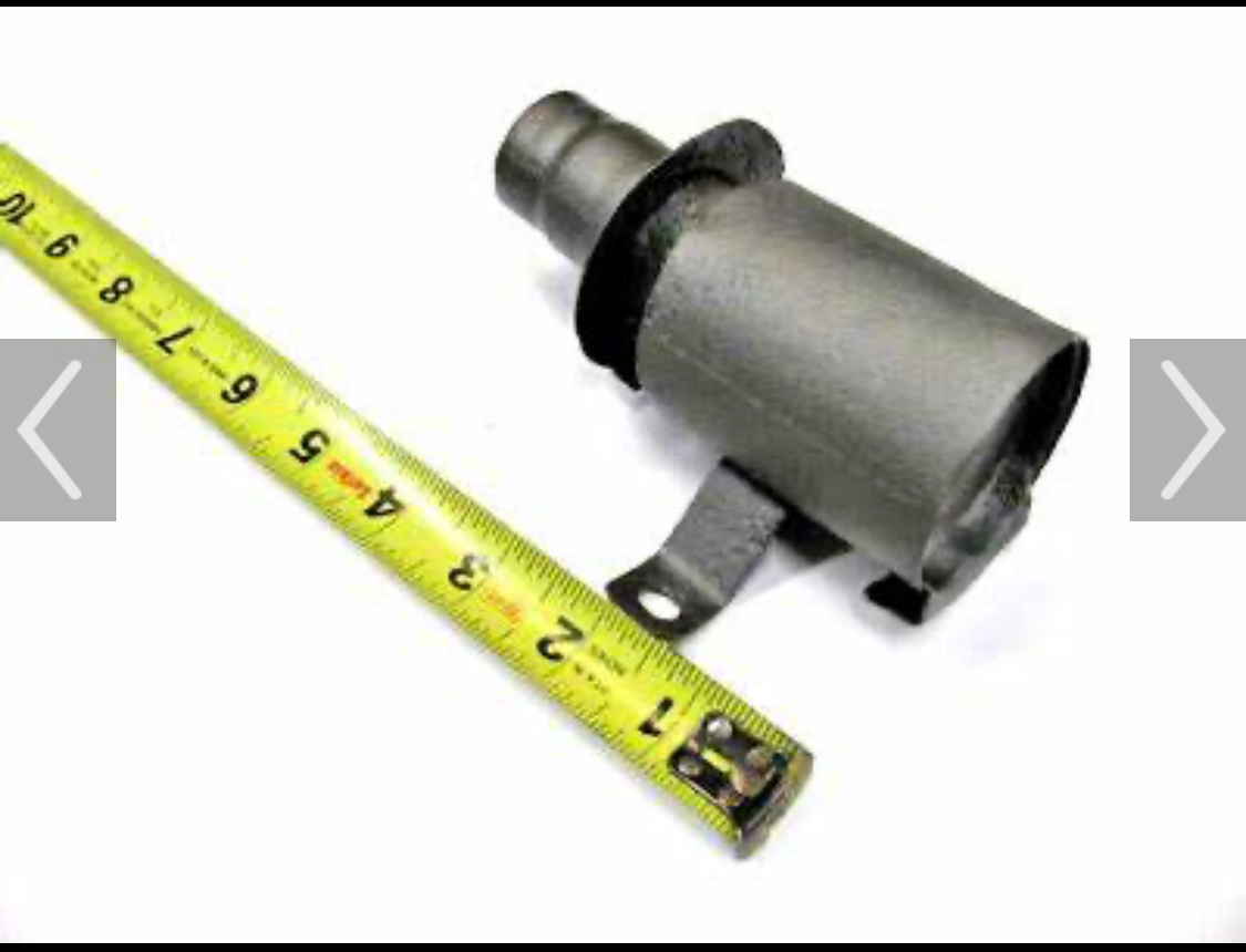

    Do you have the large or small oil baffle in the valley? If you have the long one which came on 2 barrels intake and not the short one it will inter with the intake sealing. You have two choice's find a small one or take a hammer and flatten it so the intake will fit flat. Try setting the intake on without gaskets if Rich’s you have interference with the oil baffle. Don’t leave it Out or it will leak oil out the road draft tube or the vent to breather if you have a PVC system like crazy. Here is a picture of the short version. I figured it out in 1959. IMG_8718.jpeg IMG_8717.jpeg

  21. 2OLD2FAST
    Joined: Feb 3, 2010
    Posts: 6,062
    2OLD2FAST
    from illinois
    WOW $80. SMH
    Hot Rods Ta Hell likes this.
  22. 2OLD2FAST
    Joined: Feb 3, 2010
    Posts: 6,062
    2OLD2FAST
    from illinois
    I believe your right , I was thinking 66 instead of 56
  23. 1-SHOT
    Joined: Sep 23, 2014
    Posts: 2,906
    1-SHOT
    from Denton
    You got a pay to play

    ^^^^^ Double check this. Make sure the intake manifold is not hitting the oil baffle in the lifter valley.
