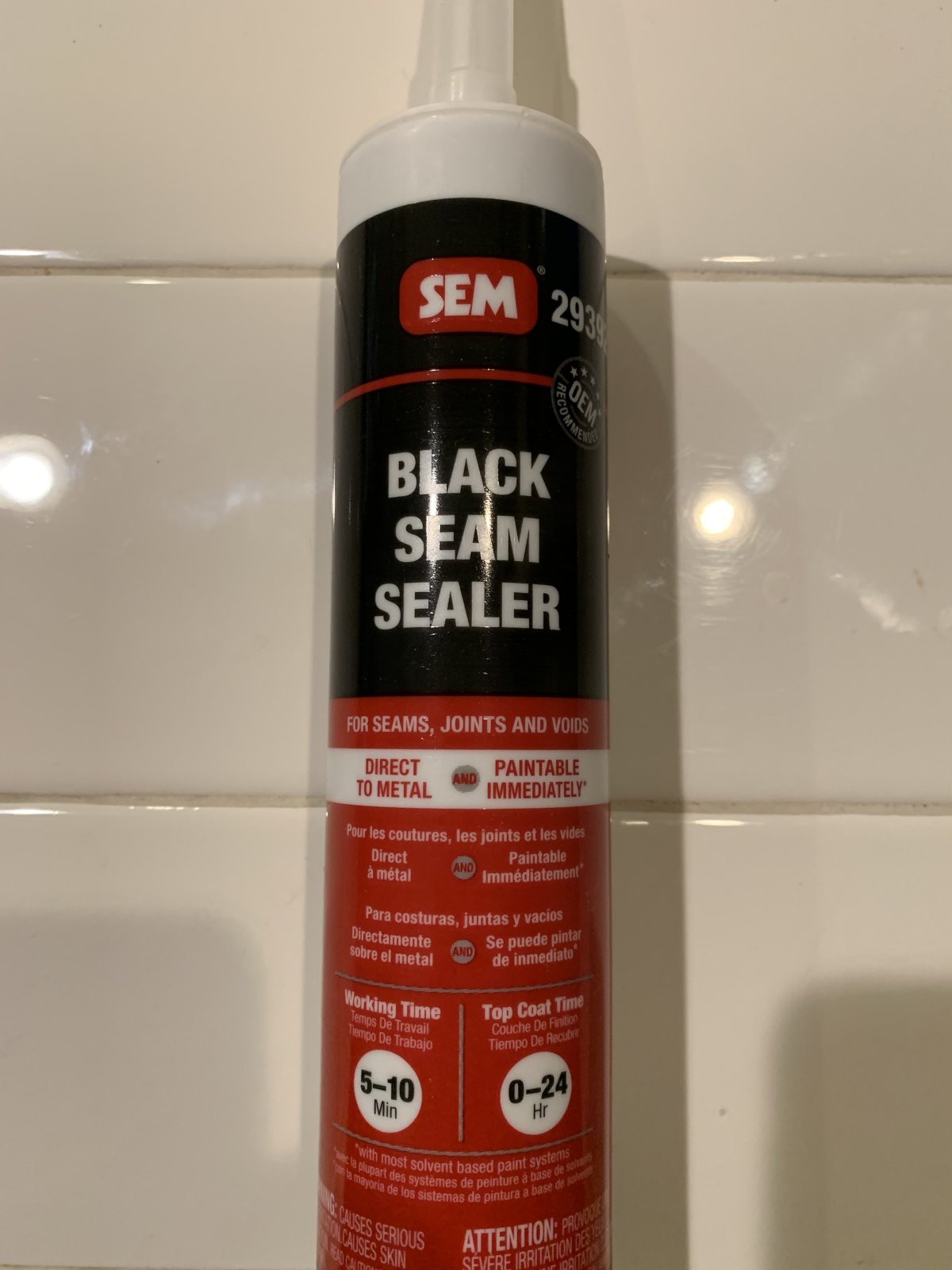

  8. Jim Bouchard
    Joined: Mar 2, 2011
    Posts: 1,359
    Jim Bouchard
    I’ve been very happy with this product.
    In fact I’m a big fan of all Sem products
    It’s professional quality, made in the USA, lays down nice. Goes directly onto metal to metal between seams as well as filling gaps and small voids. The work time is quick and I can paint over it in 24 hours. And it’s black so it virtually disappears or blends in with the undercoating.
    It’s almost $20 a tube but it’s the proper stuff for the job. I work on these cars professionally. call me a snob, but I’ll save the liquid nails for the plywood.
    Use it directly out of the tube with a caulking gun, followed quickly behind with an acid brush to smooth out. Dip the brush in a cup with acetone and keep moving down the line.
    Blob some on some cardboard and use the brush to spread it around as needed.
    The Eastwood product mentioned above is also very good and I recommend that as well.
