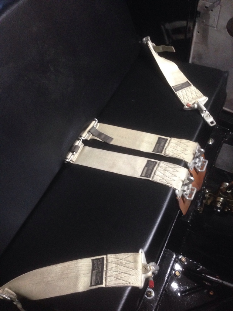

    I managed to come up with a way to install the pristine surplus aircraft seat belts he brought me, these were mandatory in order for his daughter to take rides in her grandpas car per her mother. No argument there.

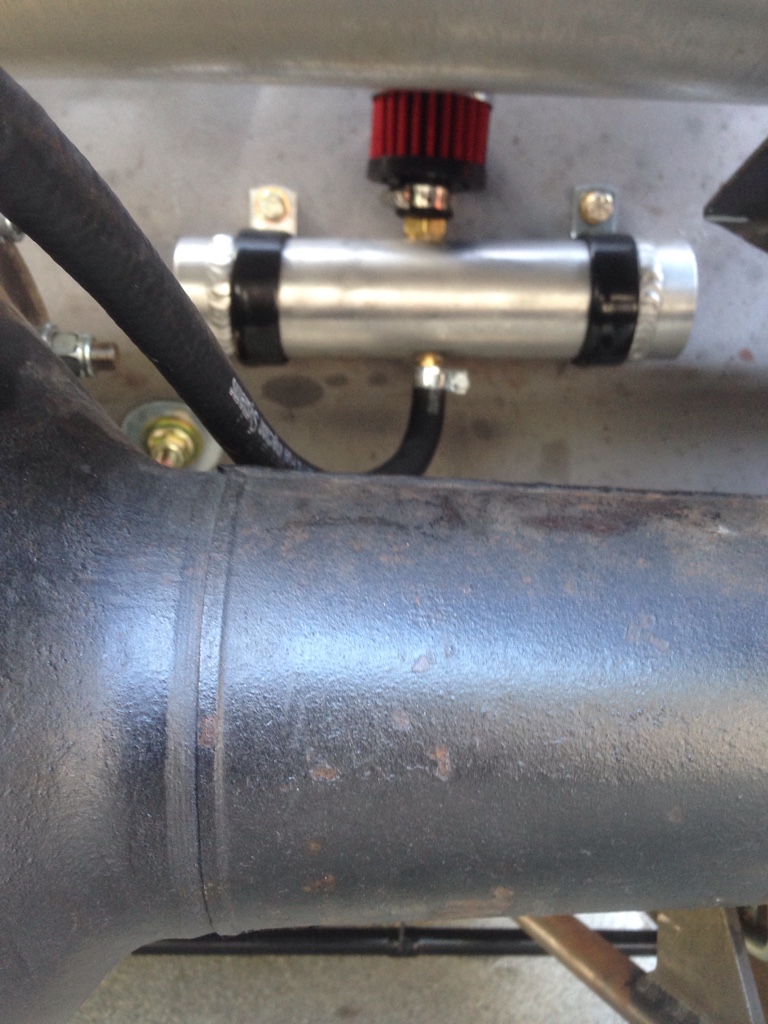

  8. So there was a problem with oil puking out of the breather on the quick change. My solution was to make an air/oil separator out of some aluminum tube and solid stock. I machined some end plugs with a step so they fit snug inside the tube. I also machined a bevel on the caps and tube and welded them up.
    Some quick work with a pipe tap made it so I could put some hose barbs on it and topped it off with a clamp on valve cover breather filter. The idea is to let oil settle in the mini tank and allow hot air to vent. When it cools down the suction will draw the oil back into the axle. It's only a small bit of oil but it makes a huge mess when it sprays everywhere while driving. Hopefully it will be better, haven't tested it yet.
    Total cost was an hour and a half working and welding with the s**** aluminum and 22 bucks for the filter. Hose barbs were just laying around. Summit wants over 90 bucks for the same thing. ImageUploadedByH.A.M.B.1465602851.913576.jpg

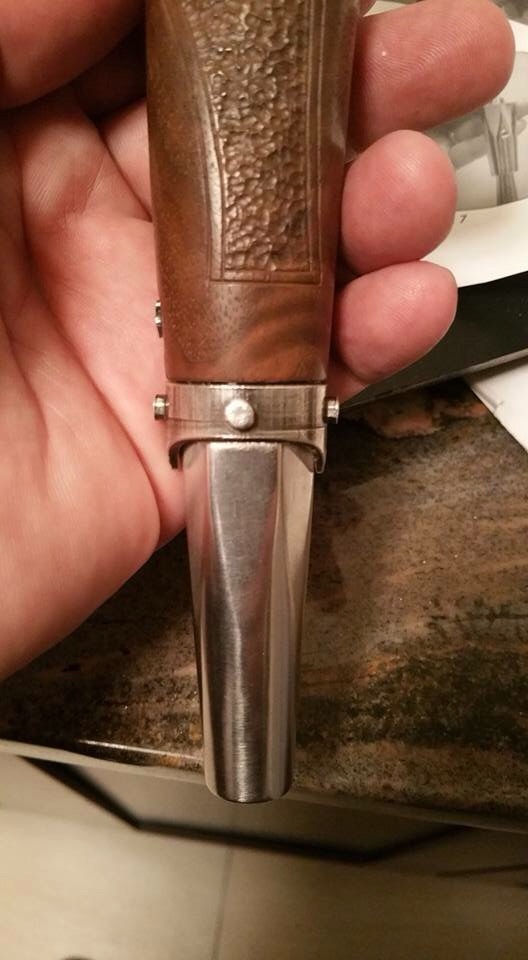

  19. Sean just sent me these pictures of a custom shift knob hand made by his friend Jeter Case of Jackson Hole, Wyoming. It features Sean's fathers initials at the base and his nick name initials on the top. He even integrated the Lokar mechanism so I can just bolt it on and not risk ruining it tryin to do it myself. Pretty neat, and gets rid of the generic Lokar knob. ImageUploadedByH.A.M.B.1465878828.825639.jpg ImageUploadedByH.A.M.B.1465878837.825133.jpg ImageUploadedByH.A.M.B.1465878845.258188.jpg ImageUploadedByH.A.M.B.1465878853.474753.jpg

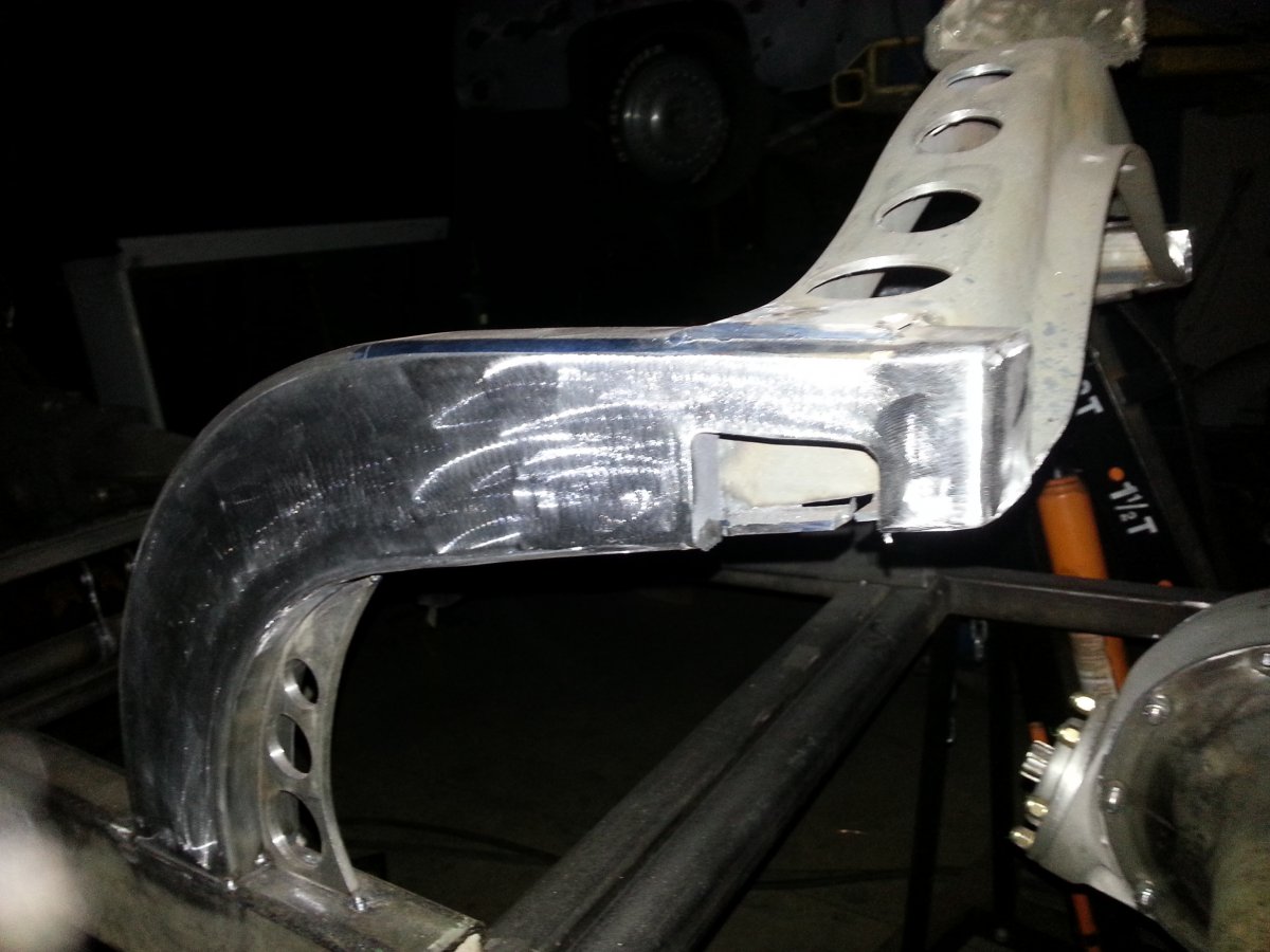

  24. gimpyshotrods
    Joined: May 20, 2009
    Posts: 24,630
    gimpyshotrods

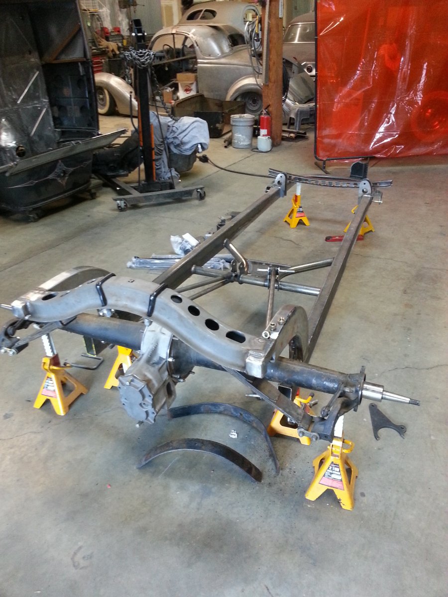

    Posts #5 and #9 have most of my good picture of the ch***is.
    That should tell most of the tale. I can answer questions about the remainder.
    Stogy likes this.
  25. TigerFan
    Joined: Oct 29, 2010
    Posts: 152
    TigerFan
    from Athens, GA

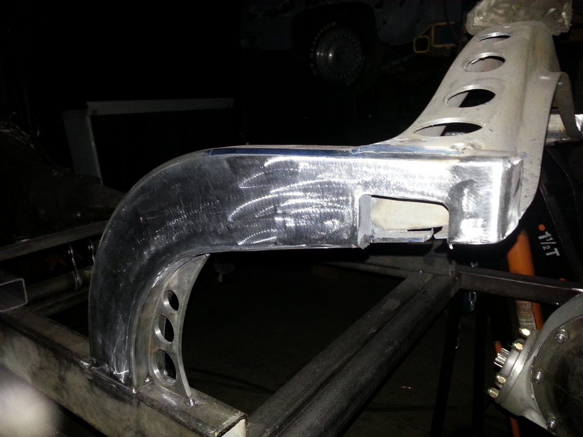

    Was your choice in curving the kick up in the back as opposed to using a "Z" purely cosmetic? How high is it?
    Stogy and gimpyshotrods like this.
  26. gimpyshotrods
    Posts: 24,630
    gimpyshotrods
    Pure aesthetics. It is 16".
    Stogy and kidcampbell71 like this.
