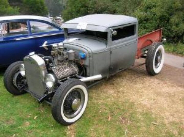

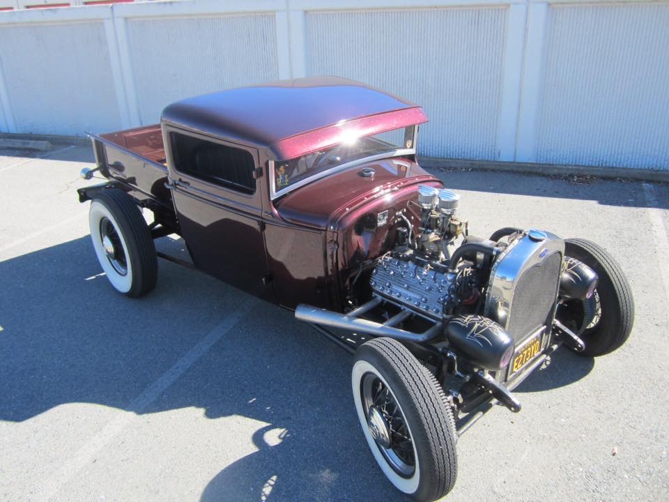

  7. I do not, I joined here back in 2003 at the advice of some other guys in the Vallejo Swanx car club. They said it would be a good place to learn how to get started on my little truck, but me being me, I just went at it and figured it out on my own. If I would have asked around here first it probably would have only taken 2 years instead of 4 to get to the first incarnation of it on the road. Then it was blown apart in 2010 to get painted and back on the road in 2014 (paint and body work jail is a *******, had to learn to do how to sand **** myself until I was ready to hand it over to the painter, and he still had to correct all of my ****oos.)
  8. Here it is around 2007 at the SF Rod and Custom show at the Cow Palace, I had it wired up and running a few weeks after this show, the lower pic was is obviously it now with the "new" headlamps and shiny paint. I'll see if I can find more pictures to post, I didn't really do***ent the build that well.

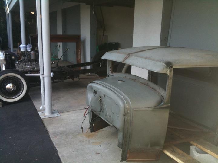

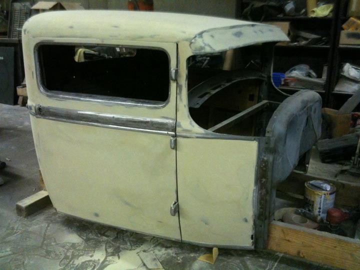

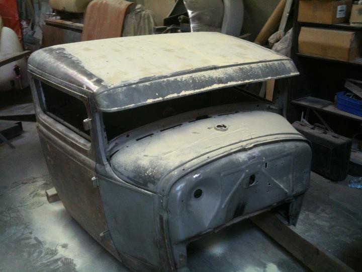

    NICE JOB! I know Ford made a full steel toped pickup with a wide bed in 1931, looks like you had the visor part to start with, correct? Why did you have to split it in the center?

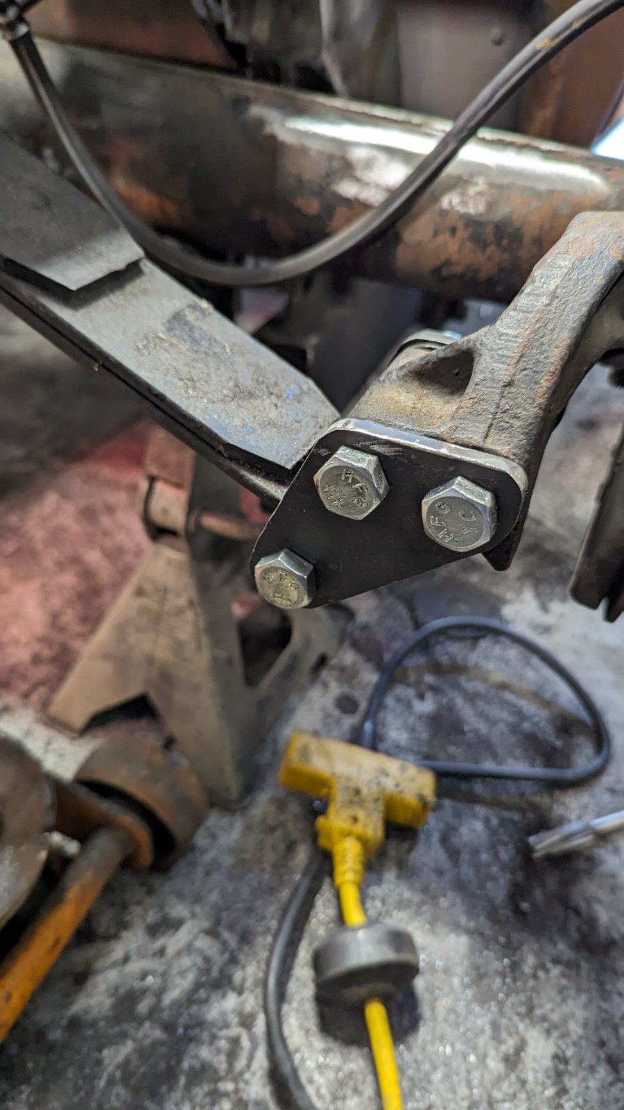

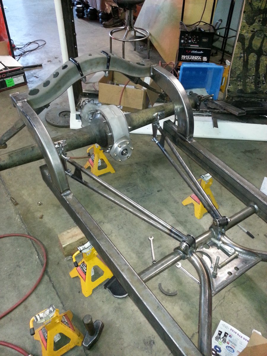

    On the T, the steering has since been revised for correct Ackerman. I added a 2:1 box in the steering column to give the driver more comfort and leverage.
    The front tube axle has been replaced by an I-beam, it now has tube shocks, and a dead perch in the rear.
    I moved the radiator forward a little, as Sean wants a 4-71.

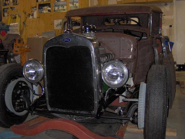

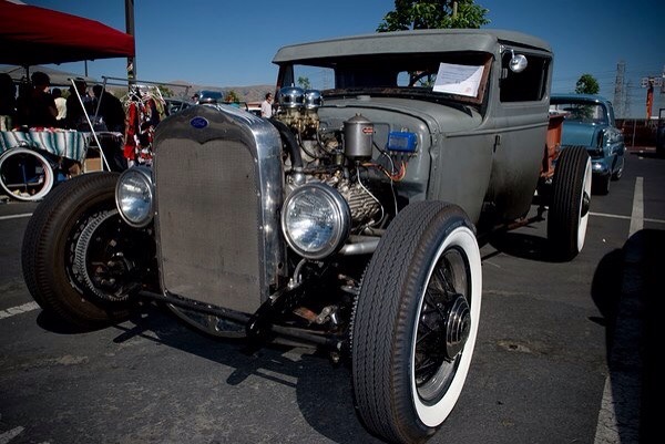

    To the OP, or whoever owns this now;
    Do you know the make n yr of the headlights? Pic copied from p1, early pics.
    I've seen them before, but can't place them. I do like them.
    TIA.

    1929 Willys Knight.

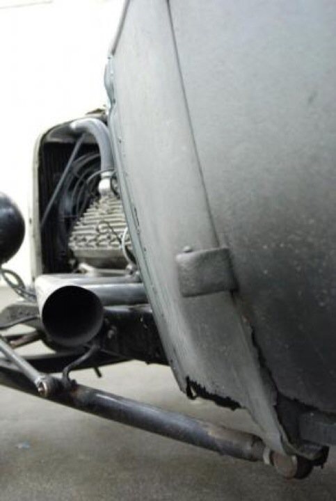

  23. @The37Kid I went by Sanderson Headers and scooped up some cast offs from their bin and pieced them together. I mirrored them by bolting the flanges together and tacked them all together before TIG welding them all around. The process worked pretty well.

  25. nrgwizard
    Joined: Aug 18, 2006
    Posts: 3,420
    nrgwizard
    from Minn. uSA
    Gimpy; Thanks.
    I noticed they aren't being used anymore. Preference, or an issue w/the lights?
    Marcus...
    Stogy and gimpyshotrods like this.
  26. It was a preference thing, I only initially put them on because that is what the car arrived with and the owner was new to all of this. He started making the car his own after getting seat time with it.
    Stogy, gimpyshotrods and Tim like this.

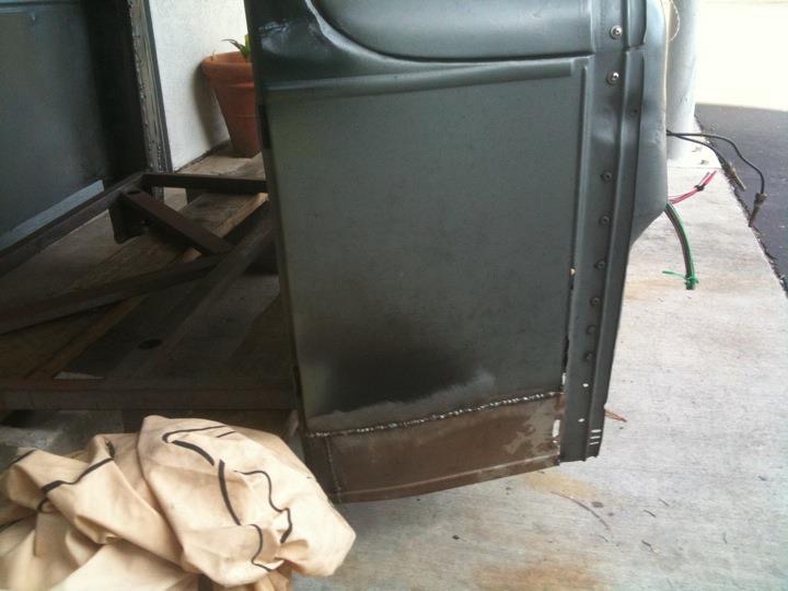

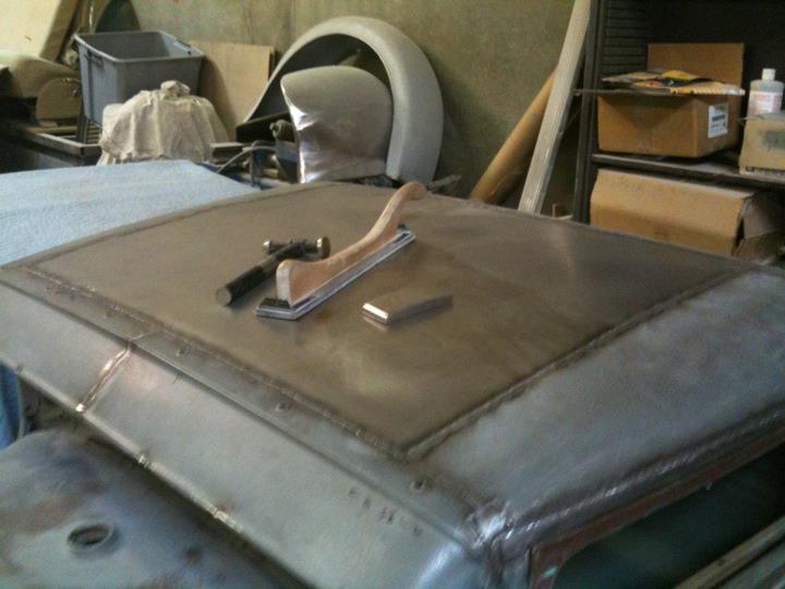

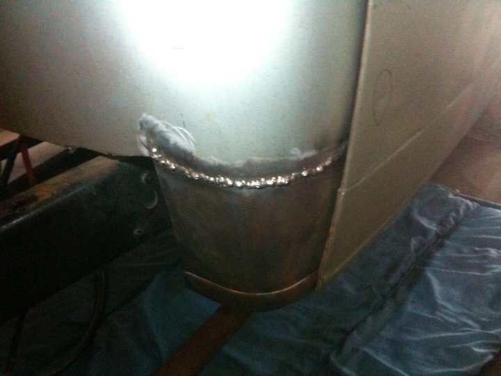

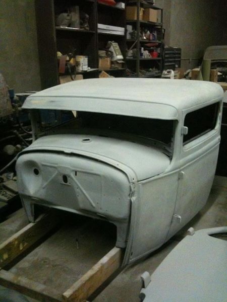

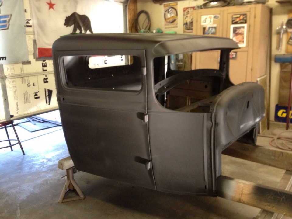

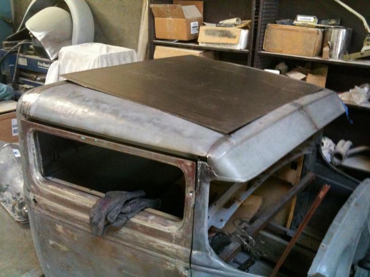

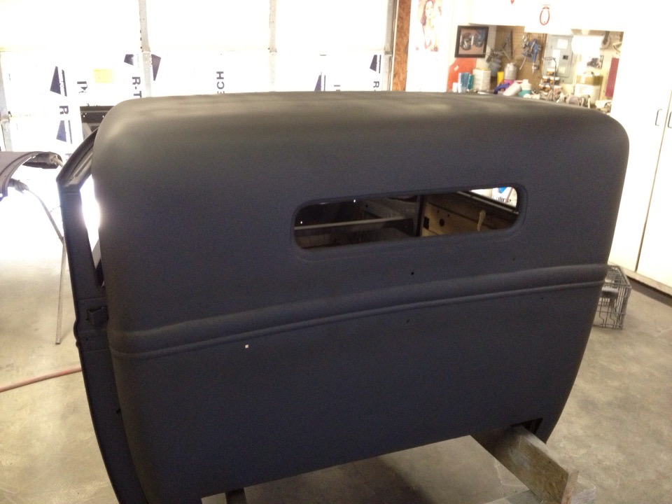

  27. Sadly this pick up had the one piece top and I goofed it pretty bad. Show this to the guy that posted about being afraid of ruining parts. I tried my hand at narrowing the entire roof because of the severe chop, the roof had a little muffin top due to the V shape of a Model A body. Sheet metal is not my friend.

    I remember that. It worked out well in the end.
