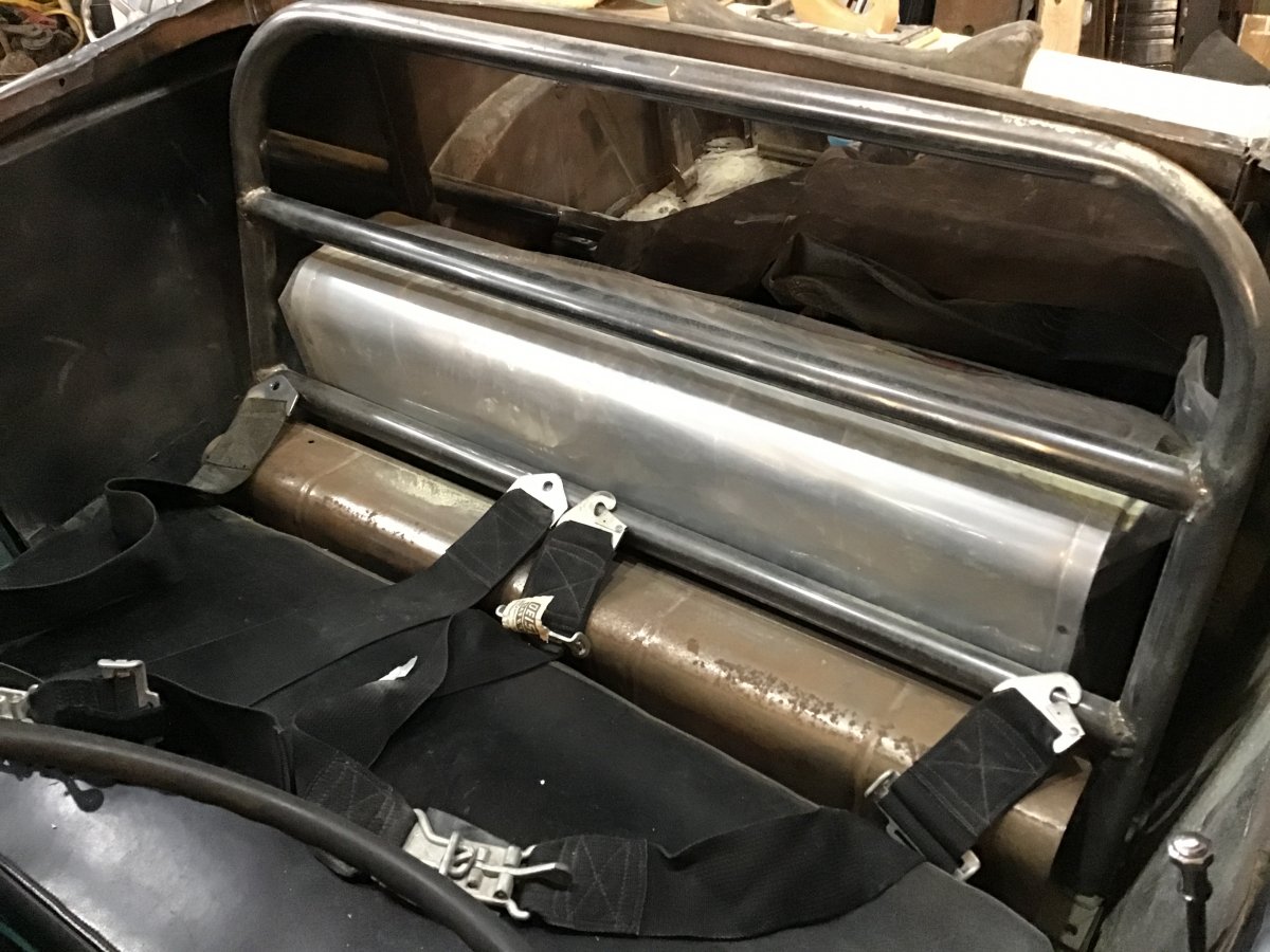

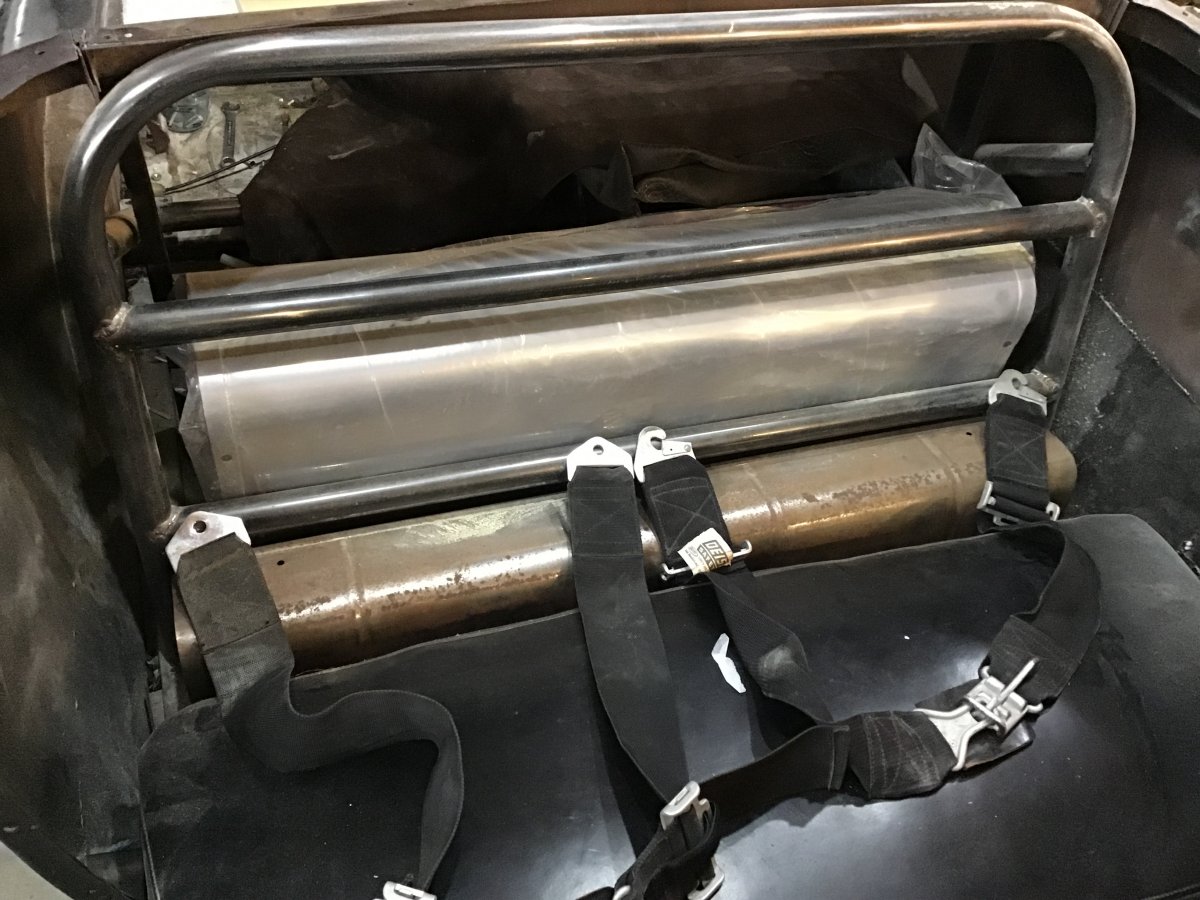

    B9F3B131-4335-4B90-8E75-5649103E8458.jpeg 8D4B0AE0-E6CC-48FC-BAF2-EB1E3CF862D4.jpeg DB9ACEB3-CC85-47A1-89F6-42032A7DDB43.jpeg Seatbelts are a necessity in the time we live in now, especially if you live in a populated area. This is what I did when I was building my 1929 roadster on original model a frame rails..
    I made a inner roll bar out of 1.5 DOM x .125 wall with a 4 point in the roadster for the seatbelts. It also served a few purposes one its backing for the seat and belts , mounting fuel tank and also battery box(antique Cooler) . This also gave the body support with a sheetmetal barrier between the seatback and trunk area. The rollbar front get mounted bolted thru the subrails to L bracket to frame and rear gets mounted to the frame thru the body at the rear legs to the rear crossmember .
    The seatbelts are old racecar deist and just lap belts and dont see why you couldn’t put a harness in. You can’t see the bar with the seat in it and deck lid closed..
    Just Gary, 38Chevy454 and pprather like this.
  20. manyolcars
    Joined: Mar 30, 2001
    Posts: 9,609
    manyolcars
    continentaljohn, thanks for the pictures. I have been thinking of a bar like that to attach the top of the belt.
    continentaljohn likes this.

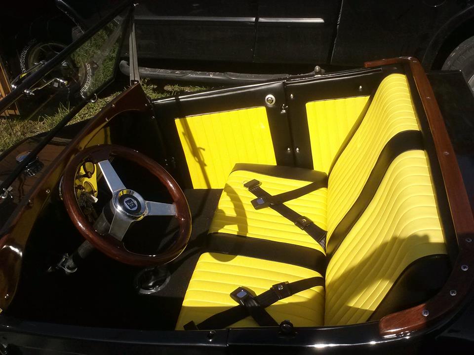

  27. dana barlow
    Joined: May 30, 2006
    Posts: 5,439
    dana barlow
    from Miami Fla.
