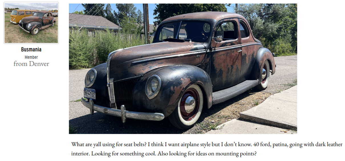

    IMG_8331.jpeg What are yall using for seat belts? I think I want airplane style but I don’t know. 40 ford, patina, going with dark leather interior. Looking for something cool. Also looking for ideas on mounting points?

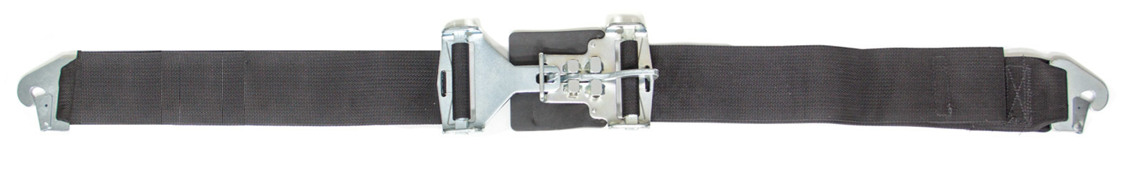

  2. 2devilles
    Joined: Jul 16, 2021
    Posts: 1,021
    2devilles
    I use the lift latch style and get them from seatbeltsplus. American made, and they'll send you free color samples so you get exactly what you want.

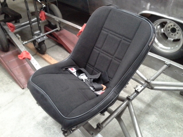

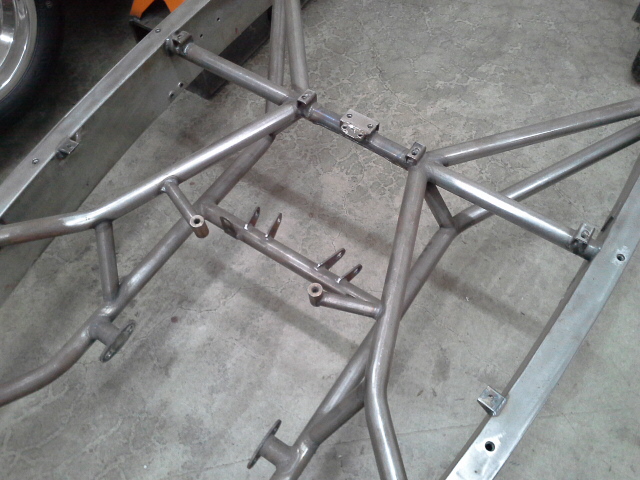

  6. DDDenny
    Posts: 23,425
    Danny
    Many years ago, there was a tragedy locally with a fibergl*** Cobra that was involved in a double fatality, the story I heard was they were both found still strapped in their seats outside of the car.
    This really had a bearing as to how I mounted my seats, directly to the frame.

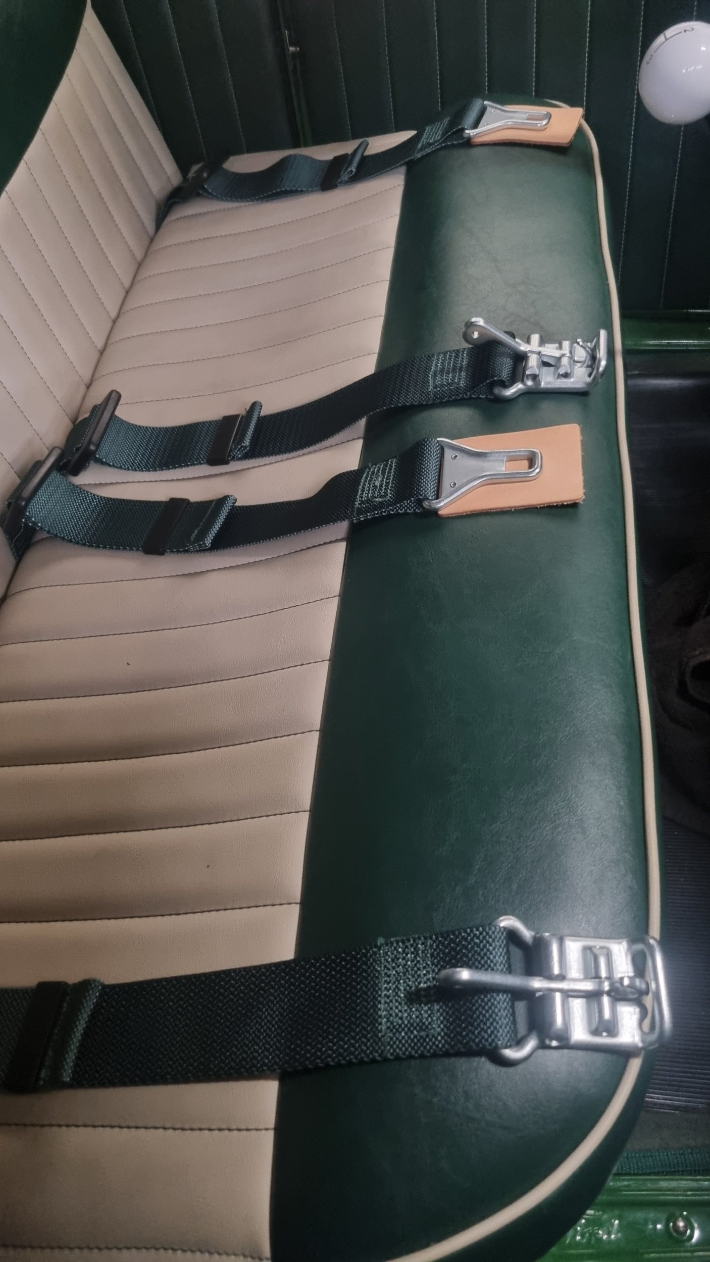

    Just put these in my RPU. Bolted to the steel floor via spreader plates.

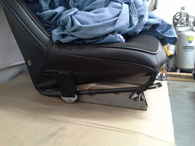

    Realized I left out this detail, my seat belts are anchored to the bucket seat risers.

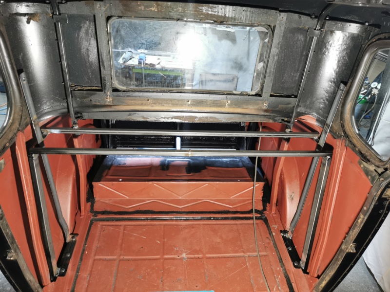

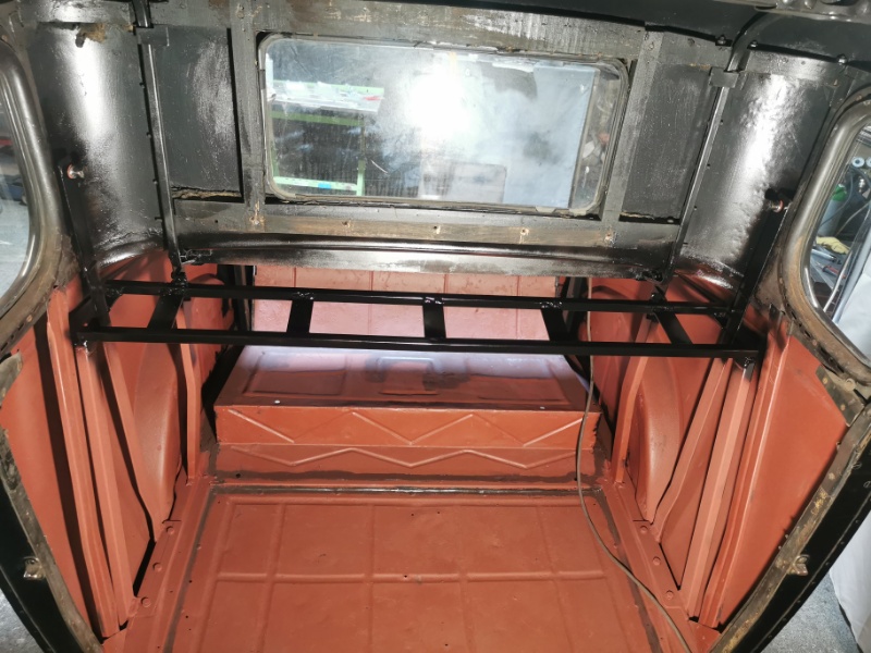

  25. Deutscher
    Joined: Nov 12, 2024
    Posts: 468
    Deutscher
    from Germany

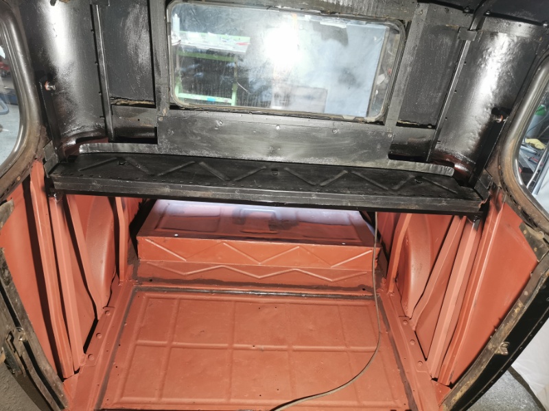

    I solved it this way on the coupe and placed my construction of angles and box profiles on the frame rails and attached a continuous plate from below with high-strength screws,
    inserted a stiffener under the parcel shelf so that the bracket cannot bend towards the middle, in addition the bracing was screwed to the body support and the flange, I hope that I never have to test this, there are simply too many imponderables.
    Greetings Harald

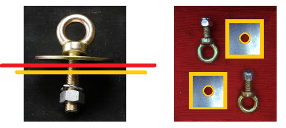

    The seat belt placing is up to the owner, as to comfort and fit. In the factory, the design team decided where they thought the seat belts should be placed. So, they did not take into account the millions of different drivers that would drive the factory placed installations. The idea of it can be adjusted was satisfactory.
    There is no specific place on your floorboard, then sit in it, have someone place the seat belt on and d**** it down to the floor in a relatively straight angle. Do it for both sides of the driver, as you sit in place.
    Now, mark the floor with the temporary hole from the chrome stanchion. Look around to see if there are any raised parts or double floor levels. If so, those double places are the strongest. But, since your car like most of our old hot rods did not have factory seat belts, then you have to select the place where it is comfortable for you.
    Once you drill the small hole, then place your washer and nut/bolt through. If there are any hinderances, selected another close by, flat location. Now, use the given flat washer from the dealer’s supplied parts. Get a wider but similar hole washer than the one provided. Use the factory provided washer as instructed. Then to finish the installation, use the wider plate under the floor for more security.
    The redline is the floorboard. The yellow line is a wider washer than provided or a simple separate, wide plate under the floorboard.
    upload_2024-11-23_3-3-15.png I was driving it home from a photo shoot one day and got caught in a CHP traffic road stop for vehicle inspections. Those kind that require random selection of cars to be pulled over to the side for a vehicle inspection. The CHP inspector thought the red Ford Sedan Delivery hot rod was going to be a gold mine of infractions. So, he started with the headlights and brake lights and worked his way inside.
    When he saw the seat belt installation, he went to the floor behind the seats. He gave his approval with flying colors when I explained how I installed the custom GM Chevy factory seat belts into the 40 Ford Sedan Delivery. Yes, it was a Chevy product in a Ford, but, they matched the upholstery perfectly. We placed a smooth, opaque custom piece over the hidden GM logo and it looked as if it was a custom product. Which it was!
    The CHP guy liked that I put in a second wider washer plate underneath when I explained the installation. Strength plus… YRMV
