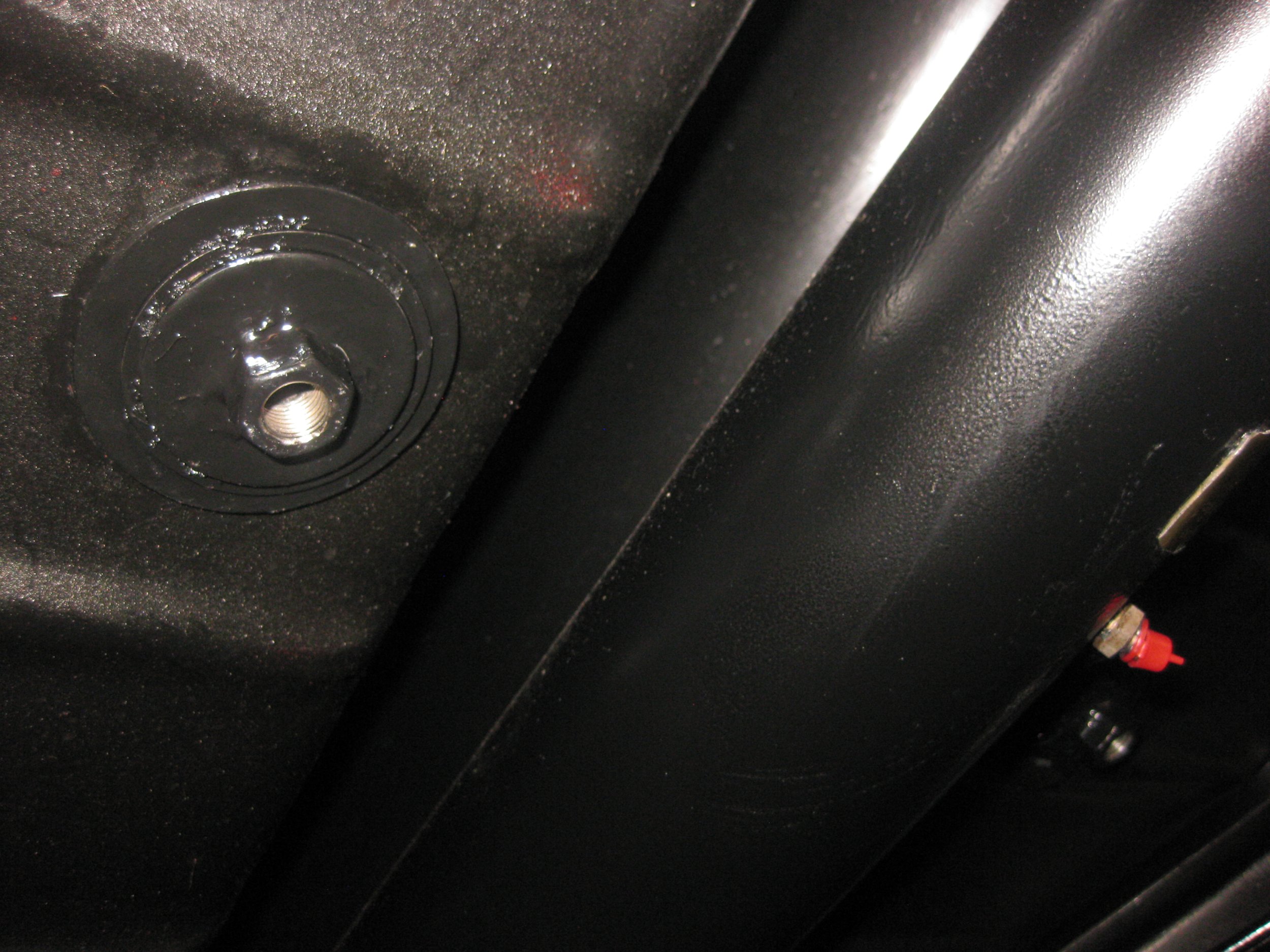

    I've installed lots of lap belts in cars over the years. I typically use the giant washers and shouldered bolts that they come with and *knock on wood* no car I've ever put them in has ever put them to the test. I never mount them to the frame, but I do like to drill the mount hole through a double layer of floor, like where a body brace meets the inner rocker or something. I like the idea of the weld-in plates that someone linked in this thread, haven't seen those before. I agree with the need to mount them so they actually have the correct angle for safety and comfort. If the belts are uncomfortable, the occupants will be less likely to wear them!

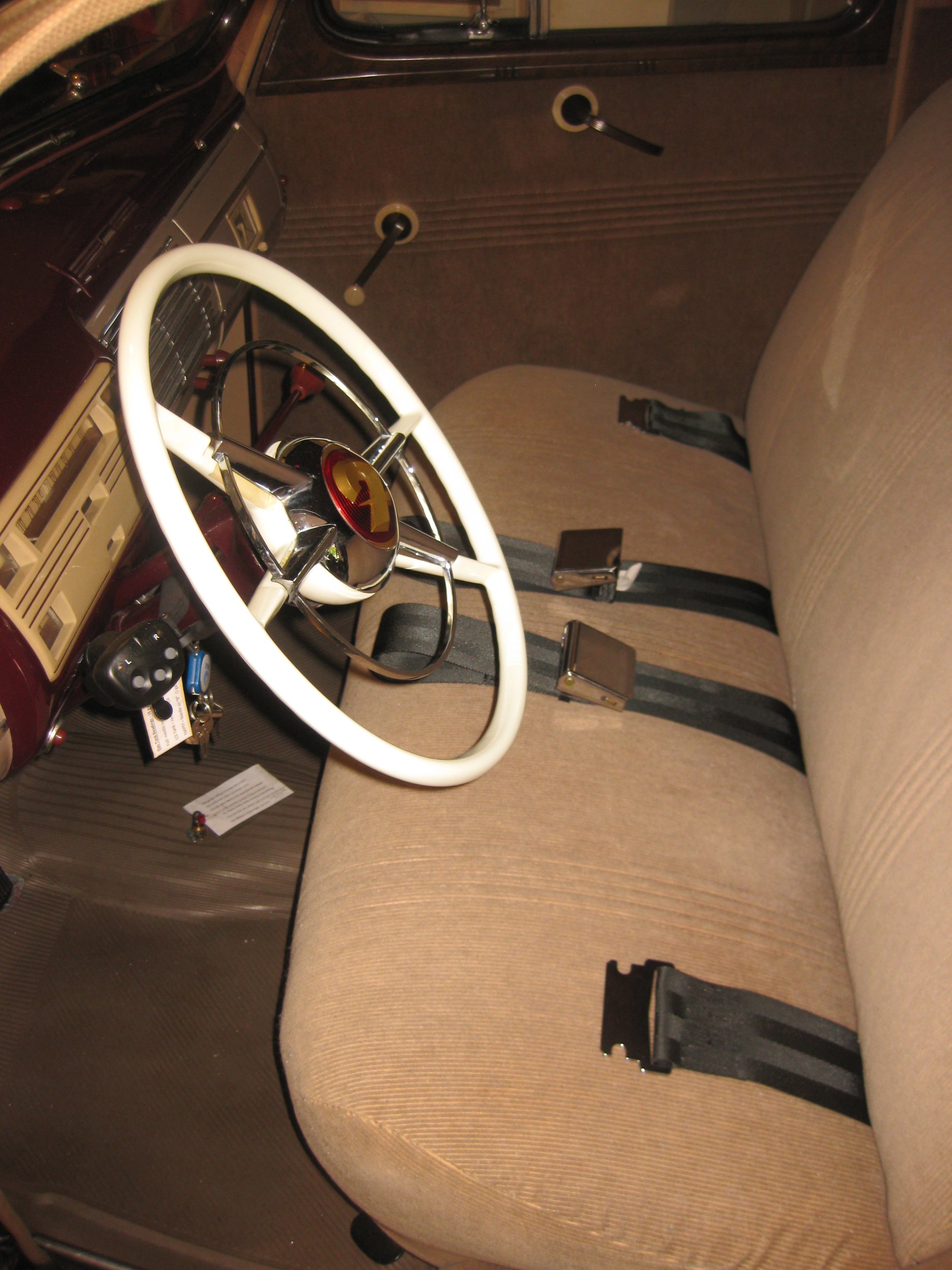

    Here's some photos of the 3 in. wide seat belts I installed in my '40 Ford. Be sure TO NOT accidently drill any holes into your frame or mufflers. DOUBLE CHECK MEASUREMENTS BEFORE YOU DRILL ANY HOLES to make sure your belts are long enough to accommodate the seat adjustment travel and still fit around the driver and p***enger. Best to buy longer belts. Do a mock up using clothes line taped to the car floor to estimate needed length. If you come up short, you can buy seat belt extenders. Keep your buckles to the center of the seat so they don't hang over the edge of the seat.

    Mounted to the floor (not the frame) with 1/2" grade 5 bolts and 3 inch reinforcement plates.
