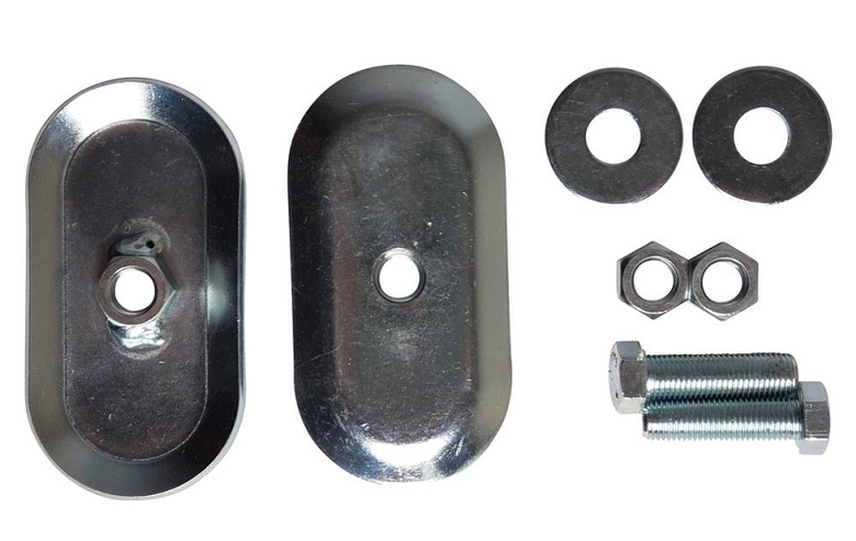

    Those ^^^^ would be the mounting plates I would use.
    But I would not spot weld them under the floor. I would clean the paint/ coatings of the floor and glue them with Bostik/Simson ISR 70-03 so the load is dissipated over a larger area than spot welds.
    This glue has a tensile strength of 246 psi and a shear strength of 362 psi
    To give you an example the mounting plates for my race car harness are 6.55 in2 so there is 1611 lbs tensile and 2311 lbs shear strength on the plates.
    So with extreme loads on these plates ^^^^ the floor will deform around them absorbing forces. And the glue won't rip the sheet metal like a weld would.
    But these plates ^^^ won't comply to our standards in NZ [the reason why they don't comply is they haven't been tested by the govt .... It's purely bureaucracy that's all]
    But they will p*** inspection at the track. The FIA require 42 cm2 minimum area of the plates [65mm x 65mm] or [2.56" x 2.56"]
    I'll crawl under my race car later and photograph my mounting plates [and edit this post]

    Karrynzl, Those seat belt mounting plates go under the floor pan. The bolt that holds the belt p***es through the floor pan, through the mounting plate, and threads into the nut on the bottom. The only reason they are spot welded to the floor pan is to simplify installing the seat belt bolts, and so the mounting brackets don't fall on the floor if the seat belt bolt is removed. The spot welds do not add any structural support to the mounting plates, beyond holding them in place until the bolt is installed and tightened. You may bond them if you wish, but its overkill for the intended purpose.
    Those seat belt mounting plates are only spot welded to the floor pans on all the of the Auto company's factory built vehicles that are sold in the USA. Actually only 4 spot welds within 1" of the bolt holes in the floor pan of those I have seen (which is thousands of them, I replaced rusted out floor pans at my welding shop for 28 years).
    Any crash stress to those mounting plates would be trying pull them up through the floor pan.
    Sharpone and 05snopro440 like this.

    When there is extreme loads on the seatbelt mounting bolt the hole will oval and rip as the floor deforms.
    4 tiny spot welds move the stressed area away from the load bearing weak point [the hole with a bolt]
    The glue puts the sheet metal surrounding the hole into shear loads when it deforms
    NZ [LTSA] have some pretty good guidelines to retro-fitting seatbelt anchor plates [and they have All been Load tested]
    A single plate underneath requires 2 x spot welds with an 8mm hole. 2 plates with the floor sandwiched between require 2 x 5mm monel rivets
    And some people should not go near sheet metal with a MIG welder. and any DIYer can use the glue
    Here is the B-pillar anchor plates on our 57 Chevy [there is no room for Doubler Plates]
