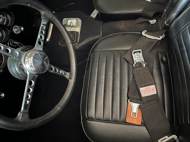

    IMG_1930.jpeg IMG_1932.jpeg Just installed the 32 seat with belts today .

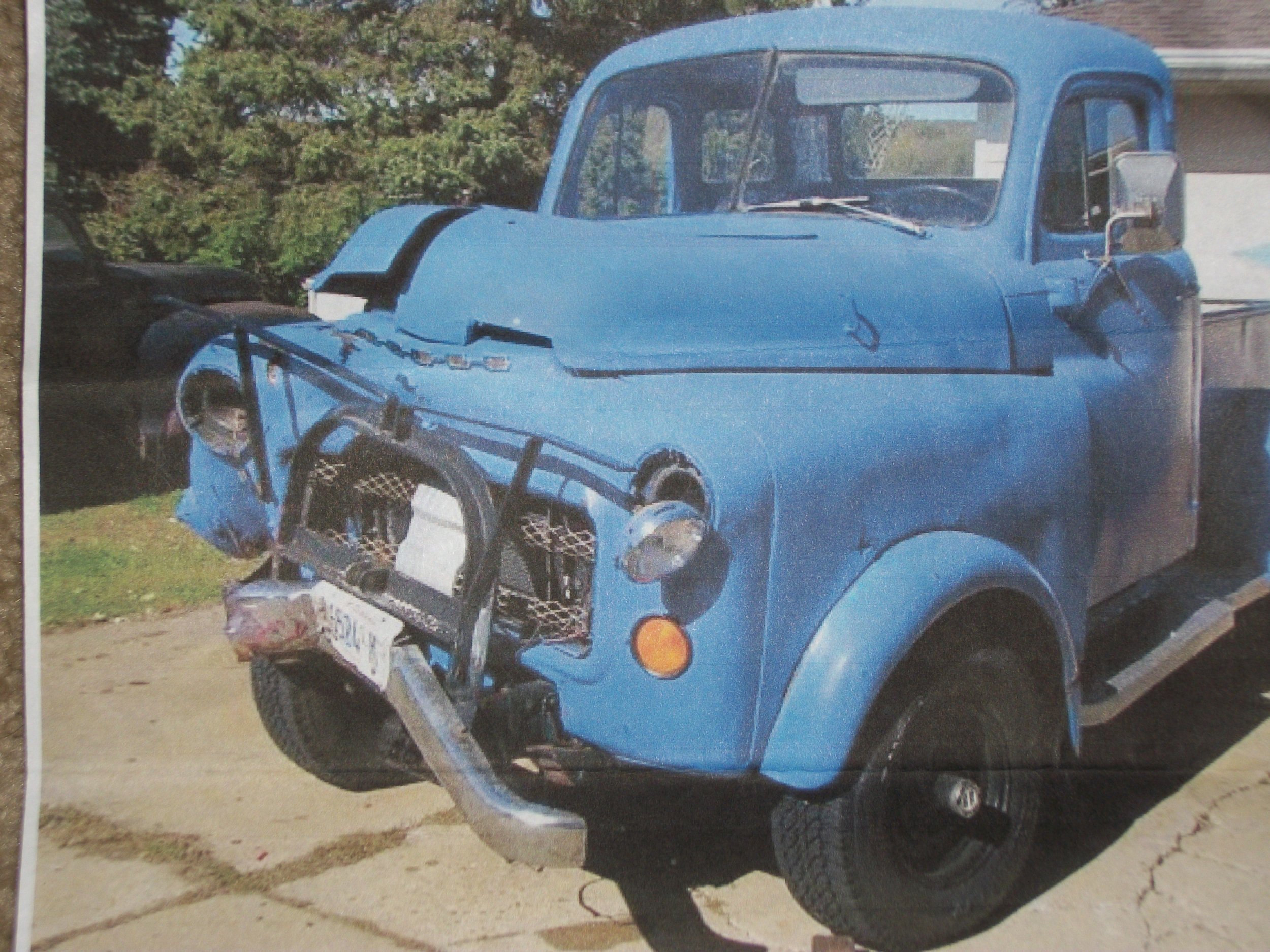

    Probably more often then you might think! The body and frame don't even have to separate, all the need to do is move different distances a couple inches to hurt you badly.
    Contrary to popular belief, "body mounts" are not a solid connection between the body and the frame. The purpose of a "body mount" is to allow some movement between the body and the frame, so damage to the body and the frame doesn't occur when the vehicle goes through changes in elevations in the road surface (you know, that dip between the street and your driveway that you always slow way down for?) Every time your car hits a bump in the road, the body and frame shift, that means, the body and the frame are nearly always moving in different directions.
    Nearly all of those body mount connection points involve rubber being sandwiched between the body and the frame. The rubber allows more movement and more control over that movement. The rubber also eliminates the squeaking and squawking two pieces of metal bolted together would have as they moved against each other. To sandwich rubber between the body and the frame requires a hole in the body (nearly always reinforced), a chunk of rubber with a hole in the center, the frame with a hole in it (often reinforced), and most of the time a second piece of rubber with a hole in it under the frame. All that is tied together with a bolt (often about 3/8" to a 1/2" in diameter and often 4" to 5" long). That bolt often has over sized washers where the rubber meets either end of the bolt, and of course a nut.
    Since the most of the body mount is under the floor and attached to the frame, they are always exposed to dirt, salt, water and anything else the bottom of the car is exposed to. The biggest problem is, since the body and frame are constantly moving in different directions, that water and dirt collect around the rubber and start acting like sand paper. They wear against the metal on both sides of the rubber, and on the bolt p***ing through the rubber's center hole. The metal (floor, frame and the sides of the bolt) gets thinner and becomes weak.
    Add a bit of rust surrounding the rubber part of a body mount, either on the frame or on the body (the metal rusts out around the rubber mount until there is nothing left and the rubber simply can be pulled through the rubber sized hole in the frame with your hand), or a broken or rusted away bolt (the rubber part of the mount will wear a bolt down to less then an 1/8" thick or completely separate it into two pieces so the bottom part can just fall out) will allow a car body to separate from the frame in a very minor accident.
    Most car bodies are only attached to the frame at 4 or at most 6 locations on the p***enger part of the frame. If 2 of those mounts have weakened body mounts, and the front bumper that is directly attached to the frame hits something and stops the frame from moving forward, but the body, only held on to the frame by the remaining good body mounts will continue to move until the firewall hits something solid enough to stop the body movement, and if the seat belts are attached to the frame, the belts also stop moving. If the seat is attached to the body, it (and you) keeps moving forward until the body stops. Can you see a problem here? If the car body only moved forward 3", do you have that much slack in the belts (and I would hope the belts were tighter then that), can you feel the belts cutting into you?
    If the belts are attached to be seat, or the car body, the frame can do whatever it wants, you are attached to the car body and are going with it.
    I have replaced hundreds of bad body mounts, and have replaced the metal around twice as many body mounts then that. Repairing bad body mounts and the area surrounding metal the mounts attach to, was probably 1/3 of the work I did as a welding shop owner for 30 years.

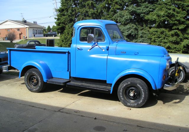

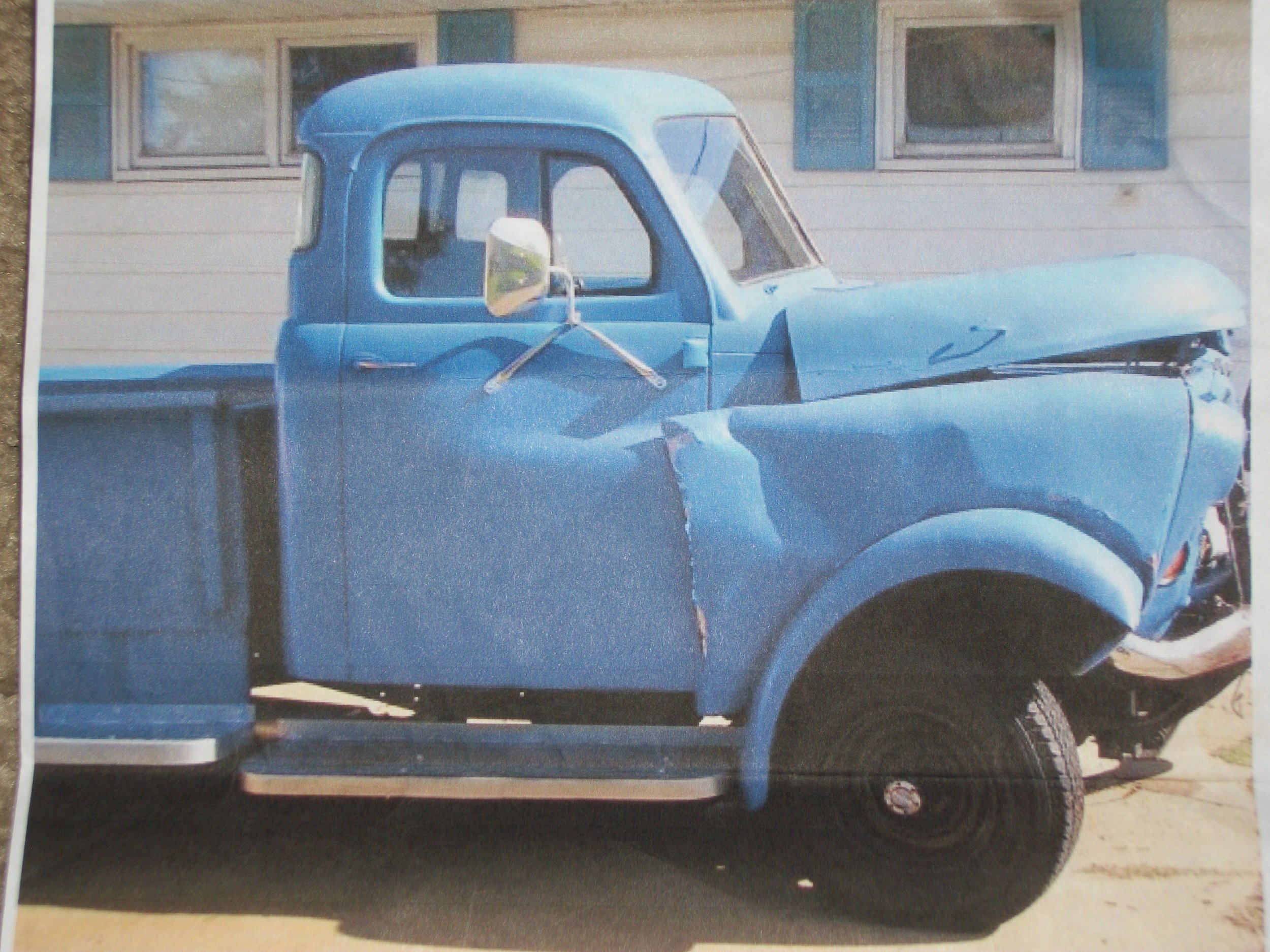

    I'm posting 3 pictures, a before, and an after and a front view capturing the crash damage. My truck, back in 2011. I was 4 blocks from home, the crash was a 30 mph head on crash. The cab mounts did not fail. See how far back the front tire in the the crushed fender opening. The entire right frame rail folded in 4 places, all the way to the rear axle. The right side rear axle was 3" farther back then the left side. Under the truck door you can see the frame bent downward, that would have nee about where the seat belt would have attached to the frame!! Would you rather be seat belted to the cab with the seat or to the frame? This one didn't even separate! 100_1145.JPG

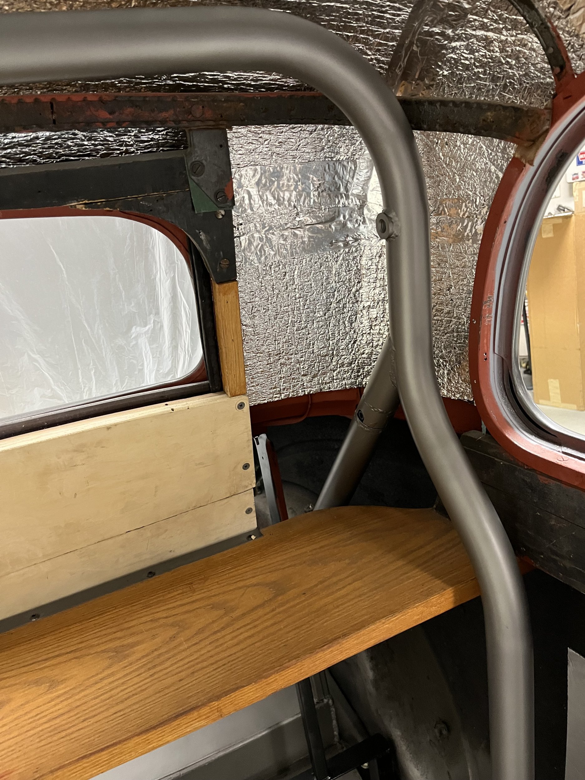

    Installed a roll bar for the sole purpose of having an anchor point for a three point harness.

    this is my plan for my 34 pickup and the roll bar will be bolted to the frame. Should the roll bar only be bolted to the floor?
    Sharpone likes this.
  25. gene-koning
    Joined: Oct 28, 2016
    Posts: 6,896
    gene-koning
    Technically, if the roll bar is connected to the frame, the seats should be connected to the roll bar and frame.
    Probably splitting hairs here, if the roll bar is bolted to the frame right next to the seat that is bolted to the floor, the odds are better that the floor will remain at the same location simply because the roll bar bolts will also p*** through the floor near by. But, the roll bar is still only relying on the bolts to hold it to the frame. If your going through the effort to bolt the roll bar to the frame, you might as well put forth the effort to attach the seat brackets to the roll bar as well. An extra piece of tubing attached to the roll bar for the seat to bolt to isn't that hard to do and would eliminate any question. The ultimate goal is to maintain the spacing between the belts and the driver so the tension on the belts doesn't change when the belts are needed the most.
    If the roll bar is only there to mount the belts to, and the seat is bolted to the floor, bolt the roll bar to the floor pan as well.
    I want to have the seat I'm sitting on attached to what ever the seat belts are attached to. If that object moves, I want my **** to move with the belts. I would rather not be killed by a roll bar that moved with the frame, if the frame moves in a different direction from the floor the seat was bolted to.
    I'm just a welder guy, I'll do what I think is correct, you do what you think is correct, and lets hope neither of us ever needs to find out if we were correct.

    The truck hit an 80s Chrysler FWD Lebaron. The lady driver made a left turn about 20' in front of me. I got my foot off the gas pedal, but never made it to the brake pedal before impact. I was going 30 mph, she was going almost as fast. She was in a line of cars and simply turned in front of me. Her car bounced backwards from the point of impact nearly 10', my 4850lbs 4x4 truck was stopped at the point of impact.
    That 50 cab and sheet metal was bolted to an 80 Dodge 1/2 ton 4x4 truck ch***is and that frame probably took the impact much better then the much lighter 50 frame would have done. The frame was twisted enough the frame rail smashed the 360 SB Mopar oil filter on the side of the block and busted a chunk out of the cast iron transfer case. Its hard to see in the crashed side view, but that 3/8" thick main leaf on the right front is bent up at about a 45 degree angle. The truck had a Meyer's snow plow mount bolted to the frame, that snow plow bracket is broken in 4 places, and behind the front bumper is a 3/8" thick 2.5" x 2.5" angle with the "V" pointing forward (the part of the snow plow brackets the snow blade mounts to, very robust stuff), that has a 4" bow towards the rear, in it. This truck was a heavy duty, very solid, truck that had spent the 12 years before it plowing snow and pulling a car trailer. The entire truck was rebuilt about a year before the crash.
    Her air bags saved her ****, I got 11 s***ches on my forehead and a sprained thumb on my right hand. My truck was equipped with lap belts, but I didn't wear them much, I was concerned the lap belt would put my face into the middle of the windshield (I would have been correct). Without the lap belt on, my forehead hit the header above the windshield. I had my thumb hooked around the steering wheel and it pulled the column with me.
    Everything I have built since the crash has had lap and shoulder belts and the vehicle doesn't move unless everyone in it is buckled up.

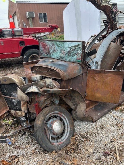

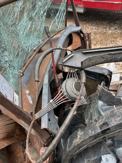

    I've never been a "seat belts guy" but about a month ago a good friend of mine was hit by a pickup truck head on while driving the 29 Roadster that he built and he broke both legs in multiple places and an arm and various other
    injuries and that car didn't have seat belts.. Most of my cars have seatbelts and now I'm going to start using them.
