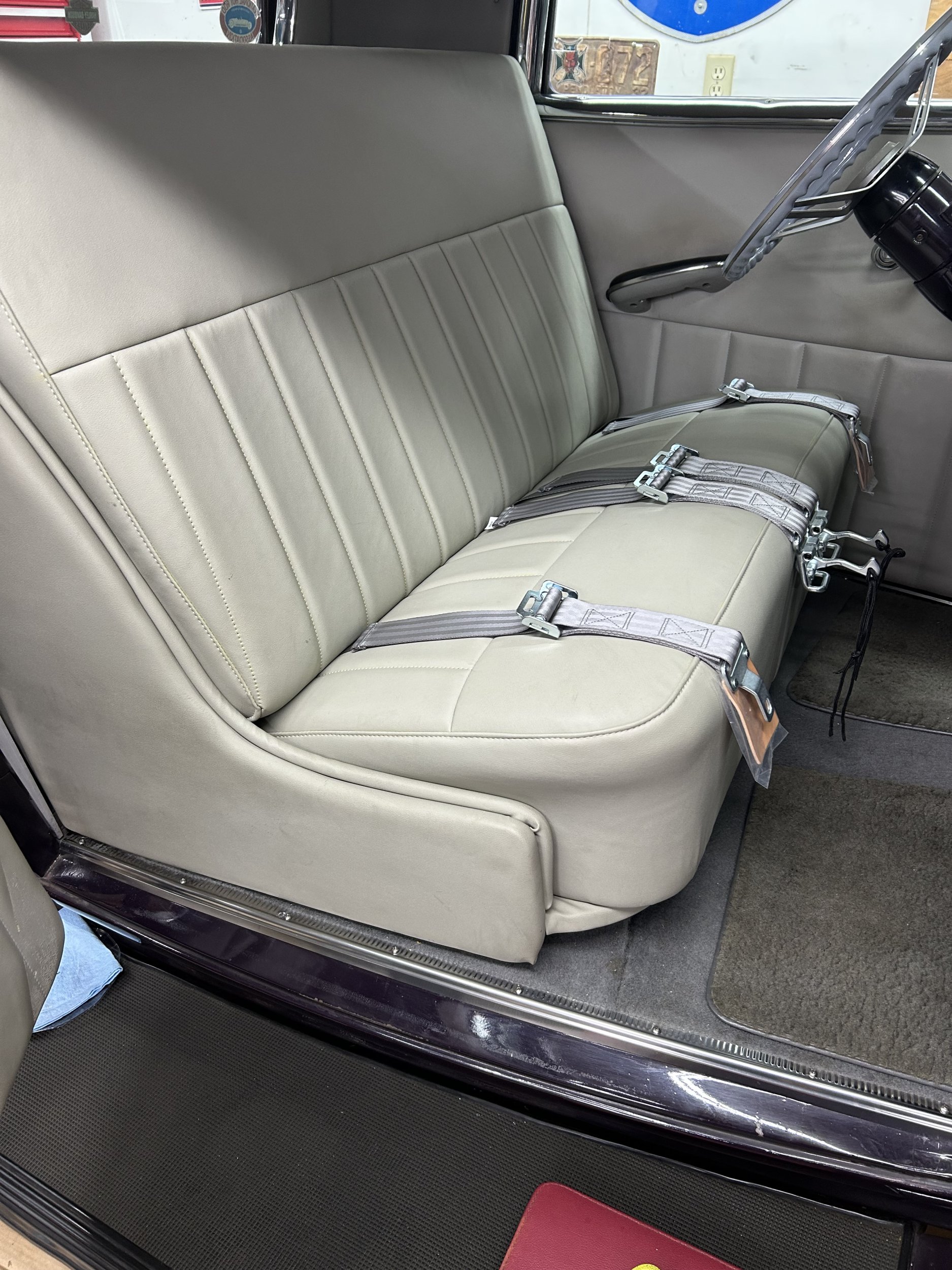

    IMG_2001.jpeg New seat and “safety belts “ all finished up

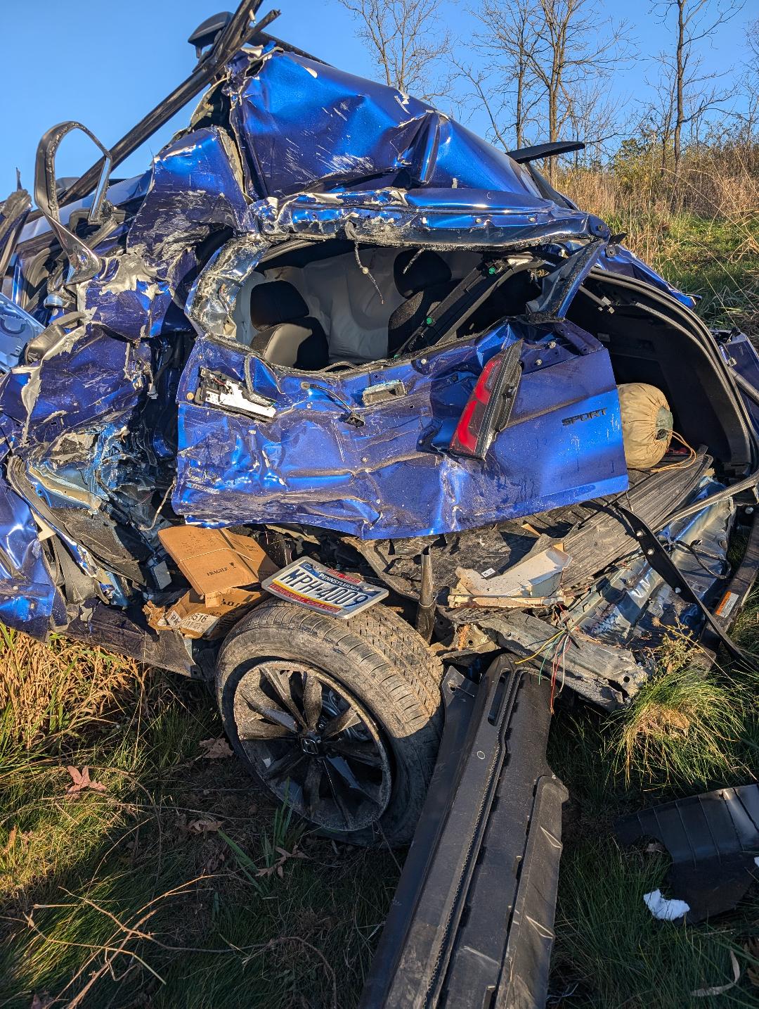

    Hit from behind in my 1 month old car. Kind of glad I was wearing a seat belt so I am here to write this. upload_2025-3-22_19-42-51.jpeg

    Geez man, glad you were able to get out of that one to tell the tale.
    I have got a couple of questions, though.
    Do you think the sleeping bag absorbed some of the energy, helping to save your ***???
    .... and....
    I know the badge says "SPORT", but did it really do 4009 mph???
    5window likes this.

    My wife was in the p***enger seat and just walked away. Must have been the sleeping bag.
