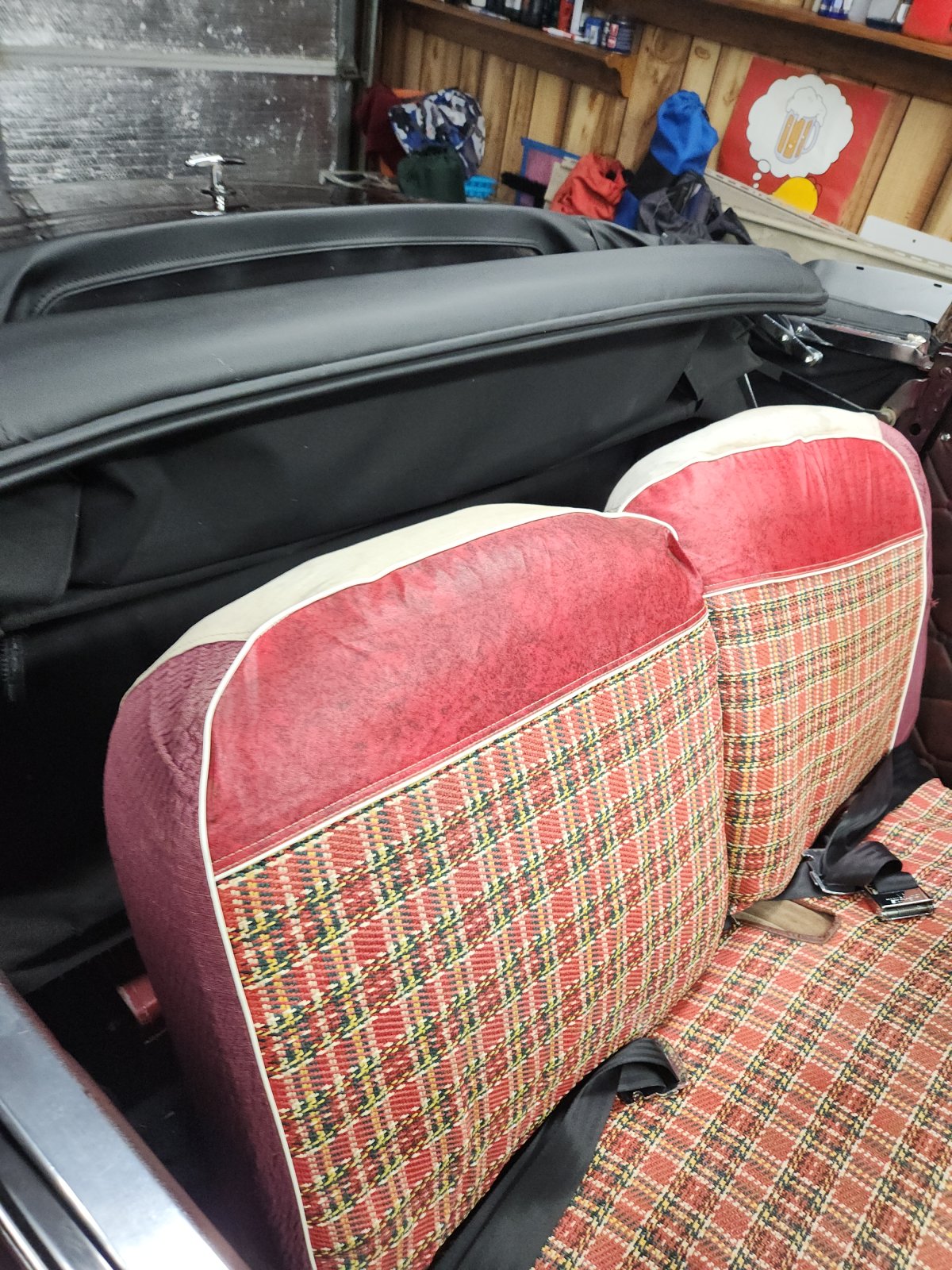

    So I have vintage seat covers bought from here that are faded from the sun, is there a product that I can use to dye or paint them?

    Duplicolor and Rustoleum both sell vinyl spray dye that works well, holds up, and wont rub off IF you clean and prep the seats before spraying. In the case of these seats you'll lose the pattern since the dye will make it all one color. But you can mask off areas and make them a two tone.
    I've cleaned and dyed many seats and after cleaning well I like to scuff the smooth vinyl with a Scotchbrite pad and wipe one last time before spraying. I've got a pair of dark gray buckets in my 12 year old build that I spray dyed black, and they still look like new.

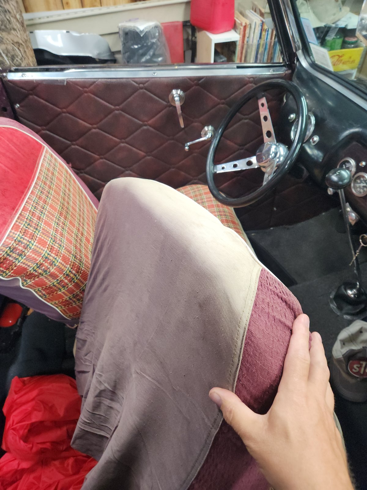

    Sorry guys, just the back of the covers the front are OK for me

    What are those backs made from? Is it fabric, or vinyl? That'll make a big difference. I can't tell from the pics.

    I don’t know what brand it was it could have been SEM but someone had a carpet/fabric dye.
    I think you’d be better off taking them to an upholstery shop and having a panel replaced.

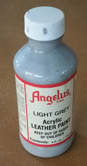

    upload_2024-7-25_1-57-8.png A local shoe repair place had the best explanation on vinyl and leather seating surfaces. He comes from his history in leather shoe repair and custom building of shoes. Those old guys knew their stuff and now, are history in themselves. The little store closed with the remodeling of the whole shopping center. His point of cracking leather was well taken. The solution was to use something that was going to soak into the leather surfaces. (To some extent, into the vinyl.) his suggestion was to use a bottle of grey leather paint, undiluted.
    With a small amount used at first, the paint soaks into the roughed up leather and absorbs into the exposed surface. The color can be diluted to match as close as possible, any color. His grey bottle that I bought did not need any dilution as it covered the slightly worn areas of the corner lip where the “****s” slide over to get comfortable in the seat.
    After all of these years and some miles on long distance driving car, the leather seats that were slightly worn, now look like a smooth surface. They are not new, but blended in like a well worn t-shirt. No breaks or cracks in the painted surfaces are evident.
    I needed to cover a couple of scratches on some grey leather seats. I went to the leather supplies store and then a shoe repair shop. I picked up this bottle of actual, grey leather paint. The paint did not dry hard like most paints. It had some flexibility and covered the scratches as well as can be.
    The leather store said they would have to sand, buff, re-apply the leather dye, and do a final buff of the leather to make it look like the original. Of course, the leather fix-it charges, were quite high and was not worth the effort. The dis***embly, transportation and being without seating for two weeks were just a little too much.

    You can dye that fabric, but if it's been in the sun long enough to discolor it, it's probably going to come apart once you start sitting on it regularly. I have used those same style slip covers and they weren't very robust when they were new, they certainly don't get any better with age. I think it's a linen fabric and very thin.
    I'm with OldIron 440 on this one, I think you'd be best off to sew in new replacement fabric if you want it to be clean and fresh looking, it'll last longer, too. You could probably sew that in on a good standard home sewing machine if you don't have an industrial, the vinyl on there is not very thick.
