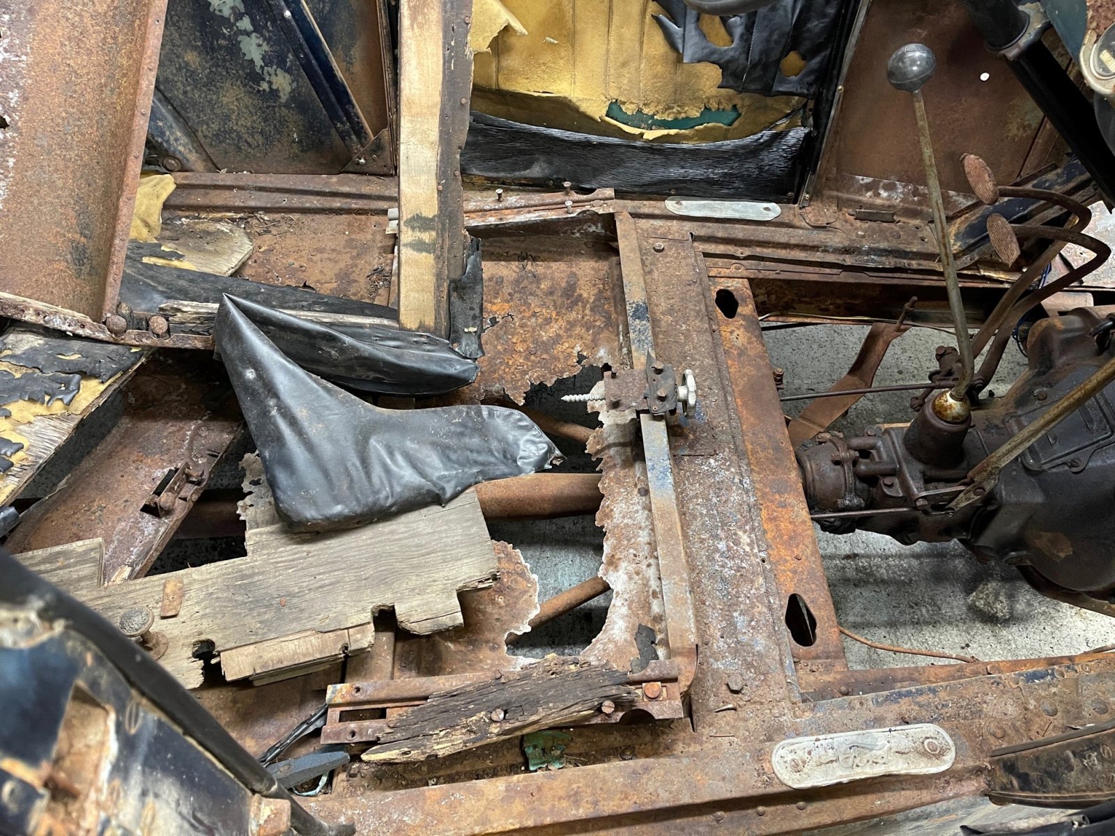

    I've done it about 5 times. So here is a general run down.
    So you have to remove the seat completely for starters. Remove Package tray.
    Note the step up for the foot pad for the rumble seat will need to be flattened out, so no step up behind the rear of the seat if there is one.
    The riser that is welded and rivited to floor needs to be drilled and removed in one piece. You will need to add a cross piece between the subrail about 2" back. This I suggest a piece of 1/2" x 2" rect tubing or something like that, even a small c channel but needs to be about 16 gauge thickness. Long enough to go from side to side, joining the subrails on the sides.
    Side note: You will be amazed what 2" will gain you, if you have over 30" inseam I suggest 3 to 4"
    I would tack the cross piece in, tack the riser to it, and then put the seat in to see how that works, Test fit your seat and see if you have enough.
    Once you are there, weld the cross piece in, re weld the riser to the cross piece, and you only have to make two small pieces for the rear of the riser to fit on the subrail again. If done right and you keep everything straight and true, the adjustable seat base will still work for future drivers of shorter statue.
    Just a pic of my coupe before I ripped it out completely and put a mini van seat in it. Note, I didnt have anything other than the riser.

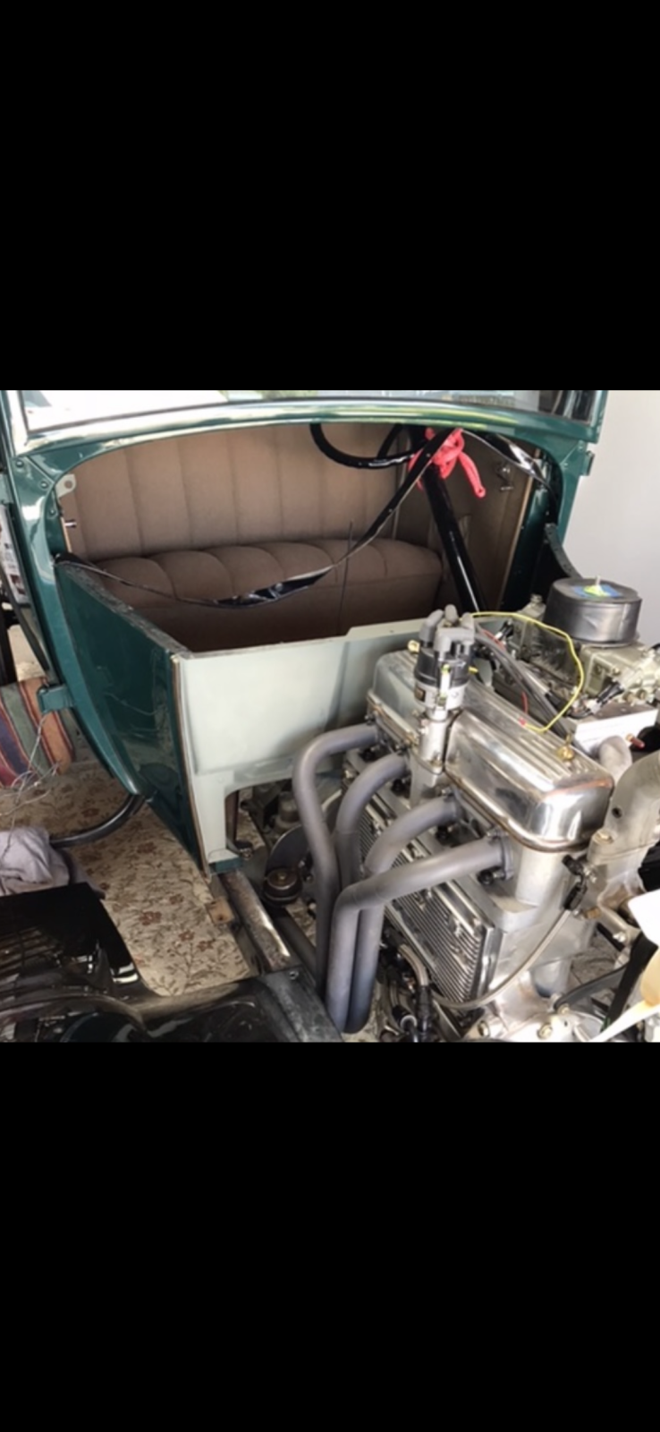

  12. hardtimesainit
    Joined: Jan 24, 2009
    Posts: 626
    hardtimesainit

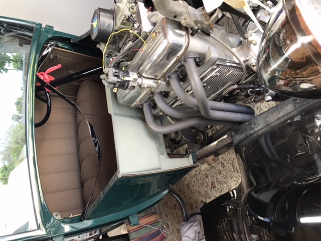

  13. hardtimesainit
    Posts: 626
    hardtimesainit

  15. hardtimesainit
    Posts: 626
    hardtimesainit
    Thanks Mr Stubbs !
    I was just loaded down with hardware, so can’t do this mod myself. I’ll show your input to a guy who can do !
    As usual, you HAMB guys are the BEST !!
    You may notice an auto trans (slant 6) behind the B type engine. It was auto or maybe no drive at all… bummer but still trying.
    Rick
