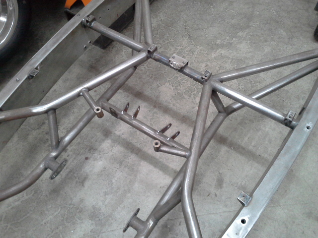

    No wood floor but my car has a Wescott body and as well braced as they are with steel, there really isn't anything to anchor belts too. I chose to attatch my belt anchors to the steel seat risers which are welded to the tubular seat frames.
    As you can tell by my (bucket) seat mounts, all eight are integrated into the frame, this was a major concern of mine.
    missysdad1 and evobuilder like this.

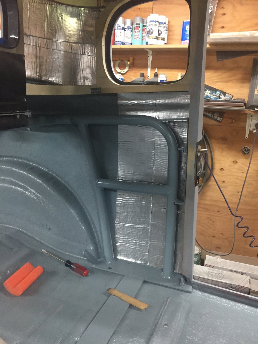

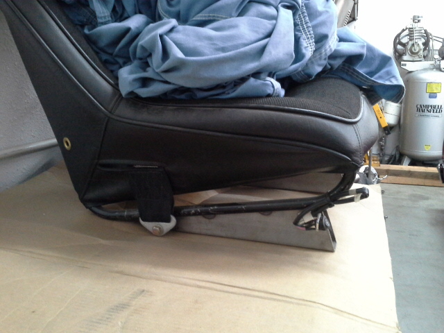

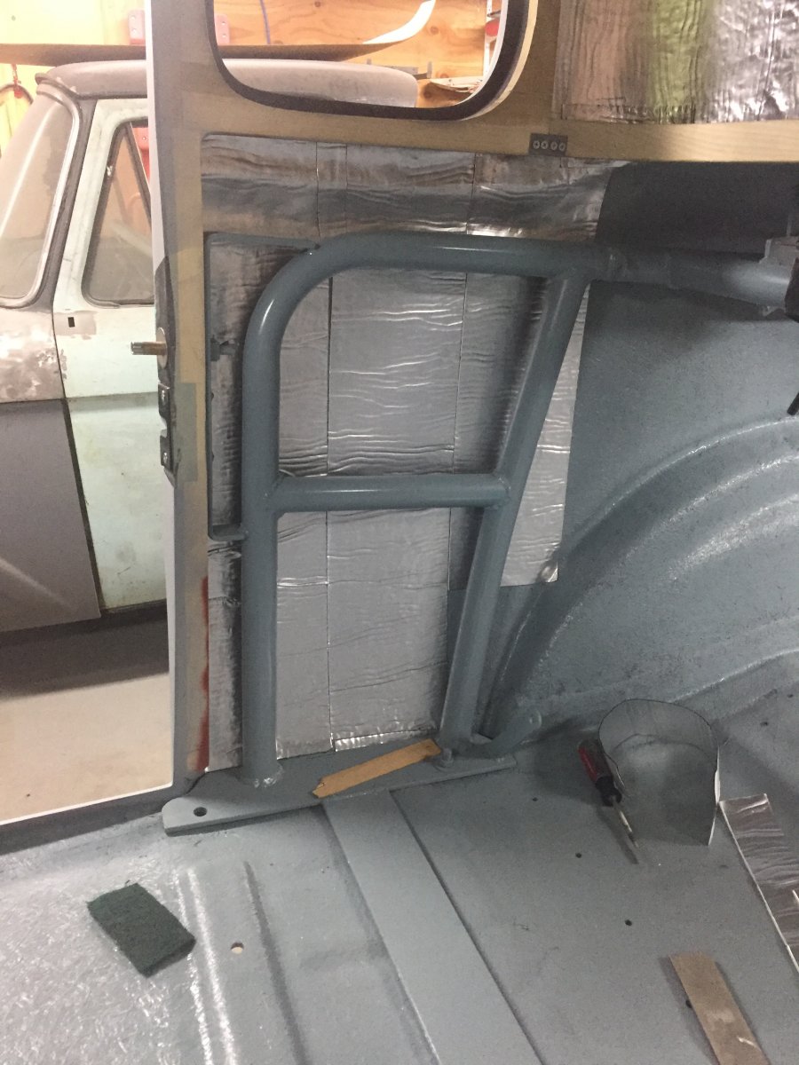

    My car has a "half cage" from the beltline down. Part of that structure is a steel plate running from left to right tying the 2 sides together. I drilled thru that plate then used the large, thick washers that came with my seatbelt kit. Worked great.
    SPark
    alfin32, evobuilder and kadillackid like this.
