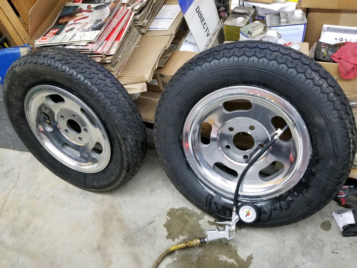

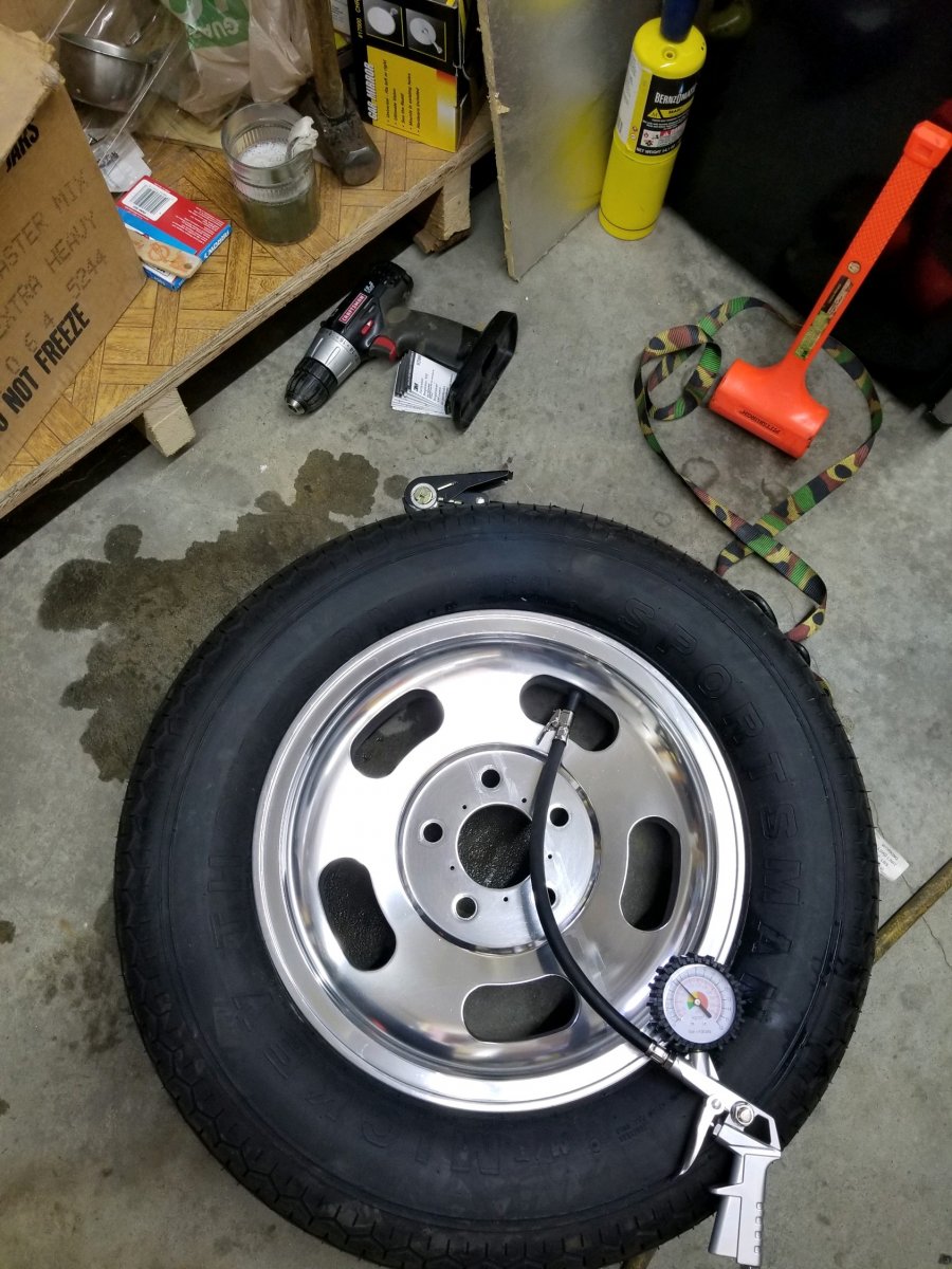

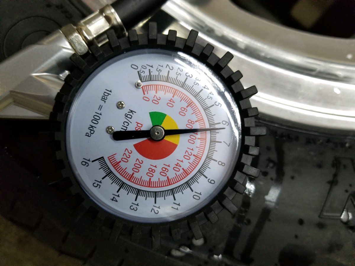

    I've all but gave up on these ****ers, 15 x 3.5's that I've had problems with in the past with a VW bug tire, but eventually got.
    Just can't get the last 12 inches of the tire to seat and pop, used dish soap, used a strap, had 90 psi in it, used go jo hand cleaner, bounced it, beat it with the dead blow, nothing freaking works.
    I'm ready to polish the inside of the rim to help it slide better.

    Try some of the water based stuff that is used for bedroom antics. Being water based it doesn't cause any 'side effects'. I use it for o-ring instillation.

    you have the mapp gas right there..... get a lighter!
    swade41 likes this.
