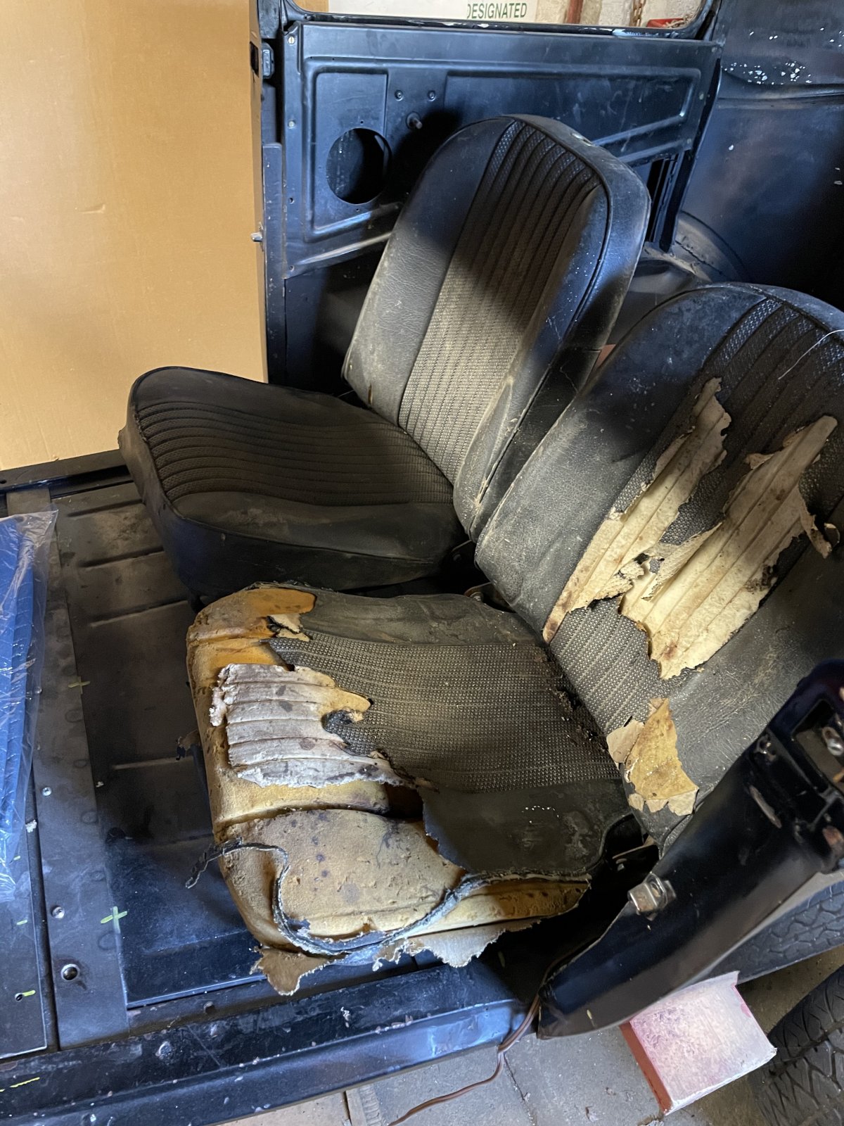

  1. Bakofly
    Joined: Sep 2, 2021
    Posts: 21
    Bakofly
    Hey guys, I’m new to this site so please excuse me if my questions seem off center. I just purchased a 31 Ford model A. 350 chev. My question. The top has been chopped 2.5 in. I keep banging my head on ceiling when hitting bumps. What do you guys recommend for seats to get more head room. The seats in it now R from a 67 capri bucket type. Thanks for suggestions.

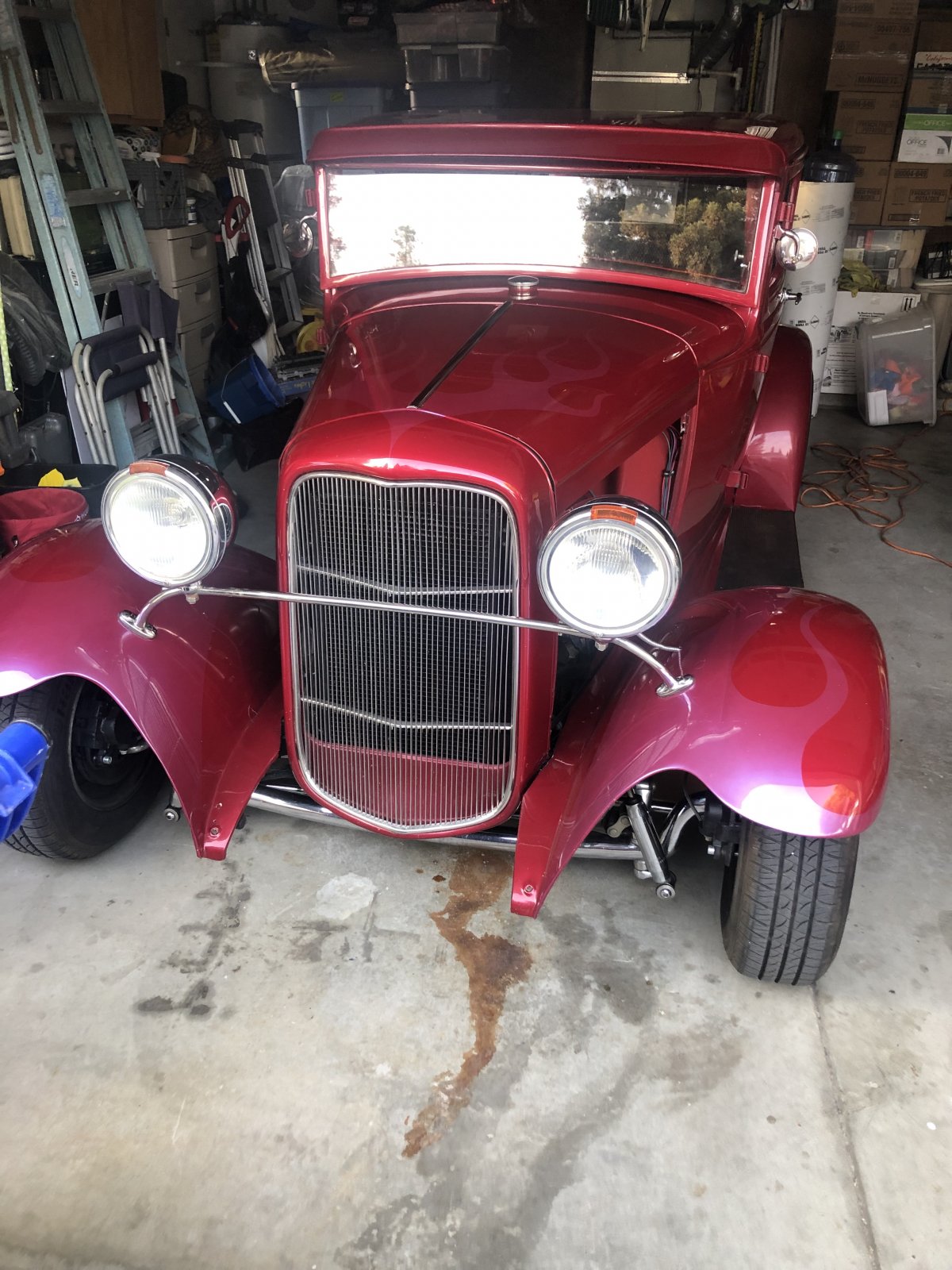

  12. Bakofly
    Joined: Sep 2, 2021
    Posts: 21
    Bakofly
  13. Bakofly
    Joined: Sep 2, 2021
    Posts: 21
    Bakofly
    Thanks for all the replies. I am trying to find some Mini Cooper seats or the dodge caravan seat
    Stogy likes this.
  14. Bakofly
    Joined: Sep 2, 2021
    Posts: 21
    Bakofly
    Pics posted.
    Stogy likes this.

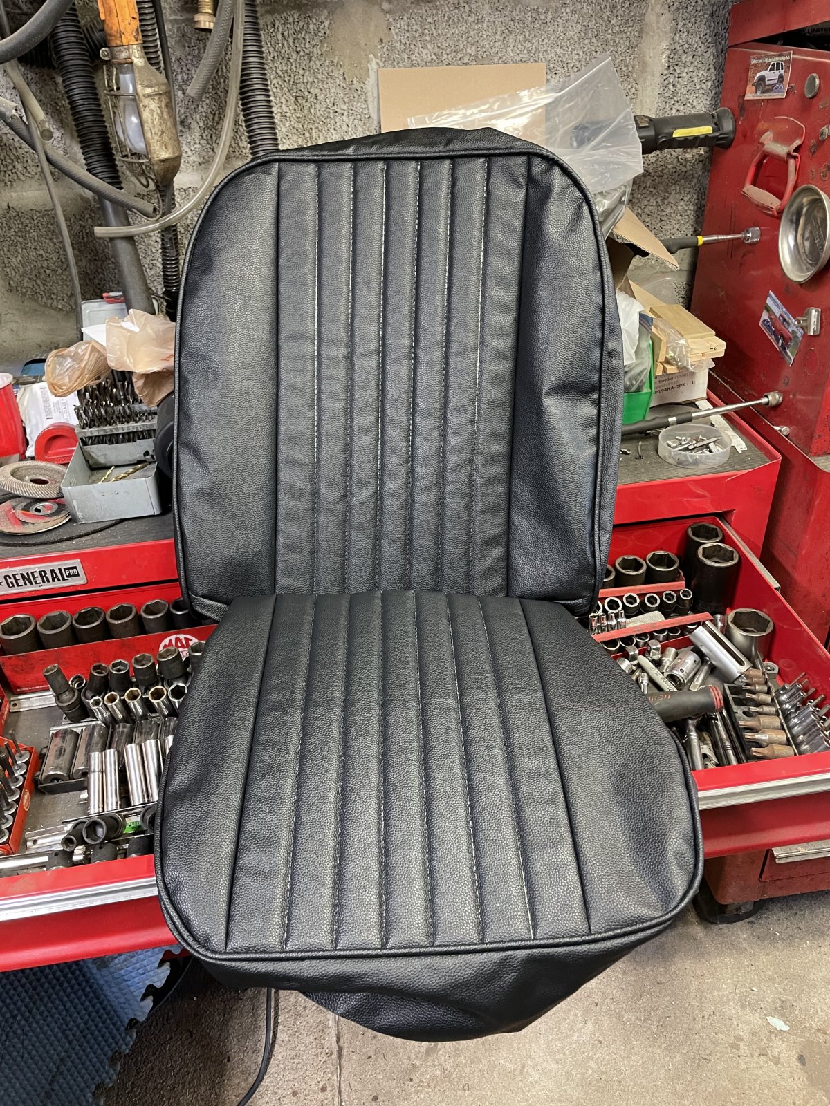

  21. ahshoe
    Joined: Sep 12, 2012
    Posts: 1,055
    ahshoe
    97DCD240-1D1F-4623-A94A-60339AD30496.jpeg Mini Cooper seats are too wide for a 31. Ask me how I know. However I did use them in my 51 Shoebox
    Bakofly likes this.

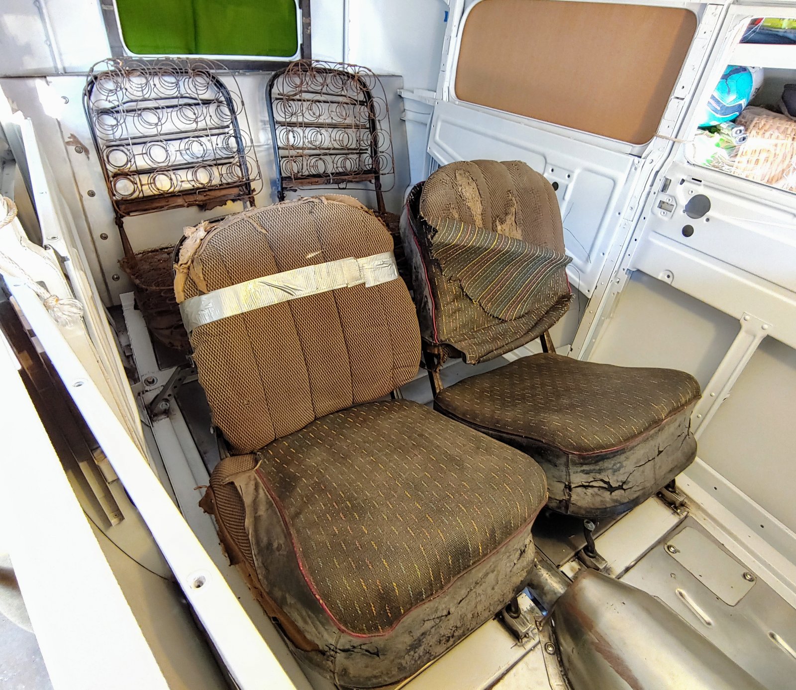

    There's nothing more traditional than stock A seats. They fit really well. I have four in my sedan; it's angle chopped 3.5" in front & 2.5" in back. I'm 6'2" & there's plenty of headroom.:):cool:

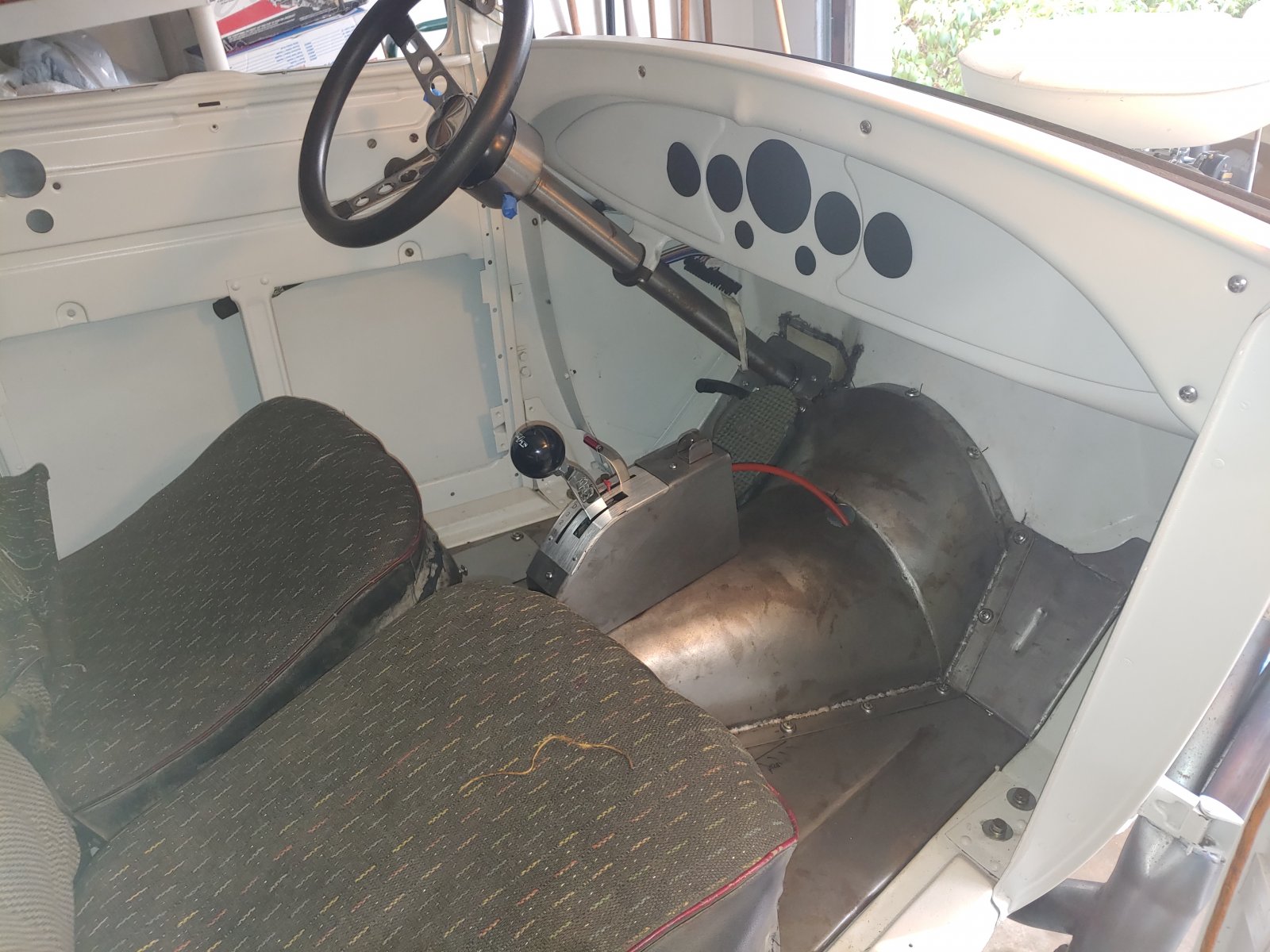

  29. dalesnyder
    Joined: Feb 6, 2008
    Posts: 648
    dalesnyder
    These are mg seats mocked up in my 31
    -Brent- and Just Gary like this.
