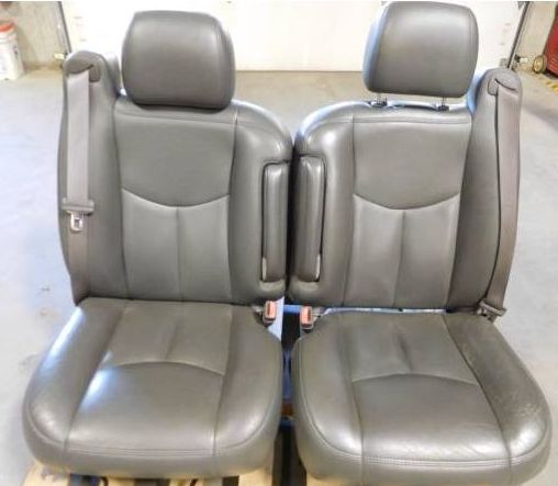

    They look identical to the seats in an ‘01 Tahoe I had, except the headrests are gone.

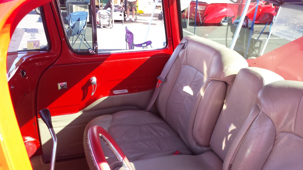

    Put a set of 2014 Mustang buckets in a 35 Ford 2door . Just had to make spacers for the seats to set level.
    Made oversize plates to go under the floor to distribute the force in case of an accident. They fit very well. Looked good too.

    Yes, the headrests have been removed !

    All the ones I find the belt sticks up above the seat like this one. Not like the ones @partssaloon has. Seats Chevy.jpg

    Your upholsterer could cut and lower the belt corner and remove the headrests. I think that is what was done to mine.

    Using 2008 Sebring conv seats in my 55 Sunliner. Built in three point belts. No computer stuff needed. I replaced the original seat belts with three point belts from Wesco, fit perfect. I have sectioned the seat backs three inches just for athestics. If they weren't in upholstery jail I would post a photo.

    These are out of a Tahoe or a Suburban. It would be pre 2001. Chevy pickups did not come with bucket seat options for a few years. Only 60/40 style seating. Yes, the headrests have been removed.
