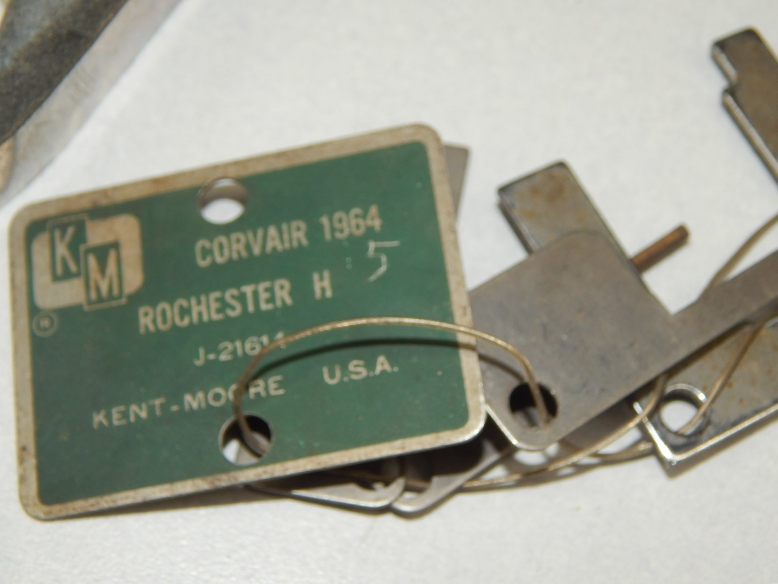

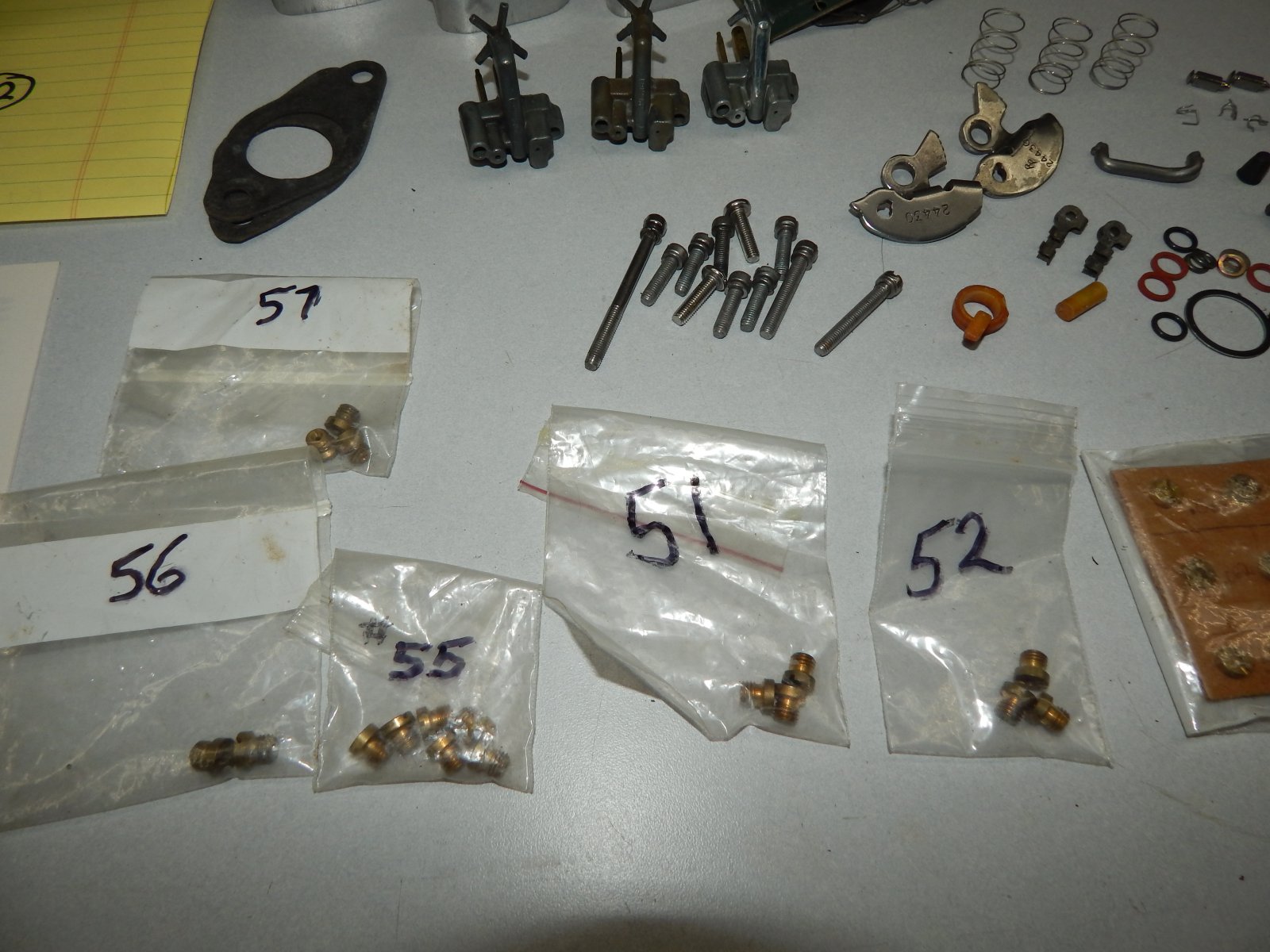

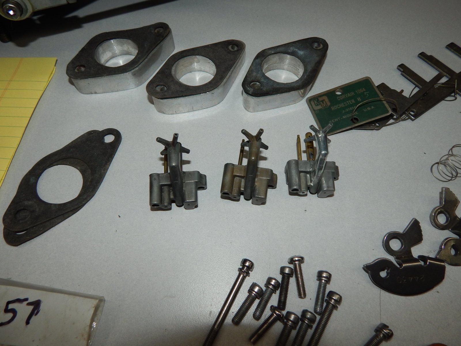

    Here is what I have, I had them on a 250 inline six. These were training carburetors used a school shop cl***. I have a bunch of different jets, misc parts, Kent More setting gauges, plus the Rochester service manual and specification / tune up pages. DSCN0732.jpg
    Stogy, brEad, ClarkH and 2 others like this.
  29. im looking for two 1963/1964 carbs. the jets on both of these broke off so they wont come out (they soaked in pb since last November) and a lot of other parts wont come off as they are siezed.
