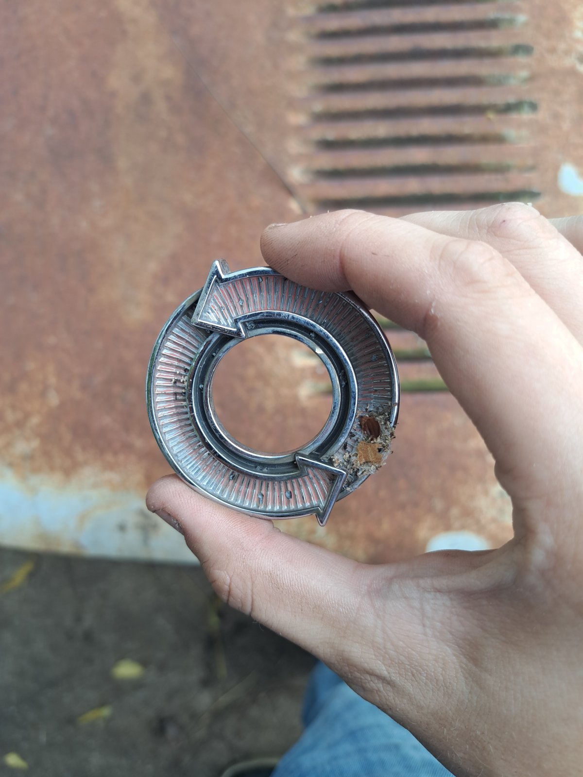

  4. Horn ****on? Thats the turbo emblem.

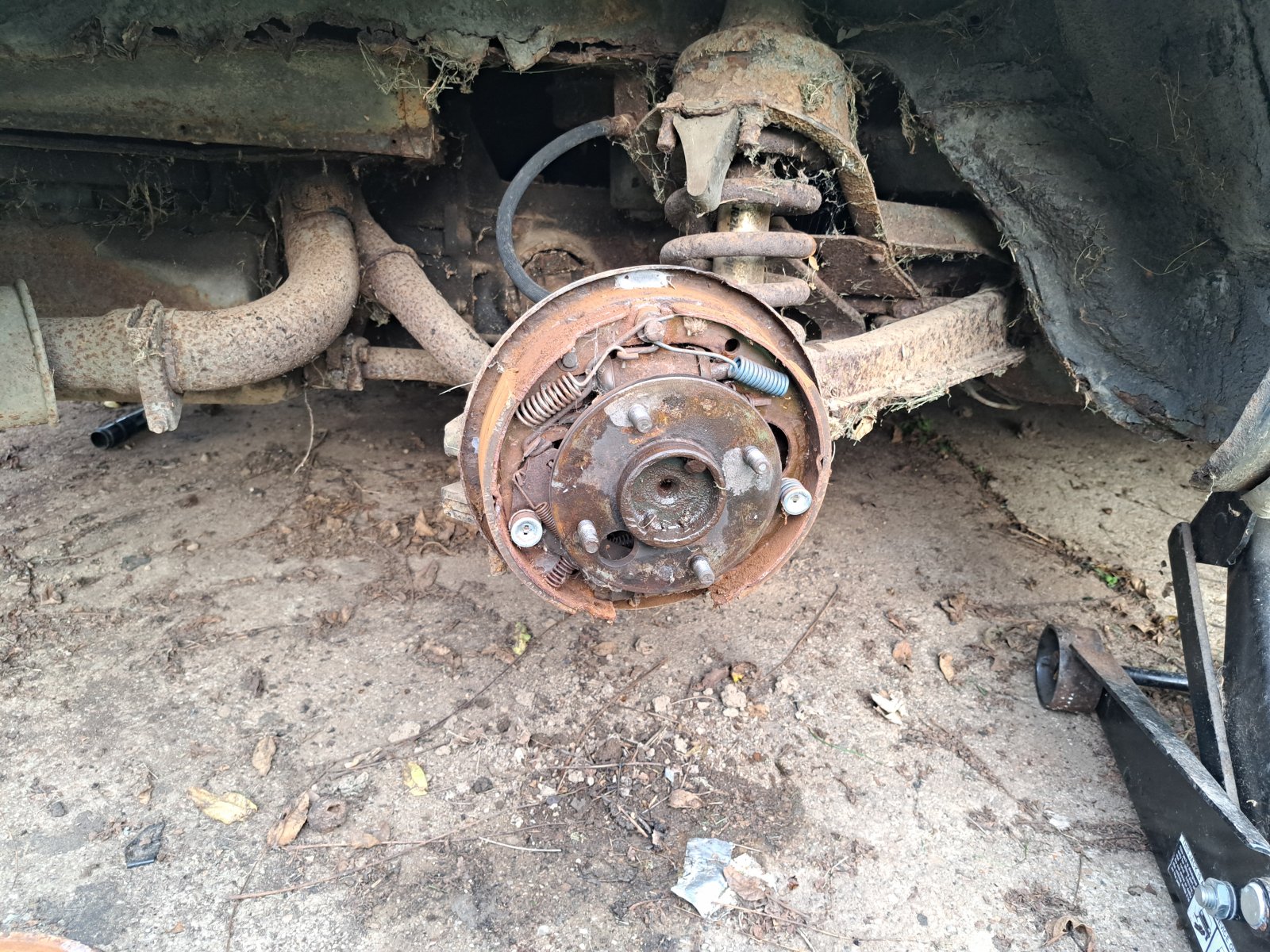

  9. honestly, this one doesnt seem to be too far from starting, needs an oil change something horrible, points sanding, carb needs dunked in diesel for a couple hours to clean out the mud dobber nest that decided to manifest on the choke plate, luckily nothing inside seemingly, need to see if the turbo spins... and the cylinders all need a little atf.
    by the way, how do i get the ignition switch out? i cant get the cylinder to come out because it gets stuck on the trim outside. no clue how to take it off and i dont want to force it.

    This is where things are going to start to ****. They don’t just come apart all nice and neat without a key. You may have to sacrifice some parts to the ignition gods. You will need a new ignition switch, keyed lock cylinder with keys and lock cylinder bezel. I just took a small Dremmel cut off wheel and cut the bezel 180 degrees apart then split it with a hammer and small chisel. Then push the switch through the dash and pull down from underneath and unplug. Don’t forget before you try to start it to get oil to the turbo first. You don’t want it running dry.

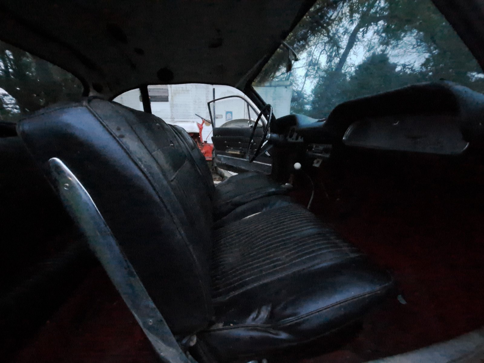

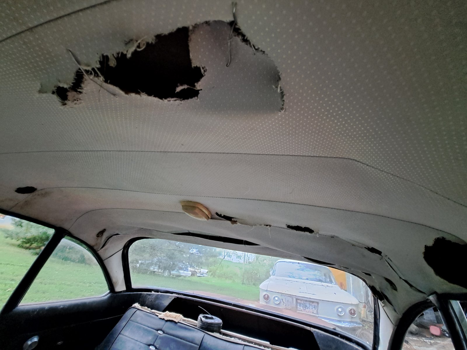

  26. 20220923_174858.jpg 20220923_174902.jpg 20220923_174904.jpg 20220923_174909.jpg
    More fruits of my labor... not even close to finished yet. Im gonna take some stainless wire and tie the tatters of my headliner up.

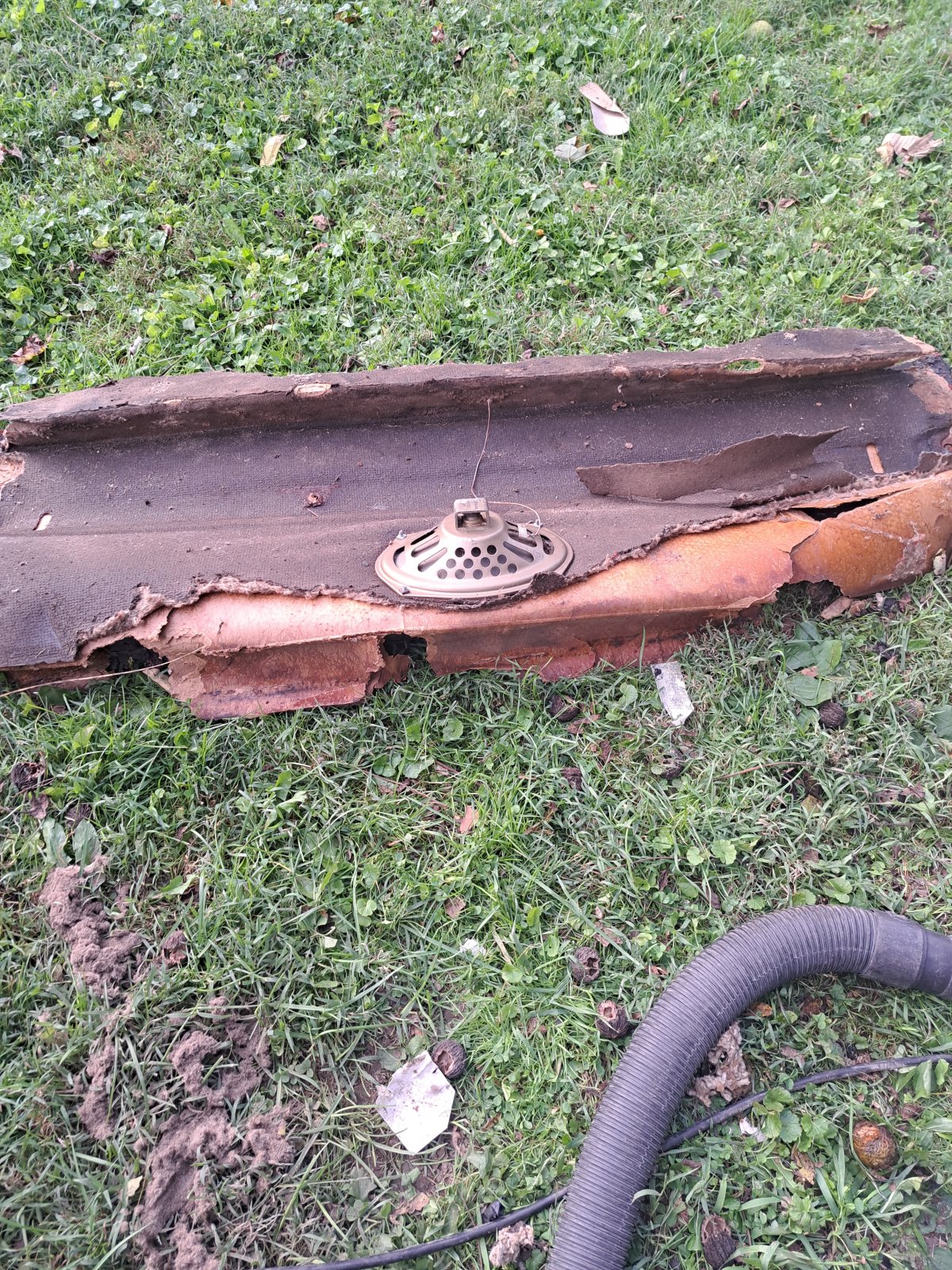

  27. Looks good here but dont let the dim light fool you, its still pretty rough, need to finish up the backing and reinstall it. 20220923_193803.jpg 20220923_190210.jpg 20220923_193658.jpg

    Fishing line works better and cheaper for headliners.
    The_Cat_Of_Ages likes this.
  30. I will keep that in mind for the white car, this one I just wanted up out of the way. And its all torn up, so i didnt mind poking a couple more holes in it.
