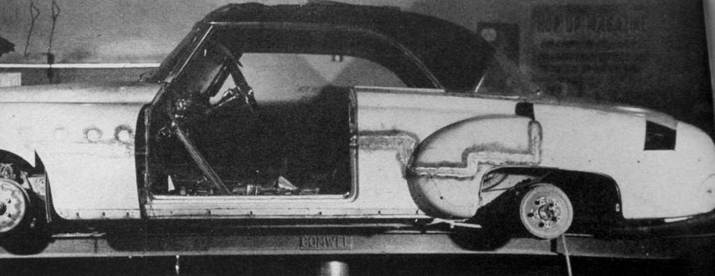

    Yep, that's pretty much it, Sal... you find as many near-to-vertical areas as possible and connect your slices the best way you can. On a shoebox, you can get almost 6 inches if you try real hard, but that's a LOT of drop when you see it in steel. Getting the steering box aligned and being able to retain a working trunk lid can be real h***les on some models. I think the realistic max is about 3 inches on most cars. That's enough to make a difference and still not create problems like those I mentioned. I used to think the '49-'54 Chevies and similar models would be near to impossible to section but it still follows the "find your common vertical surfaces" and take advantage of them concept.

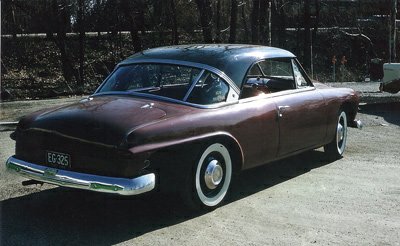

  6. Peanut1959....the sectioned 1959 4dr Dodge sedan was built in Victoria in the 1960's, but AFAIK disappeared in the 1970's......the 1940 Ford in the background is Leo Spesotts and the pic was taken at the Victorian State Hot Rod Show.....sectioned cars in Oz are very uncommon........in the Oz Sydney NSW suburb of Rockdale in the late 1960's coming home from school I used to p*** by a 1949-51 Ford 4dr Sedan that had been sectioned about 4 inches, it was in primer, road registered and obviously a daily driver...........I found out a few yrs later that it ended up in the local s**** metal dealer & crushed.......no pic as back then, no camera......lol.........andyd

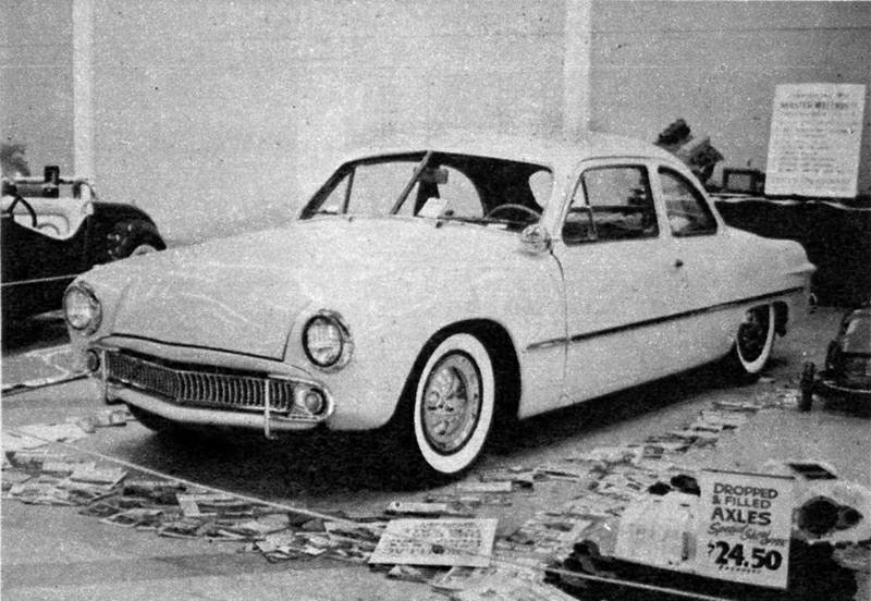

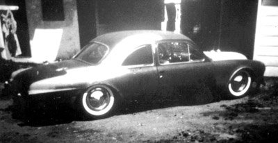

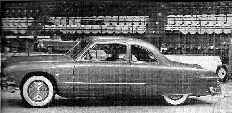

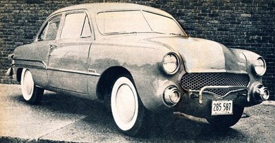

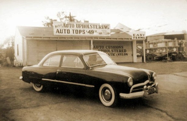

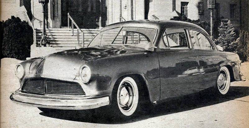

    A bunch of different approaches on shoebox Fords... Milton-depuy-1949-ford-profile.jpeg Gary-overby-1949-ford-profile.jpeg Merton-peterson-1950-ford-profile.jpeg Burt-hamrol-1950-ford.jpeg Don-britton-1950-ford-profile.jpeg Master-Welders-1950-Ford.jpeg Hank-katzenmaler-1951-ford-profile.jpeg Ron-hart-1951-ford.jpeg

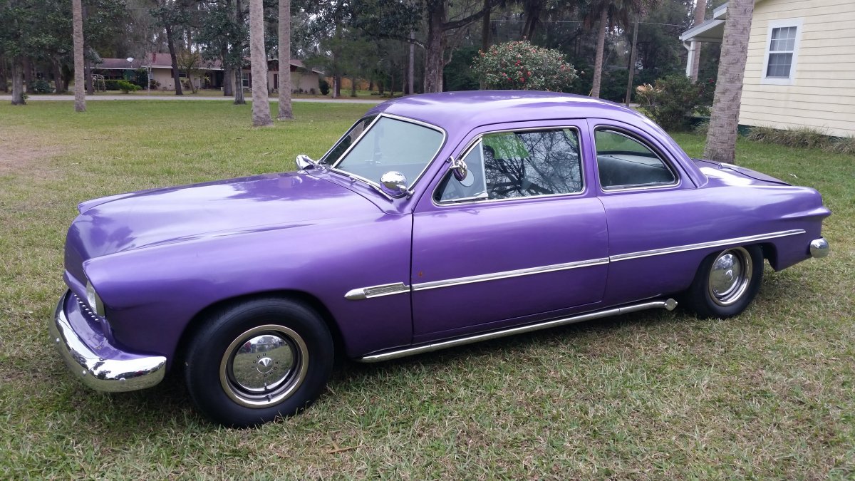

    20210128_142600.jpg just bought this last week off the HAMB,I first saw a sectioned 51 ford in Charlotte n.c around 1966 on Park Road,oops forgot about the one in Hickory n.c. across the from hickory high in 1962 ,often what happened to them.I had another one bout 12 or 15 years ago,but sold it..The one I have is pretty cool and seems to have been done well.I do have a few plans,but will keep it period correct,sorry upload problems..I will post later:mad:

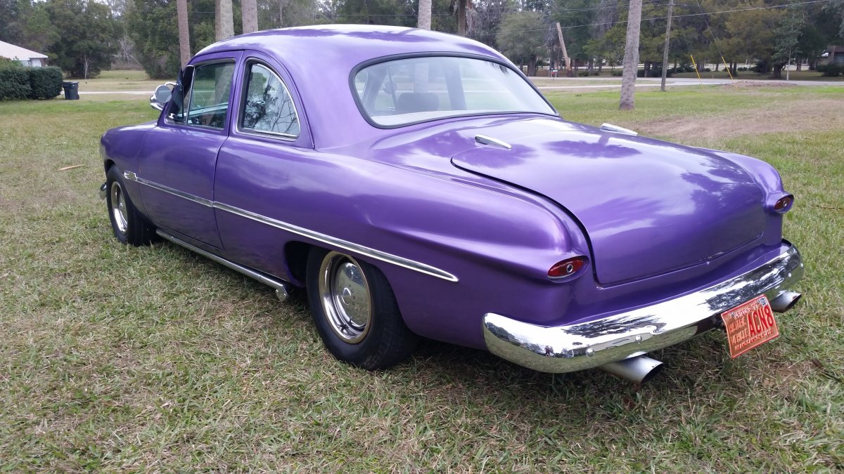

    the trunk is propped open for new latch

    Congratulations on your purchase! What are your plans for it, if I might ask?

    I would really like to give it a driver quailty paint job and update the interior,just keep it as a driver,unless something else came along that I like better...Its just ana ddition thing.I had a similar ford about 12 years ago and sold it.Been regretting it ever since..
