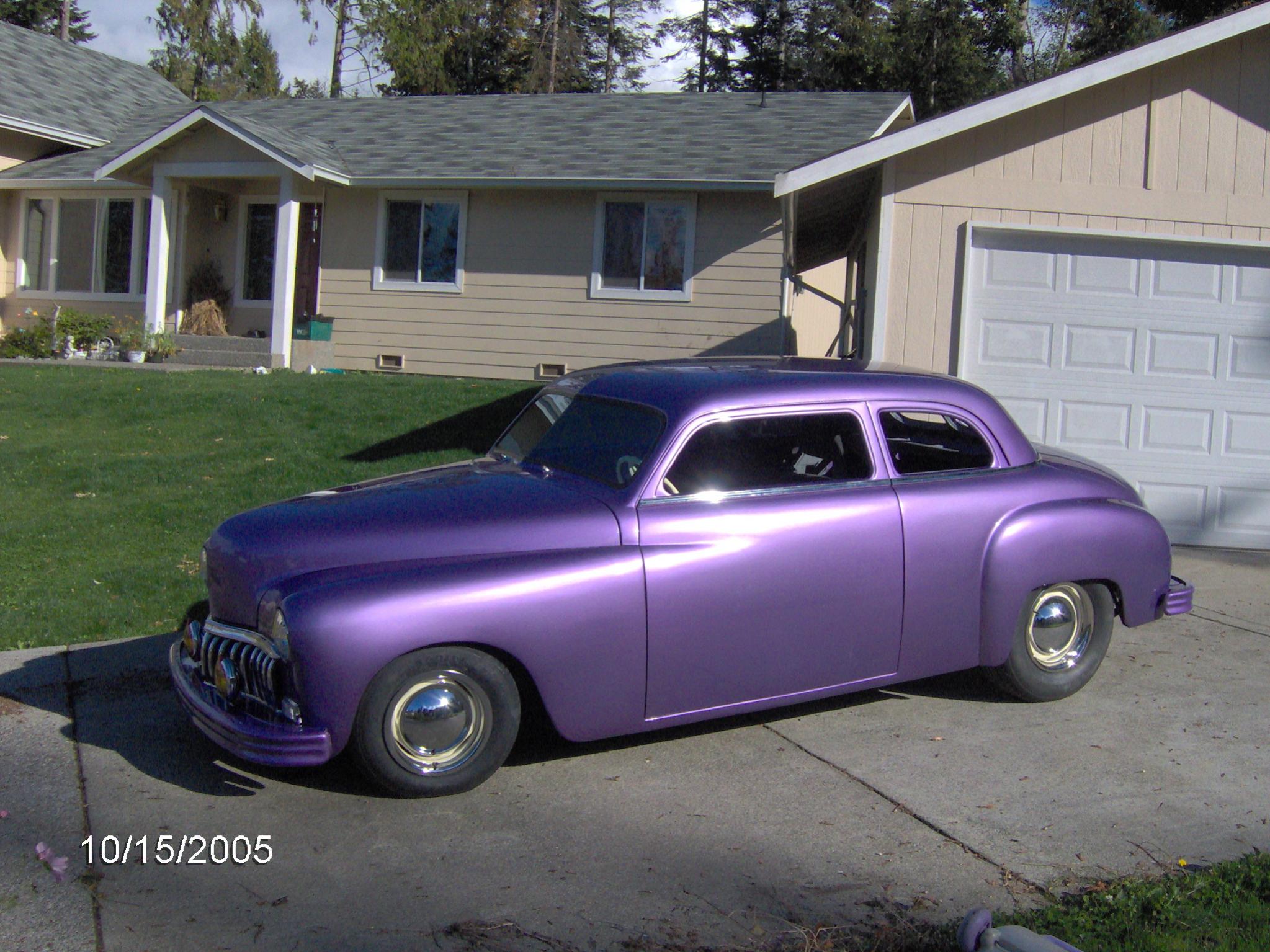

  14. very nice work. I have a 49 Plymouth and if you look at the side view of these particular years, you will notice that the fenders tend to run slightly uphill from the door to the headlight. One way to cure this is to cut the fender at the top by the door and continue the cut into the wheel opening. you can then drop your core support mount (I did 3 inches on mine) and then let the upper part of the fender slide into the lower part of the fender (pie cut). Cut off the extra metal and weld the seam. The hood will follow the fender down, (you might have to trim the rear hood line) and you can be rid of the uphill look of the fenders. NOt the best explanation, but hopefully you can get the idea. Once again, awesome build.

    I get what your saying, do you have a side view pic of your car?
  16. two best ones I have, not perfect side views, but will give you the idea

    I can tell it brought the height down. I don't think I can do that, the sectioning already brought the fender height down. I still have the height in the hood, found a 51 Coronet, nice hood and grill, might be nice to try that on the Dodge, don't know how much cut to fit.
