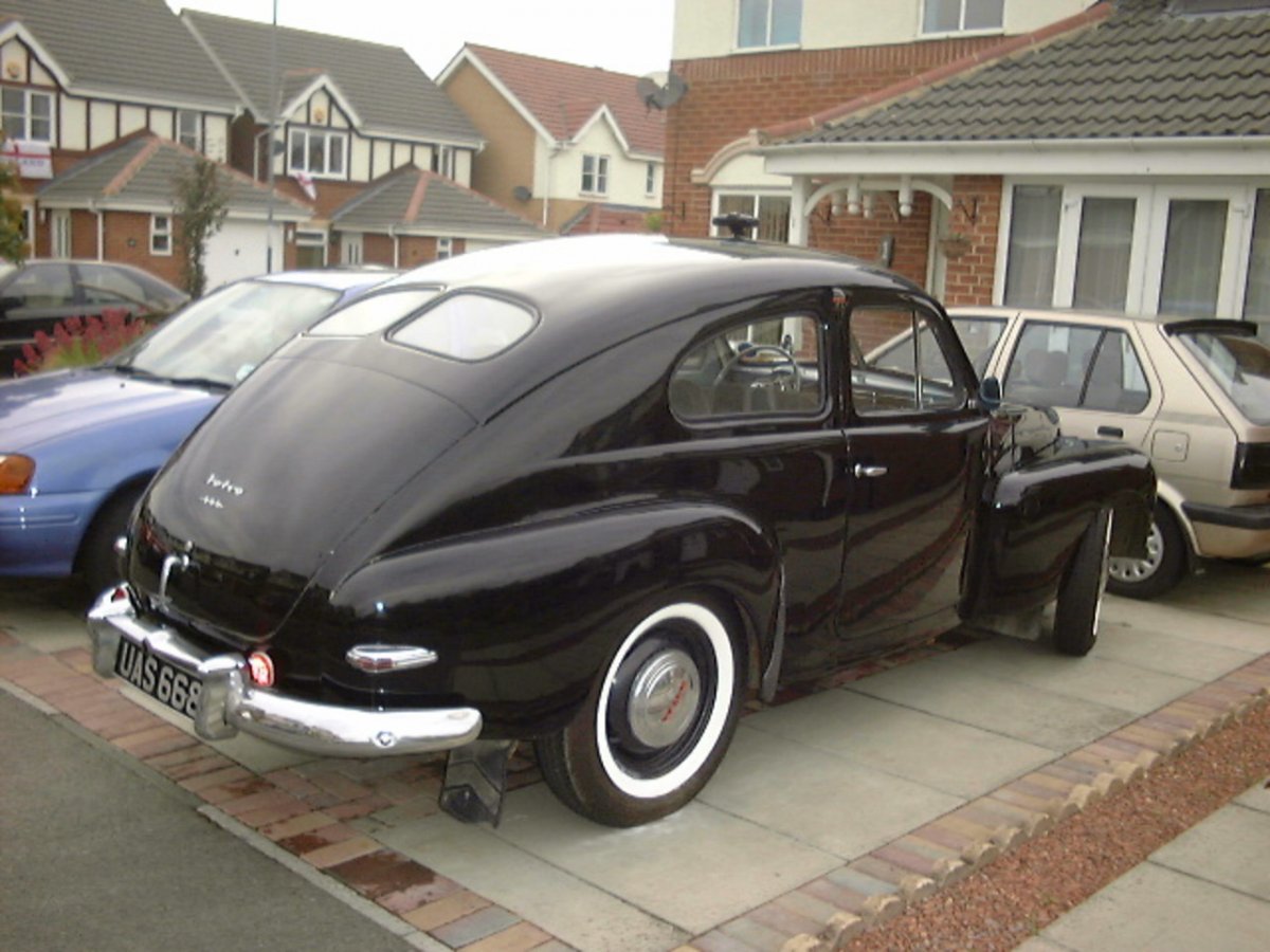

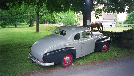

    I want to convert one of my pv544 sedans into a coupe.I've talked to a couple guys in Sweden who have built them.They both used very early vintage mercedes rear roof sections.Could you guys/gals recommend a donor roof here in the states.Options on how to complete the conversion would be great. pv544 hot rod.jpg pv544 converted to coupe.jpg

    Glad to posted the photo of the gray Coupe, gives us an idea of how your car could look. Good luck with the project, I think some 46-48 Ford parts may get used. Bob

    I had a 1958 Volvo PV544 at one time, really was a neat car. I would like to have one again with maybe a V8-60 or a V6. I am glad you included the gray coupe to get a better idea what it would look like. Even though it is a clone of a Ford it was still hard to visualize the conversion. Hope you succeed, post photos when you do.

    pv544 converted to coupe.jpg pv544.jpg That an be a slick little coupe but there is not going to be any free lunch as far as the build and amount of metal work required to do it. I thought you might be able to lay the deck lid down like they do on a chopped fast back but further and shorten the length of it using part of it for the catwalk but I'm not sure that will work all that well and get the look the gray and black one has. I'm like a couple of the others you will have to find a donor roof that you can cut the back half off and probably a donor trunk that has the bustle look to it as the laid down/cut down stock deck lid will have a lot of slope to it. Looking at this you have your work cut out for you pv544.jpg
    Looking at the coupe conversion it looks like they raised the bottom lip of the deck lid opening several inches to lay the deck lid over more (a lot more) and then shortened the decklid using part of it as the catwalk.
