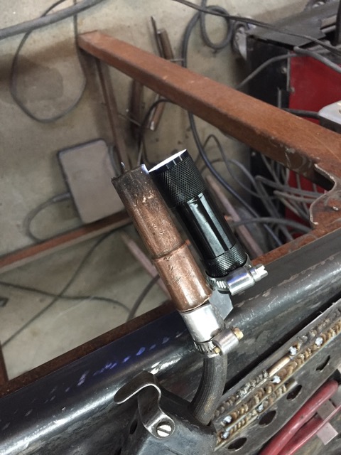

  28. WZ JUNK
    Joined: Apr 20, 2001
    Posts: 1,915
    WZ JUNK
    from Neosho, MO
    5BE5DCF7-7476-41EE-B055-D1D18FF62931_1_105_c.jpeg Harbor Freight give away flashlight on an adjustable bracket attached to my Mig gun. After a lot of use the flashlight will quit. You throw it away and put on another one. It makes a big difference for me.
    R A Wrench likes this.
