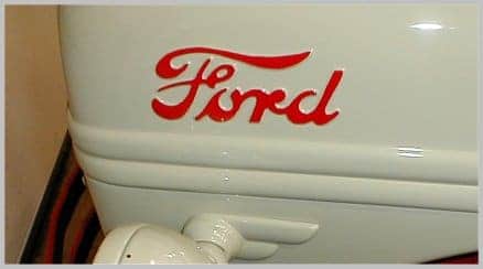

  11. krgdowdall
    Joined: Apr 3, 2015
    Posts: 141
    krgdowdall
    from Alberta
    Speedway and others sell a Ford script logo in br*** or chrome about 8-9 inches long. About right size for a tailgate . Apply with double sided trim tape.[​IMG]
    upspirate and loudbang like this.
