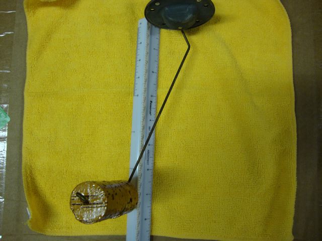

    This is a picture of an NOS factory 35/36 Plymouth tank unit, and it has five holes. I've got one and I will try and check the resistance range and measure the dia. tomorrow.

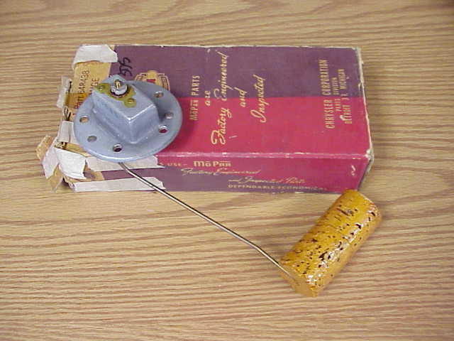

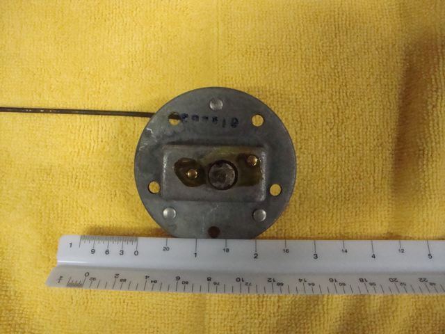

    I checked the resistance on my sending unit. It measures .5Ω in the full position, and 133.3Ω in the empty position. The arm and float drop a total of 7¾". The unit measures 2¾" outside diameter, and the circle for the 5 screw holes measures 2 3/16". The P.N. 614463 is an early number for a tank unit (except '34), and listed as a universal unit. The unit with the red MOPAR package is P.N. 648438. It is for a '36 Plymouth and is still available @ http://www.mmpar.com/mmpars/default.aspx
    I don't know the price. I paid $80.00 for the 614463 at the Springfield, OH swap meet last week. The vendor had a duplicate, and I'm sure he'll be there for the mid-November meet. There have been two on ebay the last year and they have gone for $160.00 to $180.00 as I remember. I hope this has been some help. The old MOPAR stuff was all 6V, but that shouldn't make any difference as the resistance is in the correct range for your gauge, and the float arm could be easily modified for you tank depth.
