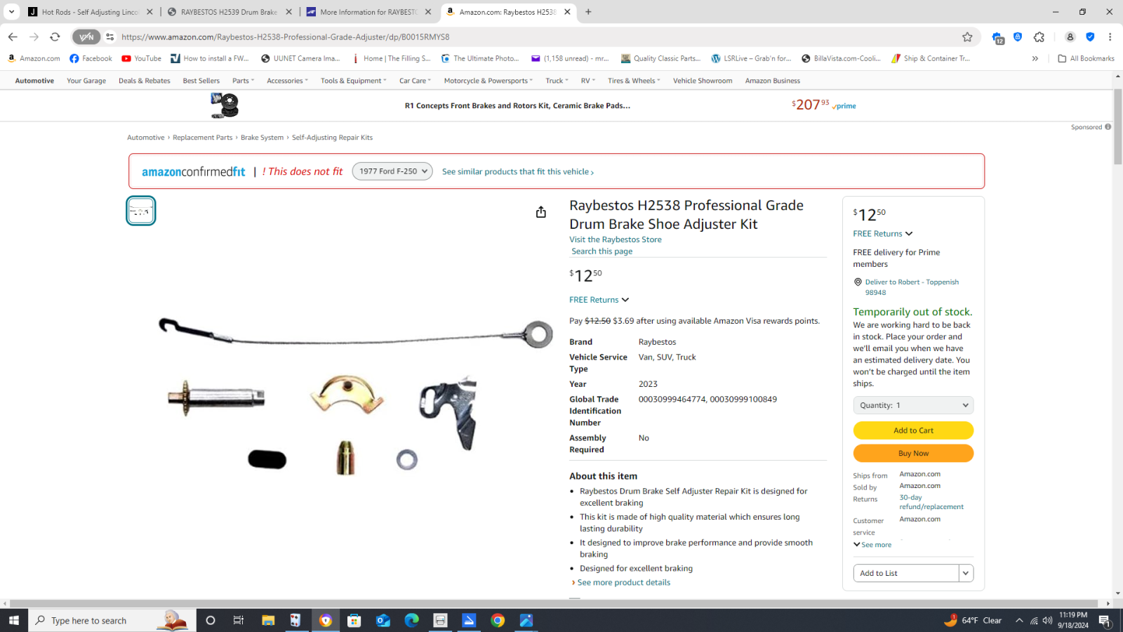

    These are the parts I've used for adding self-adjusting stuff to 12" Ford Bendix brakes.
    There being a difference in anchor pin center to axle center between GM Bendix and Ford Bendix, but since 12" GM self-adjuster parts are a little hard to locate, I really don't see why the Ford/Dodge/IHC/Jeep style parts wouldn't work.
    The cable guide on the right side of the shoe is sitting in the wrong place in the picture should fit three holes up where the retract spring goes.
    The purple spring in the picture is included in H-7139 kit I use for the retract springs & hold stuff.

  21. Mr48chev
    Joined: Dec 28, 2007
    Posts: 36,094
    Mr48chev
    I did some searching and can't find the correct 69 Buick adjuster arms/levers. Those kits that rich B showed works, is simple and years of doing brakes say that parts are pretty easy to find. 12.50 for each side from Amazon for the kits. I can't remember if odd or even means left or right but you need one of each. You might be able to get them locally though.

    even number is driver side, part numbers say both fit 12 inch x 2 inch front brake.
    do you think they will work on the rears too?
    i have lincoln style brakes on all four corners.
