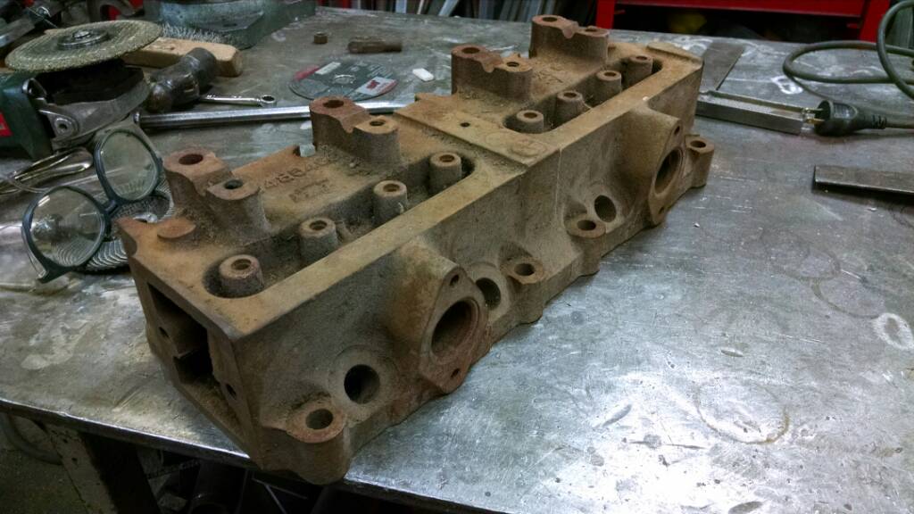

    Find of the day, N.O.S. dual port Chevy head. Its still out there fellas!
    Jet96 and waxhead like this.
