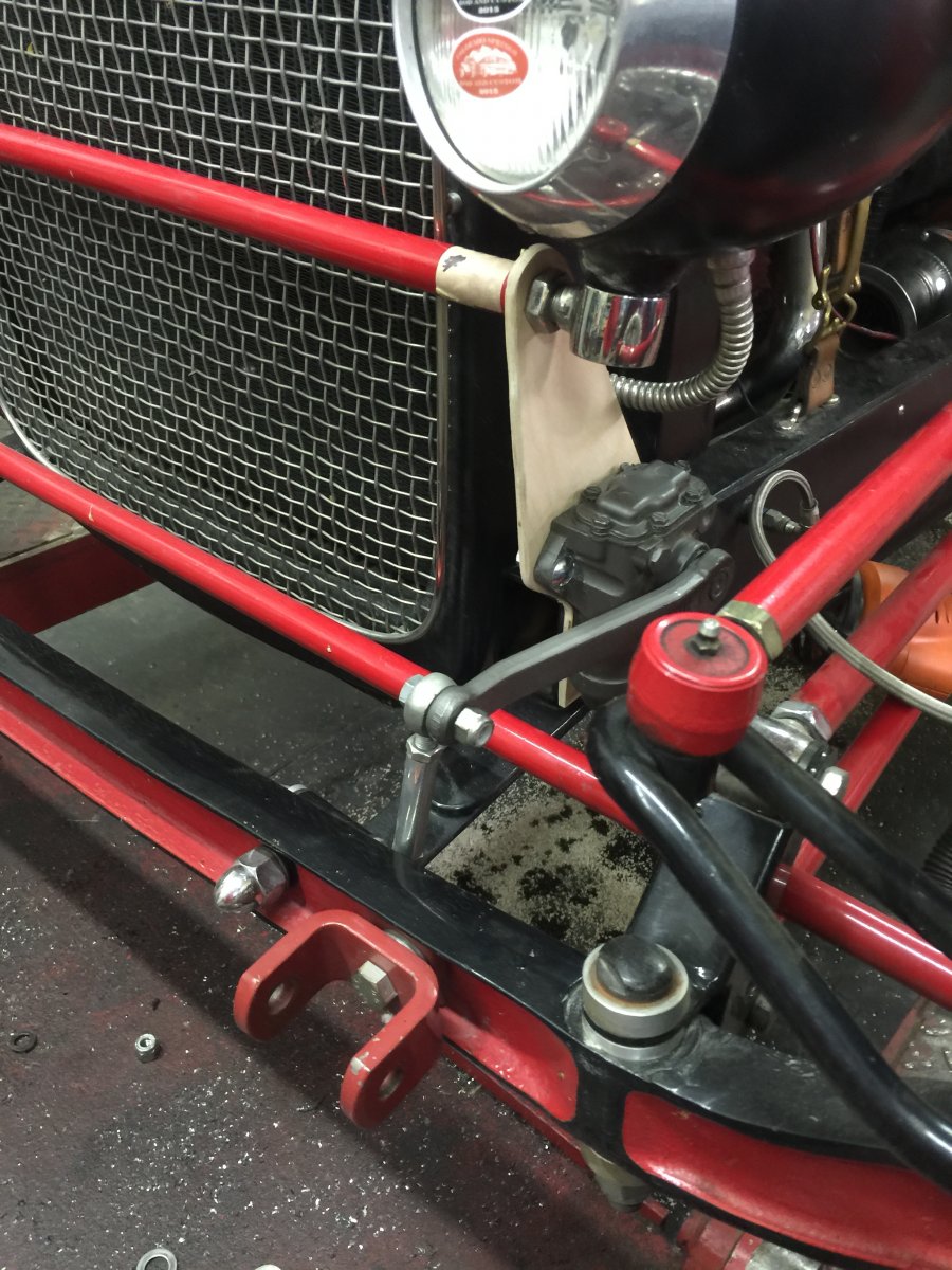

    Long been a proponent of friction shocks...however, switched to Armstrong lever shocks from a Sprite ala Limeykid. This is the mockup pattern. image.jpeg

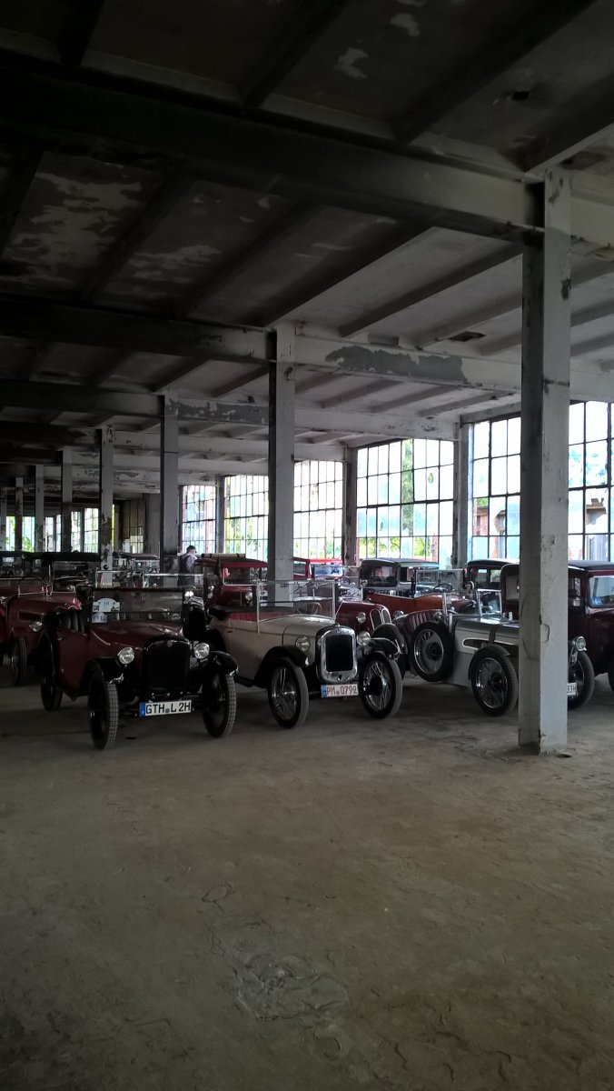

    This is what I was doing yesterday
    More tiny 4 bangers.......

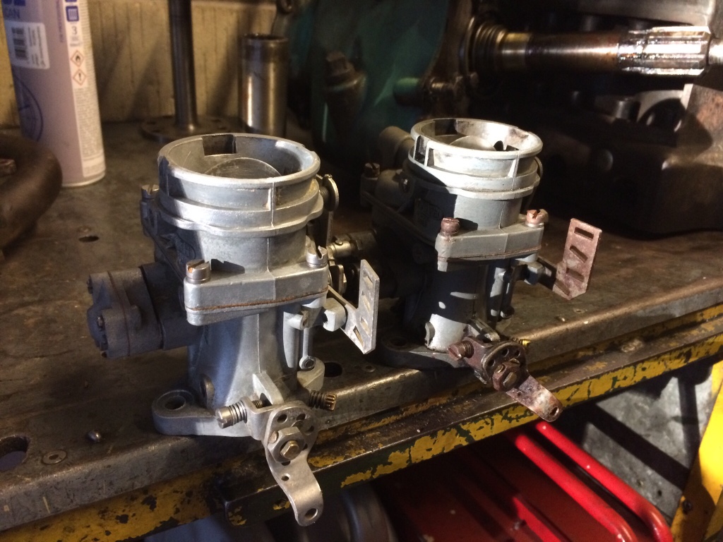

    Here's a couple of shots. The engine is apart waiting for me to get at the rear casting with a grinder. The heads having new valves and blocks having A piston and rods fitted.
    The zenith carbs are going on a manifold hopefully being supplied by a fellow HAMBer
    And the proposed siting of an A 3 speed behind the T Trans. Haven't decided weather to run the 2 T speeds or leave the bands out and use the straight through gear.

    Please strip and inspect the carbs making sure the every details are the same between them. Chevy carbs sometime have differences that make a non-matched pair almost un-tuneable sometimes

    Yeah will do. Pretty sure they have different jets in there so will have to be totally gone through

    Not just jets throat dia as well. I use a pair of Carter YF's and it took a long time to get two carbs that made a set

    These carbs are British built. The housings are bob on.

    British built....... How bad do they leak?;)

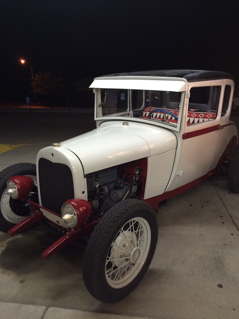

    Checking in for the month. Test drove my coupe yesterday! It ran and drove beautifully. Ended up driving it maybe 10 or 15 miles. Need to drive it much more to find any bugs before the Hill Climb in less than 2 weeks. Only some details left now. Who is going to the Colorado Hill Climb this year?

    jimski , how many are yours ?

    None..... all my 30's BMWs have six cylinder motors.

    thanks . nice collection !

    2nd white one I've seen in as many days. Can't believe how good it looks !

    The car is a grey, a very light grey and the maroon looks almost red. The lighting at the drive in and in my shop make it look lighter than it actually is. Thank you for the compliment!

    Feel a bit stupid now... Fact still remains, she looks sweet

    No need to feel bad about it. Colors always look strange in pictures. I about freaked out when I started spraying the grey and was worried how light it was. The maroon also looked almost red too. hard to determine colors from small paint chips in a book at the paint store.

    Looks good, real good

    Just checking in , want to keep up with what is going on . Coupe looks great ,love the build
