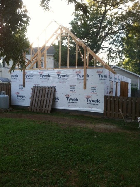

    Happy September.
    Here's the new shop I'm building. Only 22 feet at the peak, but plenty scary up there. photo.JPG
    It'll be 24 by 36 with a walk up attic when finished, hopefully before the snow flies.

  5. That's gonna be a fine shop! Are you gonna be putting in a car lift? and some cool old time cedar siding?
    One more question, is that picture taken from your yard or a neighbors yard? (with the fence and all)

    Maybe a two-post but I hate to give up the floor space. Yes, that's my yard. The fence is for the dog.

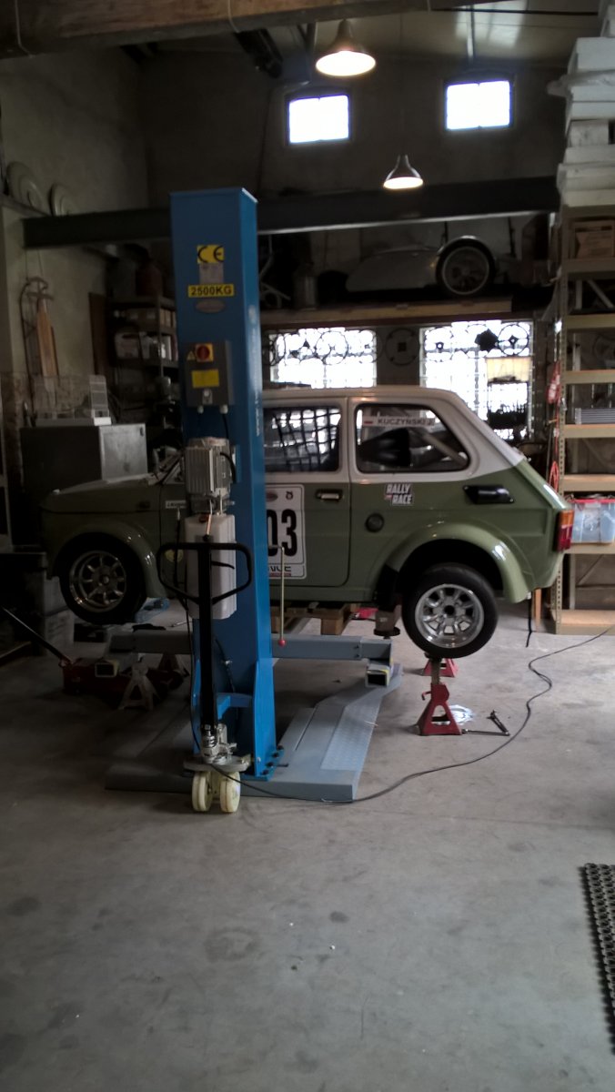

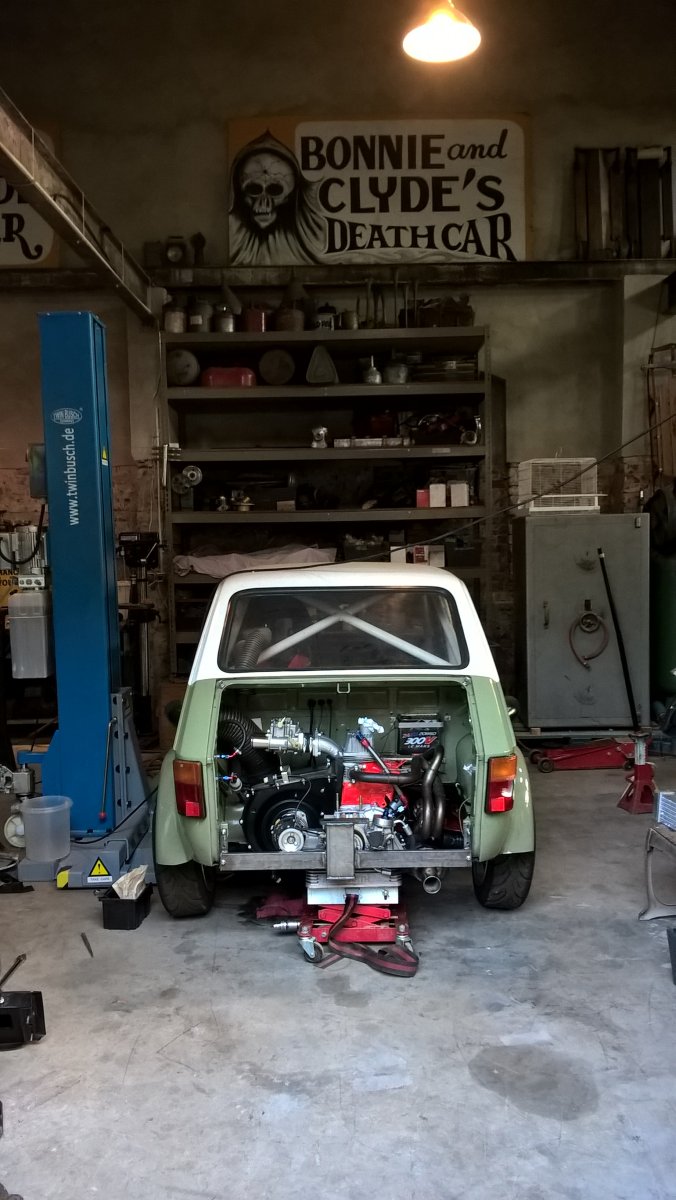

    If your not dealing with a heavy car look into a single post. The one I have has the trucks and jack from a pallet jack and rolls around my whole little shop. I just leave it out of the way when not in use.

    jimski , info on the race car please . looks like fun
  27. Bluto
    Joined: Feb 15, 2005
    Posts: 5,113
    Bluto
    Steve the info is on the OFC
    This is a 1/2 banger
