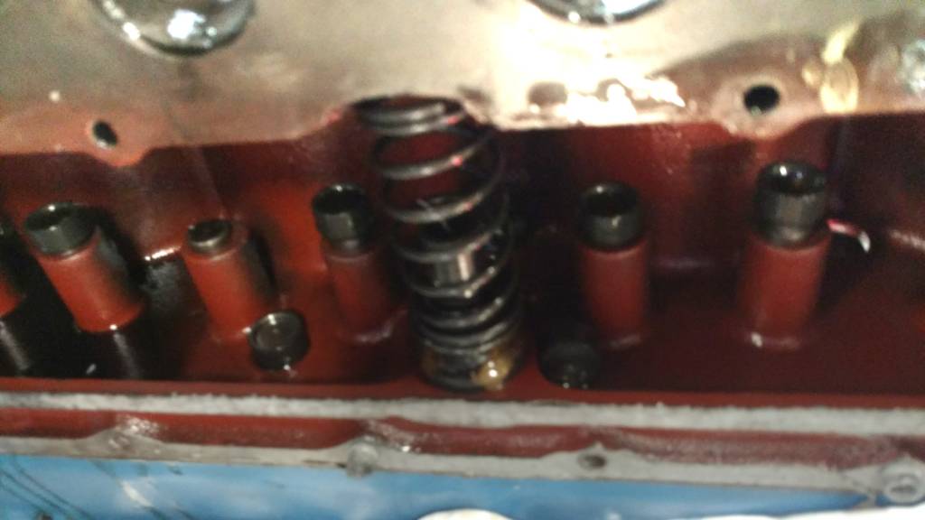

    So, in order to make it a pushrod engine there are "tappet caps" installed on top of the lifters. Invariably every time I do this the oil in the cup on the topic cap pulls a cap off the top of a lifter even being careful. It adds extra work having to pull the side cover. It's the second one from the left that's dropped off. IMG_20200907_082014.jpeg

  6. That is just another way of making a pushrod motor.
    I have found that using adjustable tappets, tossing the adjusters and replacing them with good bolts and a ball cut in the top work well. I have seen a few with socket head screws and pushrods running in the socket.
    One advantage to this is shimming the screw heads up to get proper geometry on the rockers.
    J

    John,
    You are spot on. I'm not going to pull the engine all the way apart just yet but when I do, the tappet caps are going away. I have adjustable lifters in another Miller OHV that the adjusting screw gets replaced with a socket head machine screw with a ball cut.. Yes, was able to address the rocker geometry better that way too. I had to cut shims to go under the rocker stands on this one along with using offset keepers on the valve springs to address the rocker geometry. It is the details that make things run and work so much better

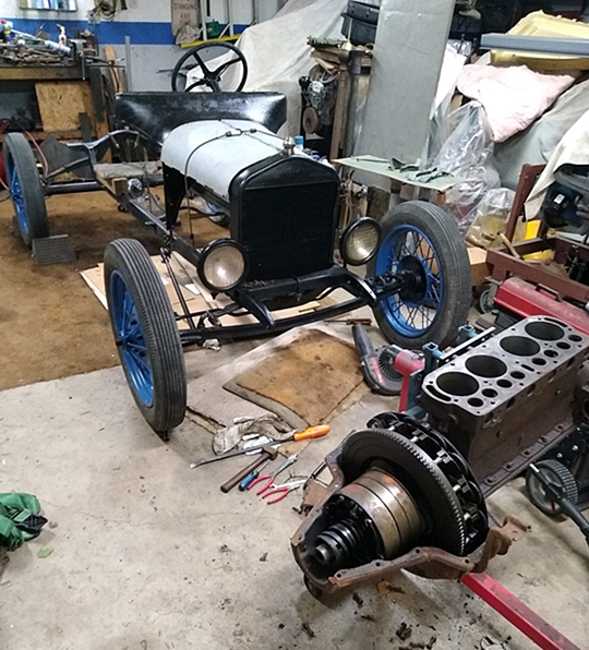

    Pulling the mock-up motor to scavenge the crank and trans so I can build something run-able on another block.
    Someday it might run.

  13. Looks great from here, keep it up!!
    Don't forget to post pictures.

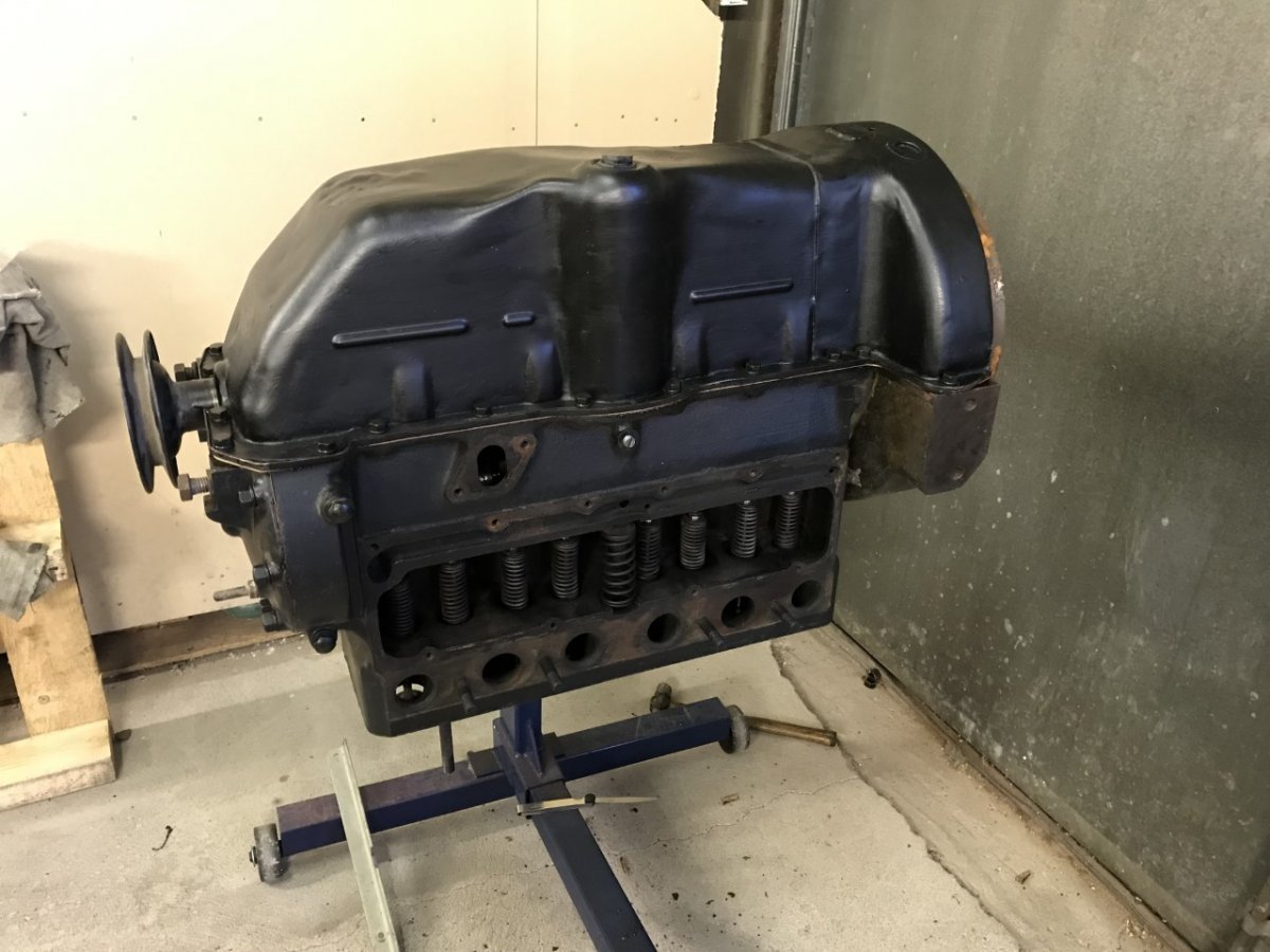

    Today I finally received the gaskets and retaining spring for my oil pump.
    So I went to work and got the pump and also the oil pan installed.
    That rear cork part of the oil pan gasket was putting up a bit of a fight but finally I got it in place correctly.
    Gonna do a final check of the valve clearence this weekend and install the valve cover.
    Then I can start thinking about installing engine and trans in the chassis.

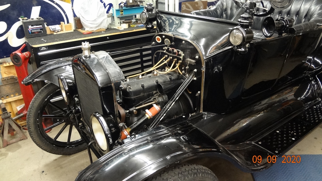

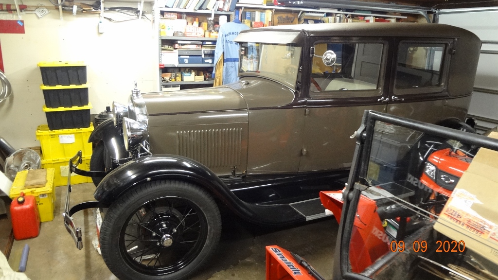

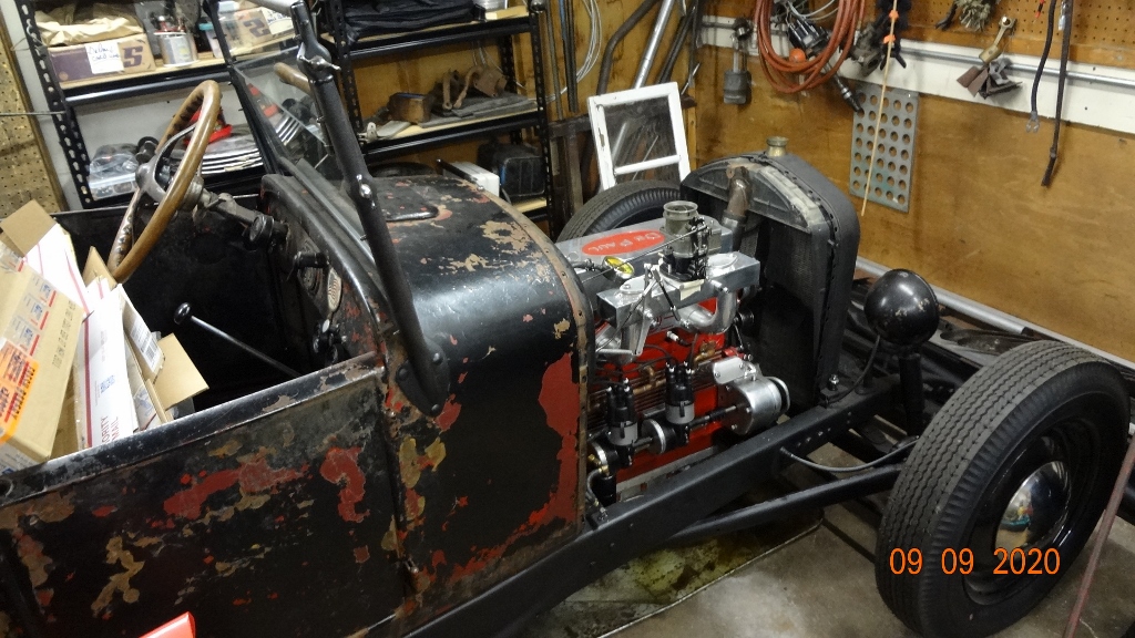

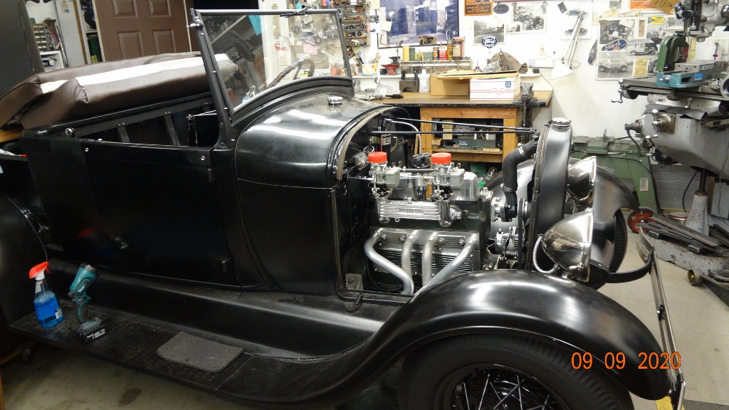

    Banger garage. 9.9.2020 DSC01731 (1024x576).jpg DSC01732 (1024x576).jpg DSC01733 (1024x576).jpg DSC01734 (1024x576).jpg

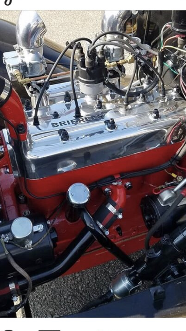

    You’ll be extremely happy with that set up. Both good products. Brierley head makes a huge power difference!

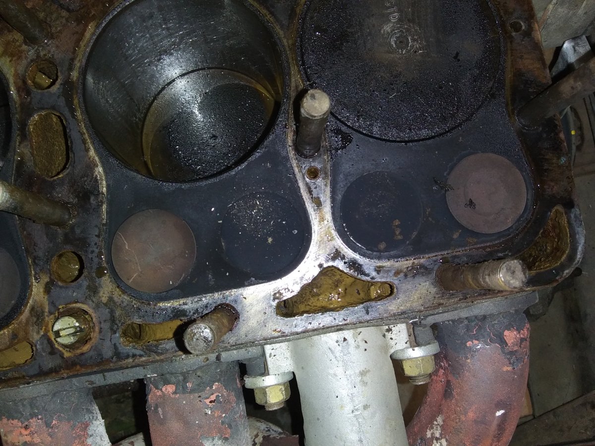

    Doing the 5.5 head swap and will be finishing it up today .one helicoil in the block I gotta fix and it's got standard pistons.made my own head pullers and worked good.any thoughts or comments appreciated. 20200910_173603.jpg 20200910_174429.jpg 20200910_175349.jpg 20200910_174109.jpg 20200910_174220.jpg 20200910_182753.jpg

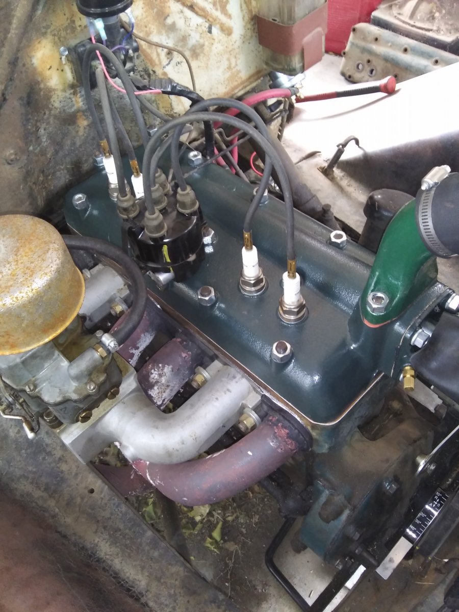

    Got the head on with little trouble.fired right up!seems it needs more advance than before,gotta check it out.gonna run a couple heat cycles and retourque.then drive later today. 20200912_104529.jpg 20200912_104538.jpg
