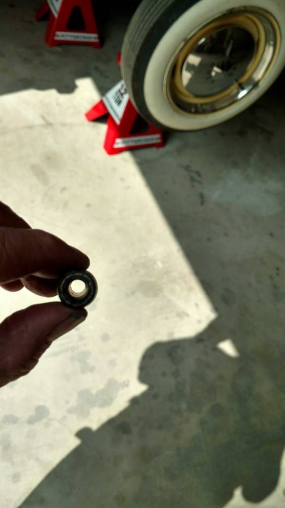

    Holly 94 on a Burns intake and the gravity works real good. It works better than the fuel pump. I found larger fittings for the tank valve outlet and carb inlet. Banjo fitting on the carb Then a larger fuel line. You know, one less thing to break and put you down and out on a road trip.

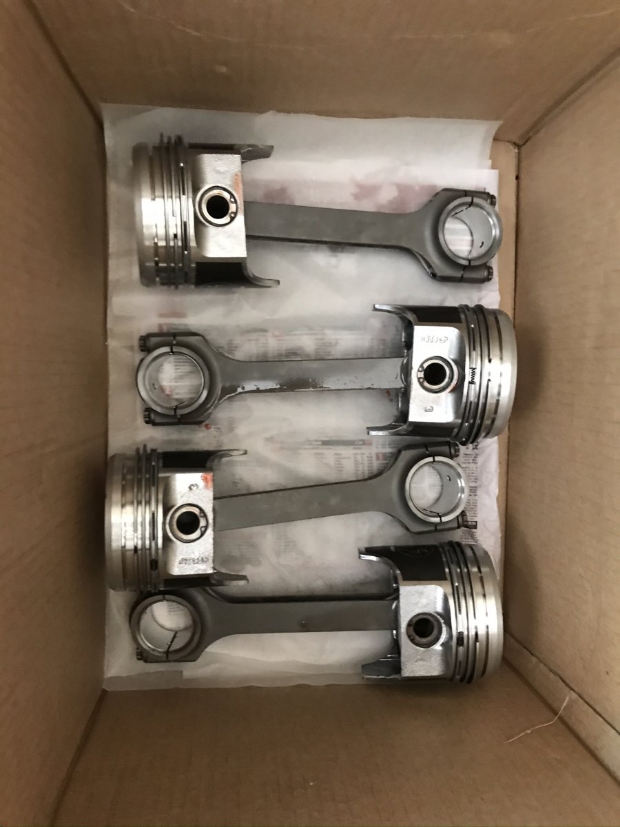

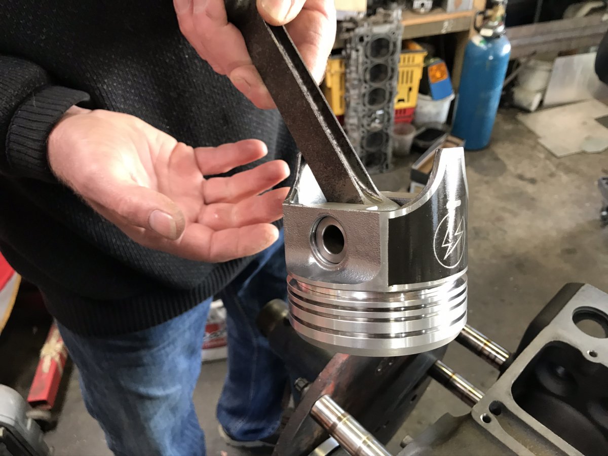

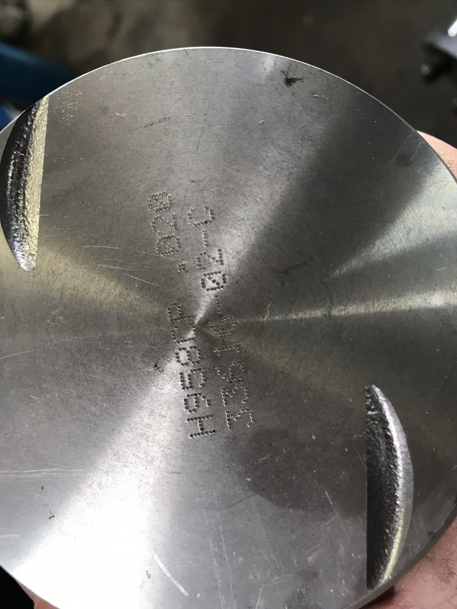

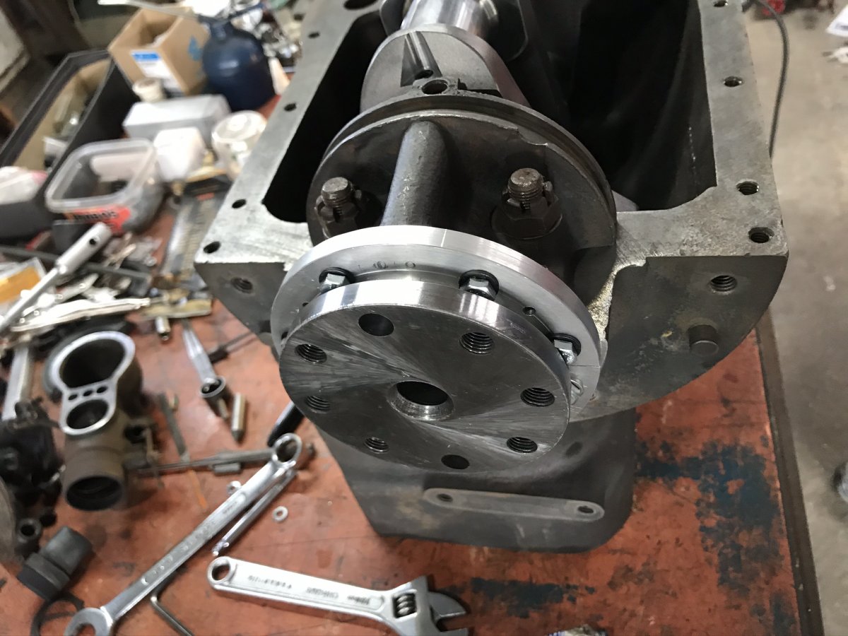

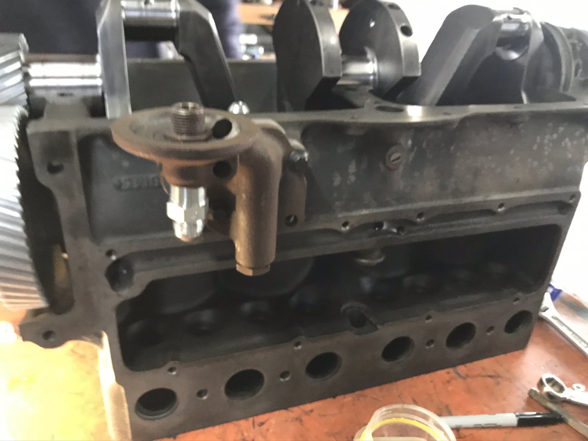

    Slowly , too slow for my liking, the parts ac***ulation and ***embly of a 32 diamond B . Using the original Cragar cover , but a new head. Plus other old parts to aid the look which matches the look of the 32. **** crank and Rods , 348BBC .020 pistons ( not the W head , but big truck and bus) not using top ring as piston rises up to this groove. My guy wants to get better compression so has also milled the head. Twin 81 carbs on zephyr manifold with grace and co air cleaners modified to take K&N filters ( we live on an unsealed Dusty road) Lightened fly wheel and V8 clutch. Custom ground cam done here in NZ. The rear seal was my engine guys idea and it turned into a bit of a headache but he got it done . MB type willys jeep rear seals and custom made housing . Full oiling system with externally regulated pressure on a Chrysler 440 filter housing . .We have an FS distributor in the 32 at present but are going back to a B distributor and points. My engine guy is extremely thorough in what he does and examines every detail . D78AE293-2ACA-451E-B572-3597E548635F.jpeg 46BDA26F-13AE-4E89-9A78-6DFDDC115A65.jpeg 028D586D-F197-4E94-932E-7A19ADA195E8.jpeg C1D4446F-372A-4454-8688-1C175BAD542C.jpeg 5153B169-56EE-4EE6-97A7-19C7D3393B4F.jpeg 186314D6-8946-421E-8530-0081EFDEBE3D.jpeg DB19B091-60D7-4C4A-86A2-C5498C7BF261.jpeg 0612B15B-5113-48C6-943A-E451035C3781.jpeg D74E9BBD-0007-4E90-AFE0-20ECC0A37277.jpeg

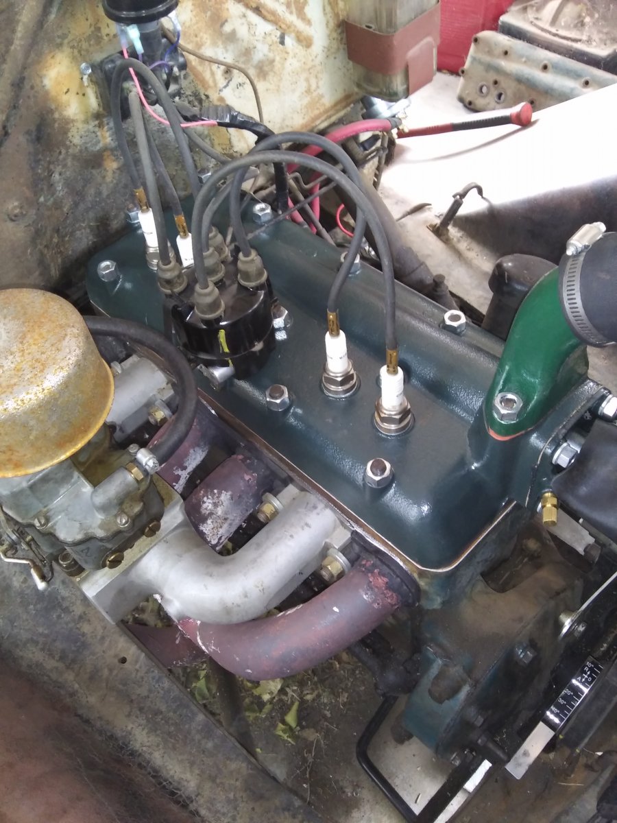

    After the swap of the head the car is running very smooth at idle and pulls good.head gasket weeped until I retourqued the head 4 times then stopped.ive got the total timing at 20* with the lever,I can turn the rotor to get more of course.what is the max timing you guys are running in these beasts?a ford book states stock range is 0-30*.standard pistons,header,downdraft intake with a 94,5.5 Snyder head 20200912_104529.jpg 20200912_104538.jpg

    I think it has to do with how hard you want to be on the center main...
    I have heard that much past 23 degrees total advance starts affecting the center main...however if you want to win some races..... advance in relation to RPM

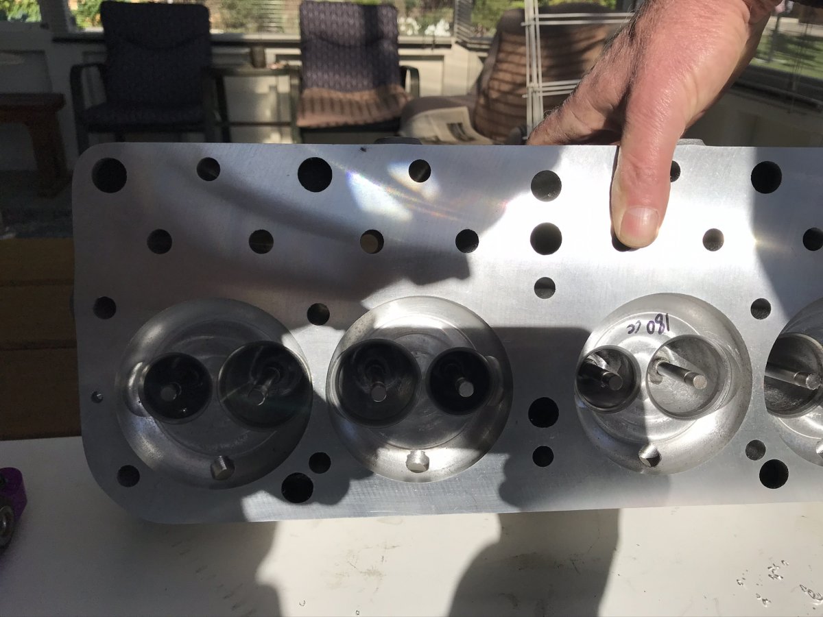

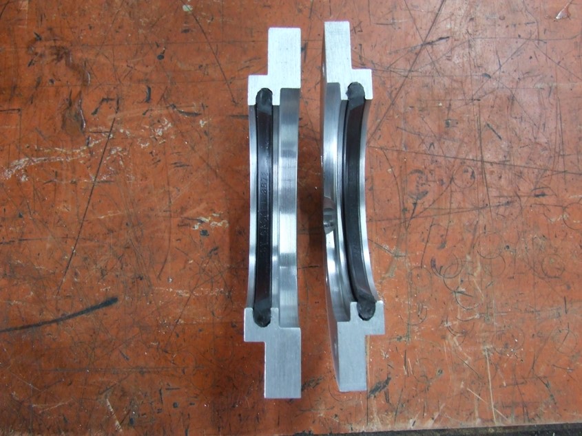

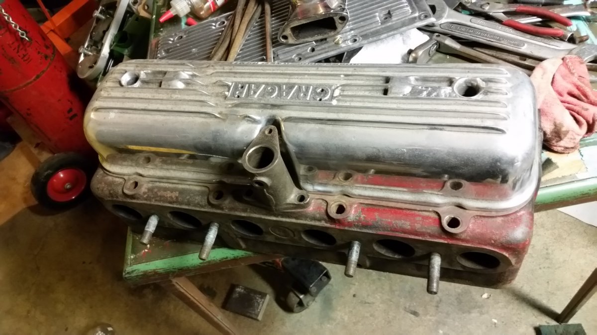

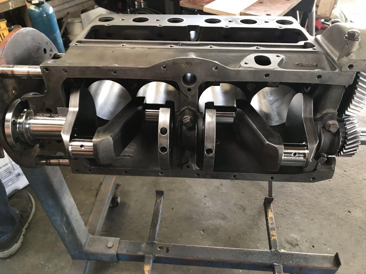

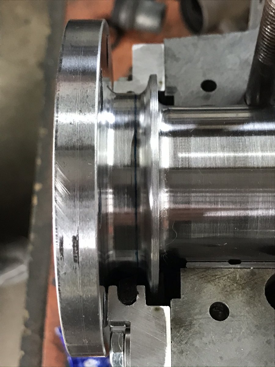

    The deal was two heads. An original Cragar and new miller Serr head, sold the Cragar and it made the new head half price.

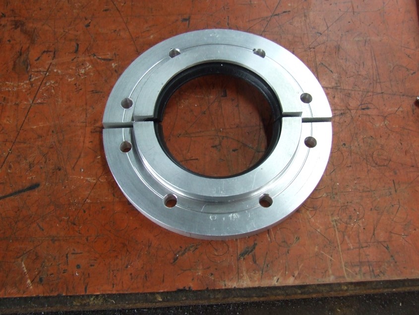

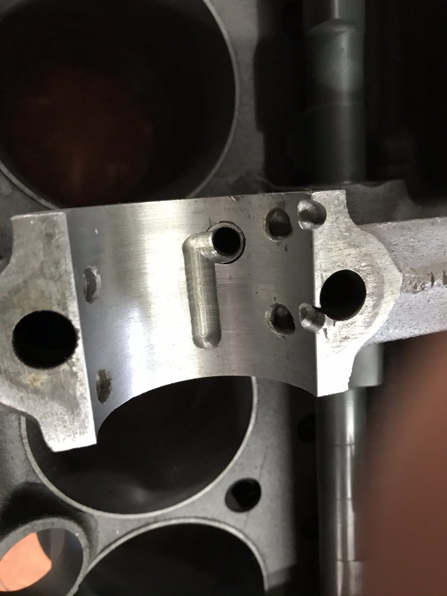

    My engine guy is adamant there would not be enough oil from the one centre hole in the **** crank on front and centre mains so has milled the trough in the block below the bearings and plans to mill a few thou of the centre side of each bearing. Are we over thinking things. The willys jeep Rear seal Housing we made is a close fit with the bolts holding it on ,we may remove spring washers and use star washers .Its locked in with roll pins also.

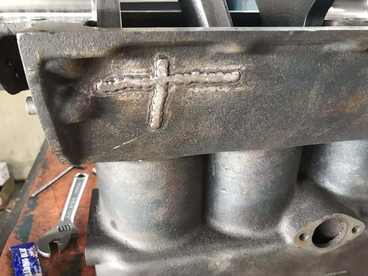

    This was the only crack in the block, maybe something was dropped on it? C7227F3B-AF8B-461D-992E-95B0E7C9818E.jpeg 5192AD31-FEC0-4C0C-A8FD-619EABE9D184.jpeg A171DB4A-C155-45F1-A8FB-6C4A7BB0CC7A.jpeg 53D0A30B-F802-4C40-9091-C8F8526D6B48.jpeg A70E8DC5-4725-40B1-ACB4-001F3A85C8C4.jpeg AB05EC50-BB82-424D-8996-39C3F3669A92.jpeg F9D075D8-FDF8-4D1B-B9B0-167B1E951F7A.jpeg

  19. Kiwi,
    It sounds like your engine Guru is pretty good, I like the rear seal housing.
    And he is right, the oil p***age under the bearing shell needs the trough.
    Relieving the bearings to make the oil groove is very important, to feed the rods. Some I have seen used a single shell, not completely using all the length of the bearing but aligning the groove to the crank oil feed hole.
    Looks good, keep up on the pics, J

    @Kiwi 4d
    I'm not aware of any failures, in my experience, from over lubrication...
    My guess is the break in the block was from number four rod trying to leave the scene.
    Let us know how it runs.

    That makes more sense trying to put a leg out of bed as the rest of the block was nice. We only got a bare block so no knowledge of carnage.

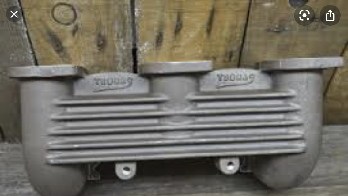

    979335E3-2391-4176-B8CD-AD5E671AE017.png Wanted Triple carb intake.
    In search of a triple carb intake for a banger. Looking for a Thomas but I am open to other makes. Please let me know if anyone has one they are willing to part with. Thanks.

    That Thomas 3x2 is cool...

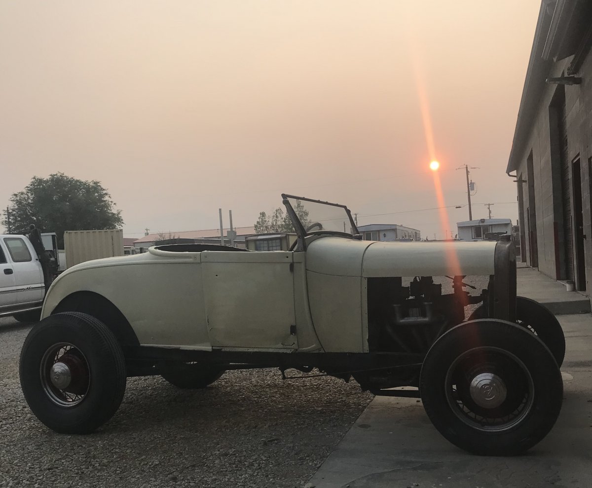

    7BEC119B-C892-4F85-9F4A-2BEF3A9E8D5D.jpeg Color change on the ol' roadster. I like it, but now I really need to do the bodywork! Going to mess with rhe Tattersfield I got this spring. No throttle pivot boss or vac.port, possibly pre-war in my searchings...Looks like it could be set up to work real well progressive.
    Rear wheel is a real dark red. I think I like the combo...I'll get more better pics tomorrow
