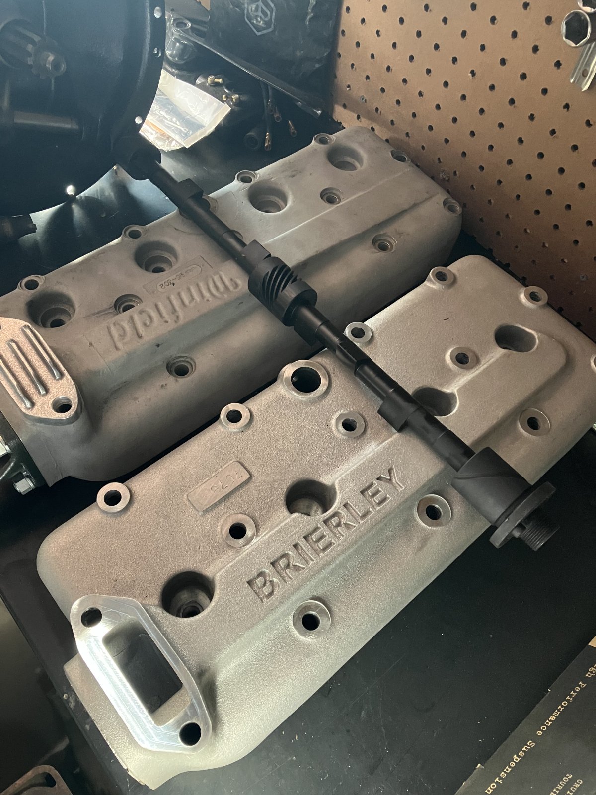

    No progress. Saving money for my engine rebuild.
    I did get a new cam from Jim Brierley though.

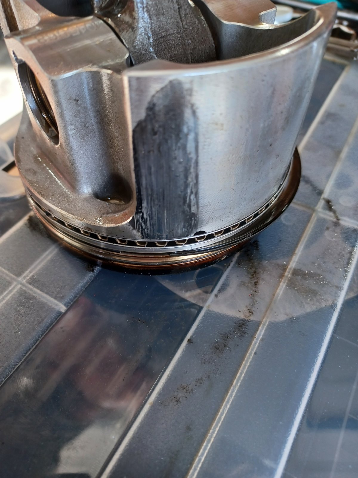

    "400 miles on the Burtz block and still going strong."
    Did you determine the cause of the piston failure??
    4BangerDean and Old Dawg like this.
  15. At Laguna Seca Raceway; coming down into Turn 11. Though I did set the 4th fastest time of 20 entries in practice; I had a few missteps that put me back in the final tally! First one was the snap ring in the right rear hub (the one we had worked on) came loose; and second, I ran out of fuel on the last lap of our main event! All in all, however, the car ran very fast. This is the best engine we've had in this car. (It was running so fast that i put the rollbar back on the car!)
  16. Crazydaddyo
    Joined: Apr 6, 2008
    Posts: 3,372
    Crazydaddyo
    It wasn't one thing, but the piston got too hot. A combination of lean jetting, timing advanced, and too much oil drawn in through the intake. The oil was drawn in from the PCV set up I installed. There was a lot of carbon build up on the pistons. The lean condition and timing was causing detonation and the carbon was retaining the heat that made the piston swell.

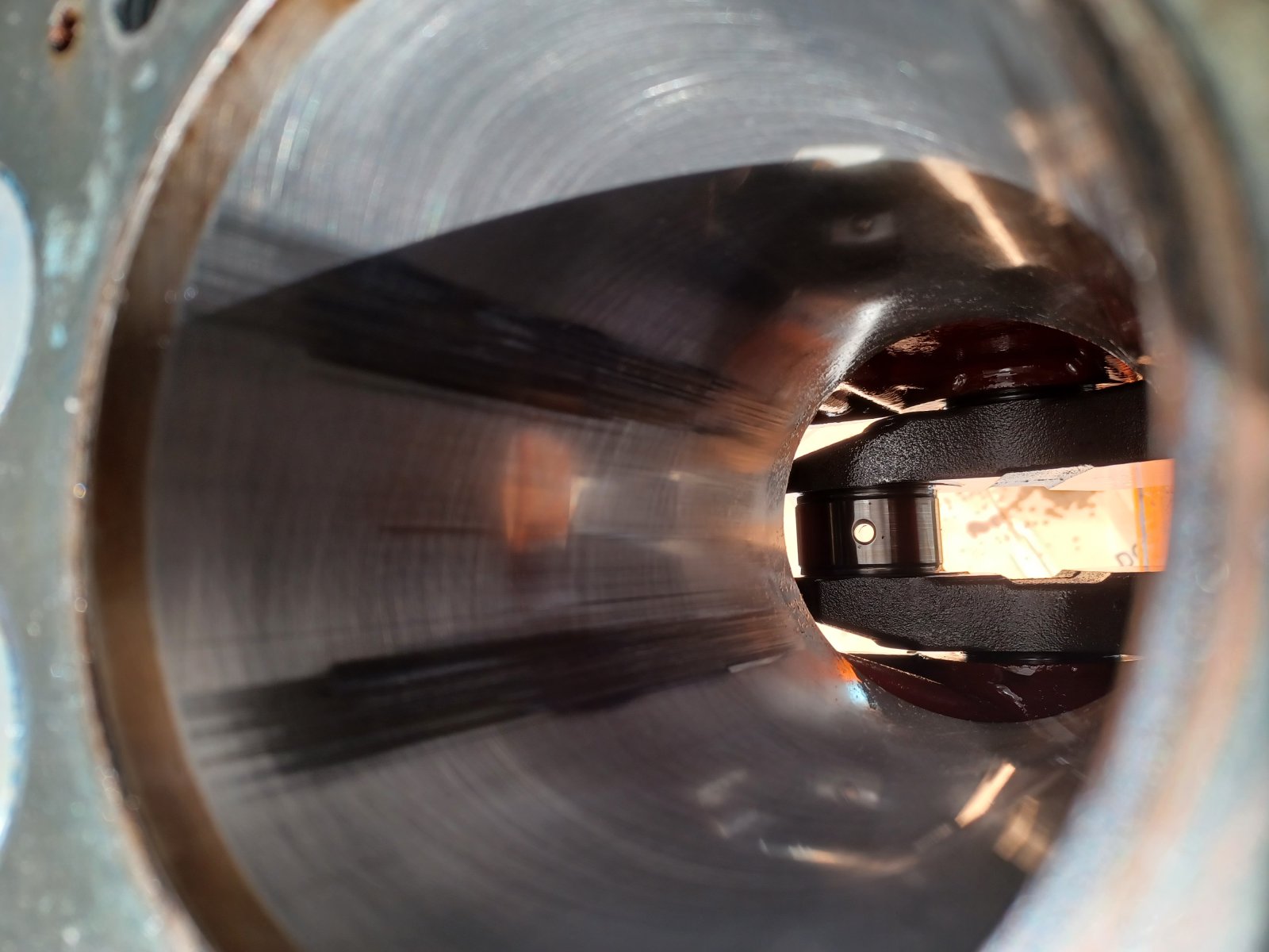

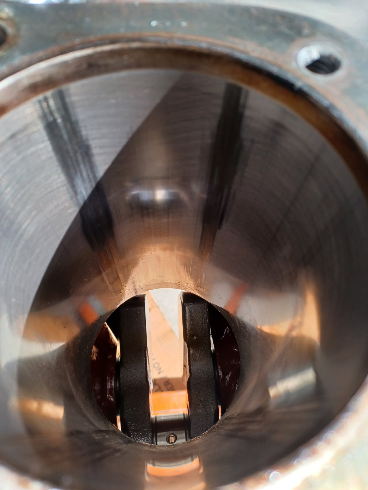

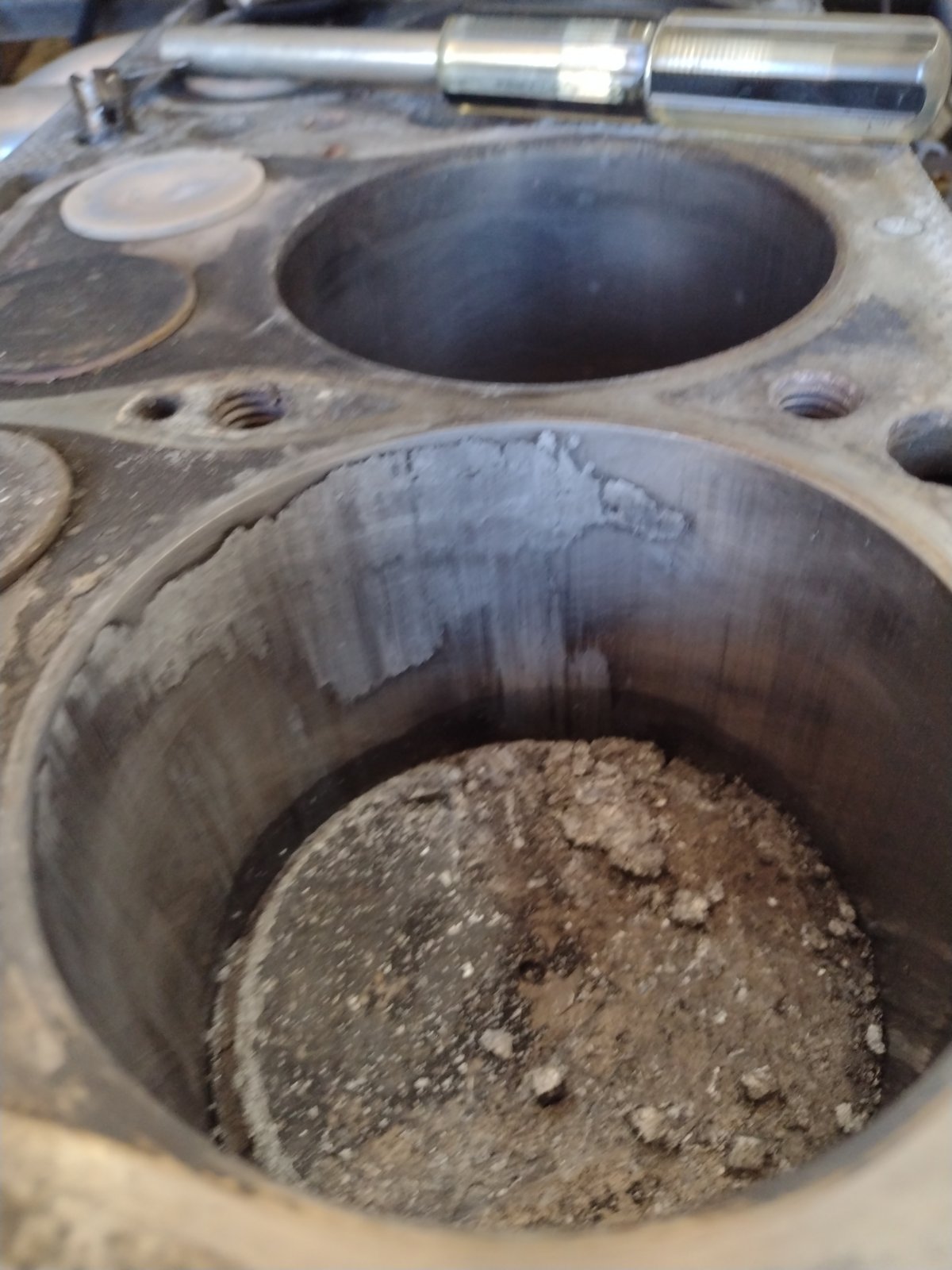

    Oh...I missed this chapter. I had taken a trip to Denver, in the Bertz powered Vicky. I ran the return trip of over 400 miles with a 45 mph headwind at 2:00. The aerodynamics of a brick ....barn per @hotrodfil I kept it wound out in direct and sometimes into third with my foot in it the whole trip home. I had a rear main leak and pulled the engine to address that. I have to pull the OHV first in order to pull the engine and when I did I had scoring from the rings, in the cylinder walls. I suspect that lean condition contributed to the condition along with ring gap, that I had at .018"
    It cleaned up with a .020" cylinder bore, new pistons and rings with the top one gapped at .024" as it appeared to be the only offender. I am running 31 degrees total timing but at higher al***ude with no signs of predetonation
    But this is a different story of lean condition.... and it was something else when it came apart.... IMG_20230612_074306207.jpg
    Crazydaddyo likes this.

  24. Crazydaddyo
    Joined: Apr 6, 2008
    Posts: 3,372
    Crazydaddyo
    Ouch.
    This was my piston issue
    winduptoy likes this.

  26. Dan from Oakland
    Joined: Jan 16, 2009
    Posts: 247
    Dan from Oakland
    I wonder if a different cam grind on the pistons would have helped?? One would ***ume the piston guys had that all figured out. The pattern sure is even. Does not look like the thrust surface was scored at all. Another thought, as the piston was getting hot, my guess (caution here) would be that the thrust surface would get unhappy long before the piston went out of shape enough for the corners to score like that. I ***ume you had enough clearance. I've found that with only a partial water jacket, sometimes things need a little more clearance, but this is still puzzling me.
  27. Crazydaddyo
    Joined: Apr 6, 2008
    Posts: 3,372
    Crazydaddyo
    All clearances were good. #1 piston was the only one that had heat distortion and only the skirts. The cylinder walls were still round and the scoring was only piston material transfer. There were no signs that the cylinder was starved of oil from the bottom either. The new pistons have a coating on the skirts to reduce friction.
    Old Dawg, G Baese and winduptoy like this.
  28. Dan from Oakland
    Posts: 247
    Dan from Oakland
    "Things hate people" !!!!

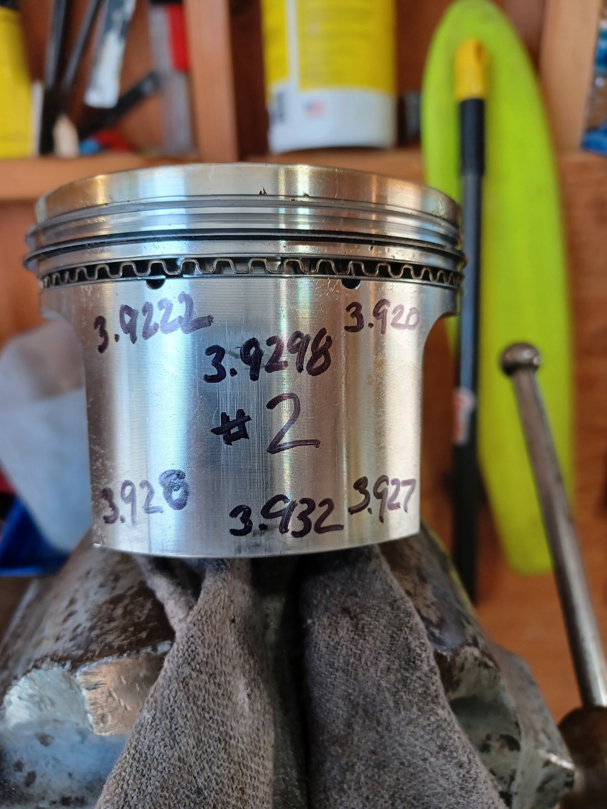

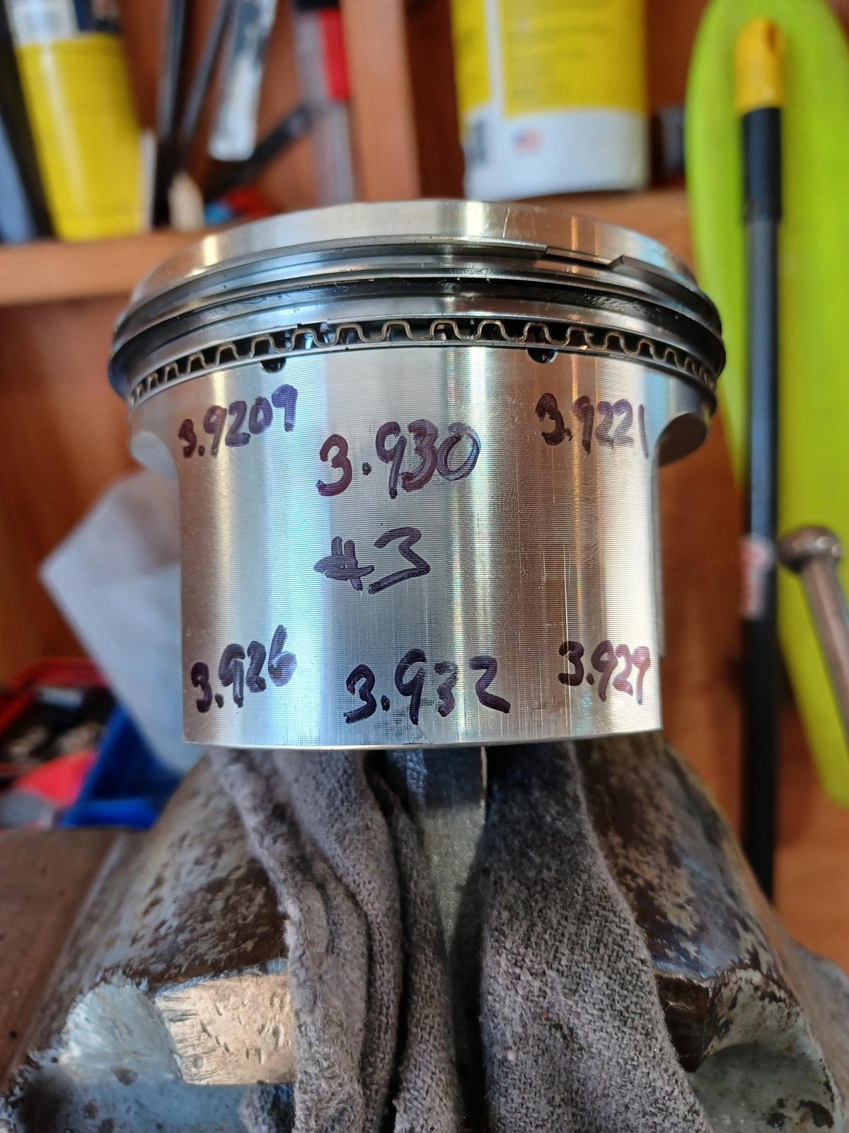

  29. If I can offer an observation to CDOs piston scuffing
    The dimensions measured after the scuffing would indicate the bottom skirt may not have enough cam in the shape of the piston
    However the dims up closer to the rings may indicate just an overheated piston
    As the piston heated up it expanded along the web of the pin bosses resulting in insufficient clearance
    Once cooled down it returned to shape/size
    Have never witnessed this before it usually ends up with pieces left in the pan or on the track
    In any case he is very lucky to not have had it become terminal
    J
  30. Crazydaddyo
    Joined: Apr 6, 2008
    Posts: 3,372
    Crazydaddyo
    I agree.
    I'm glad I was on a leisurely Sunday drive instead of driving it in anger at the track.
