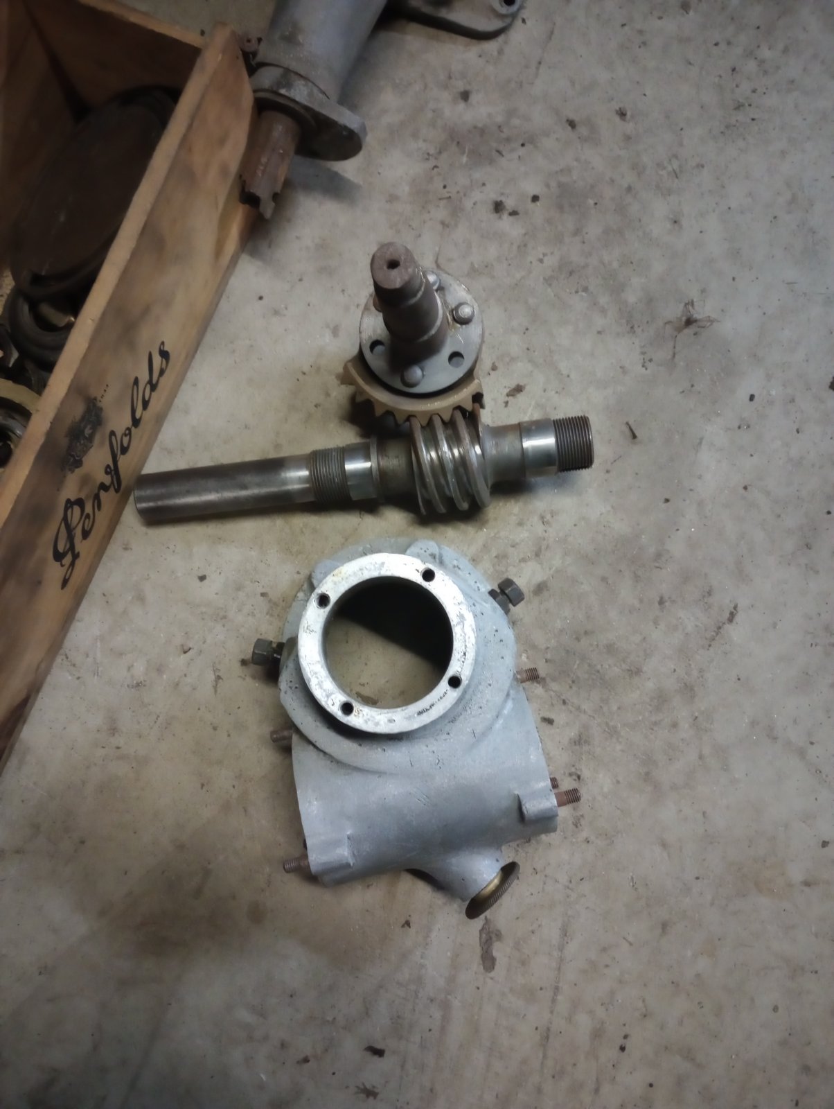

    I picked up the Vauxhall 4 banger yesterday, it's early 20's, 2.3L (140CI) produced 40hp it has a counter balanced crank, full pressure bottom end.
    It has a factory relieved block with canted valves,
    The plan is to improve the carb/ exhaust (the inlet ports are nearly the same centers as an A) & bigger cam, lightened flywheel etc & put it in the T roadster I recently bought, it's about 50mm (2") longer from fan to Bell housing compared to an A & the rear engine mounts are the right width for a T ch***is. It also has a 4spd gearbox.
    The plan is run a model A diff & t front axle, steered with the Vauxhall steering box.
    This will be a longer term project, I have a couple to finish plus the usual ongoing maintenance. These Vauxhall's has a top speed of 60mph, so even stock should move a T along rather well. IMG_20230907_203315253.jpg IMG_20230907_203334961.jpg IMG_20230907_191648582.jpg IMG_20230907_213211.jpg

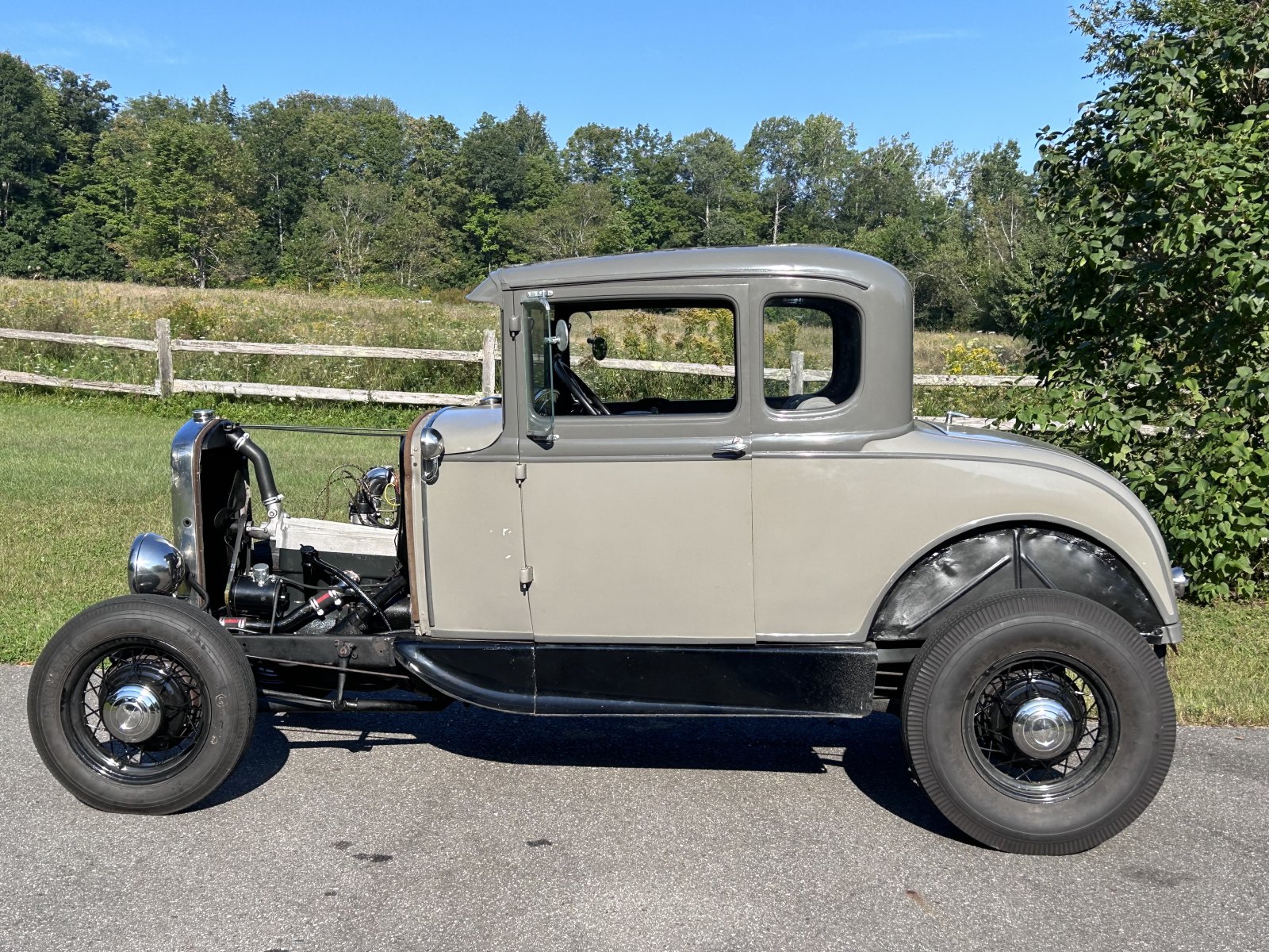

    Motor swap complete and off to Pine Tree Jamboree next weekend.

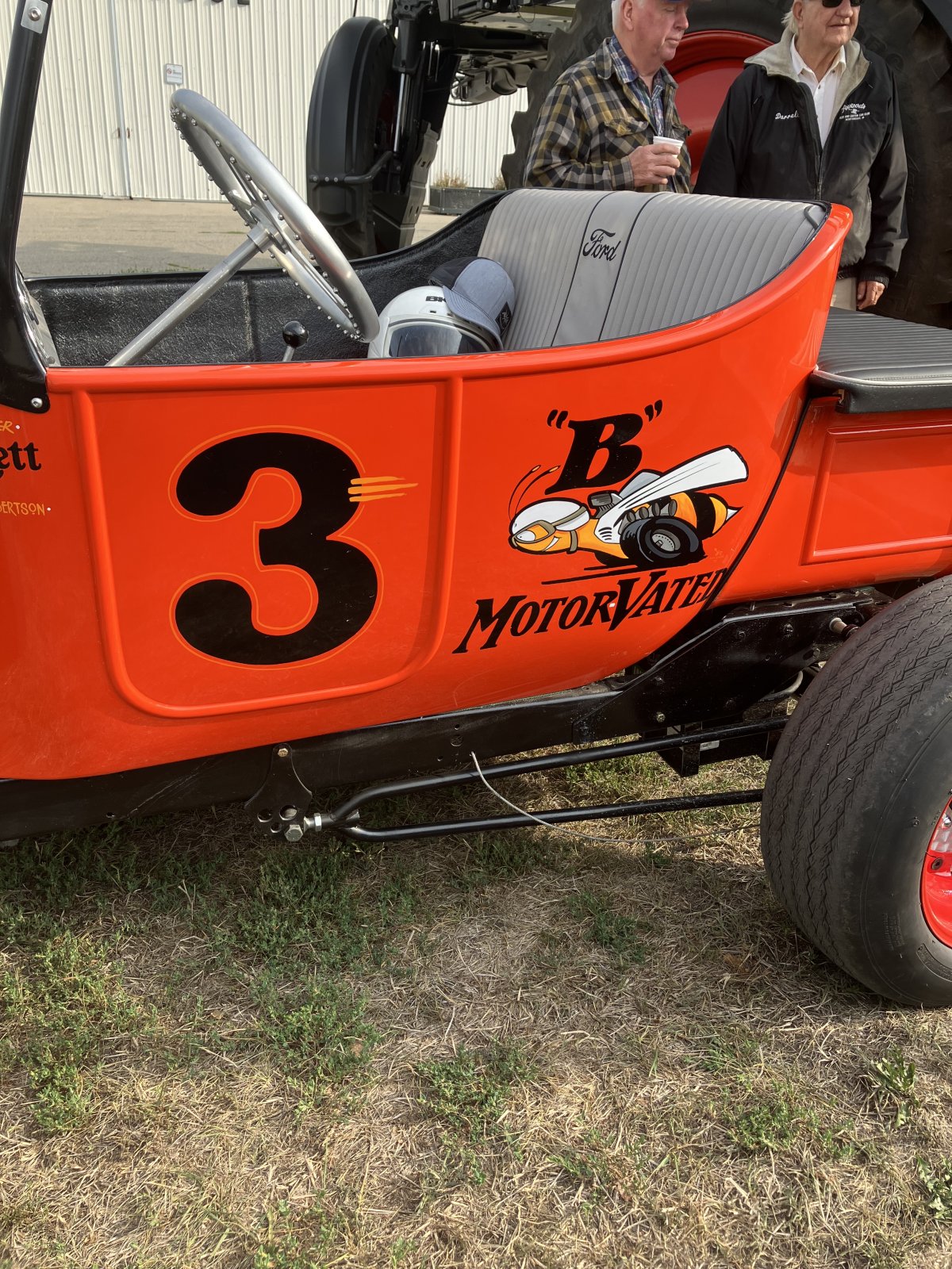

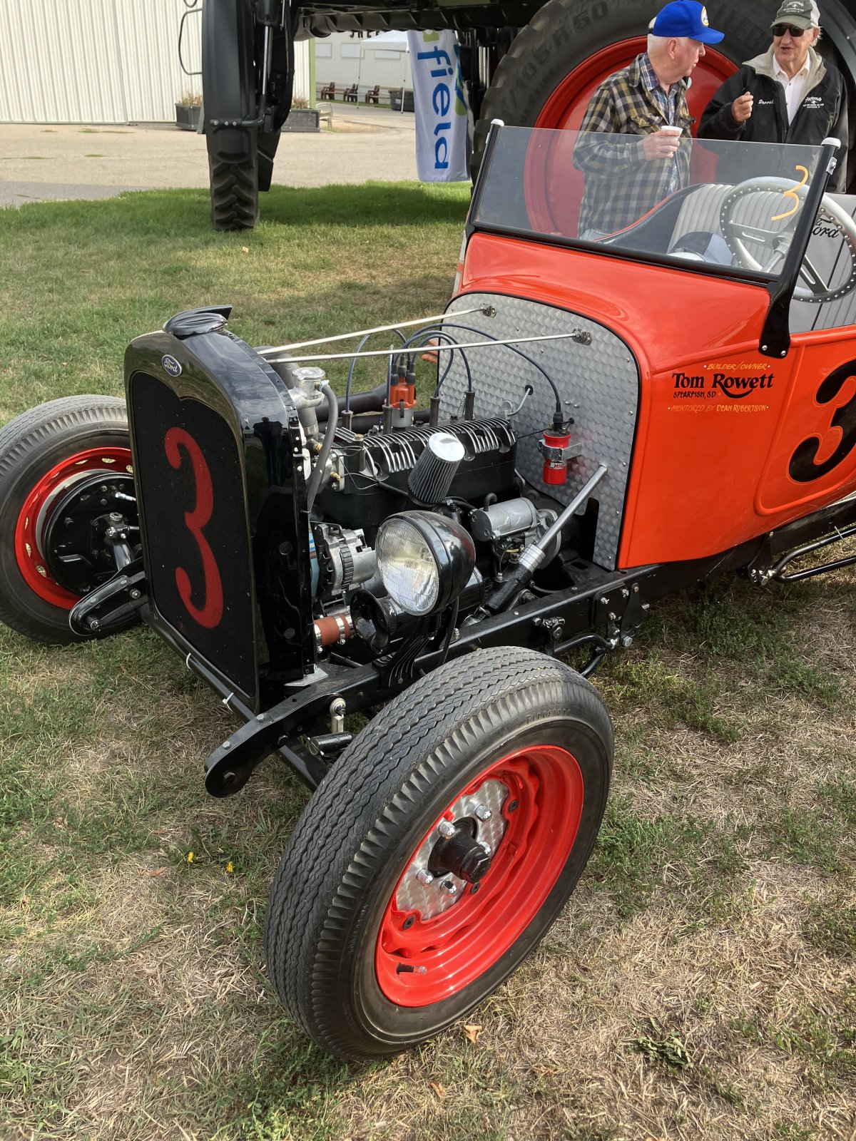

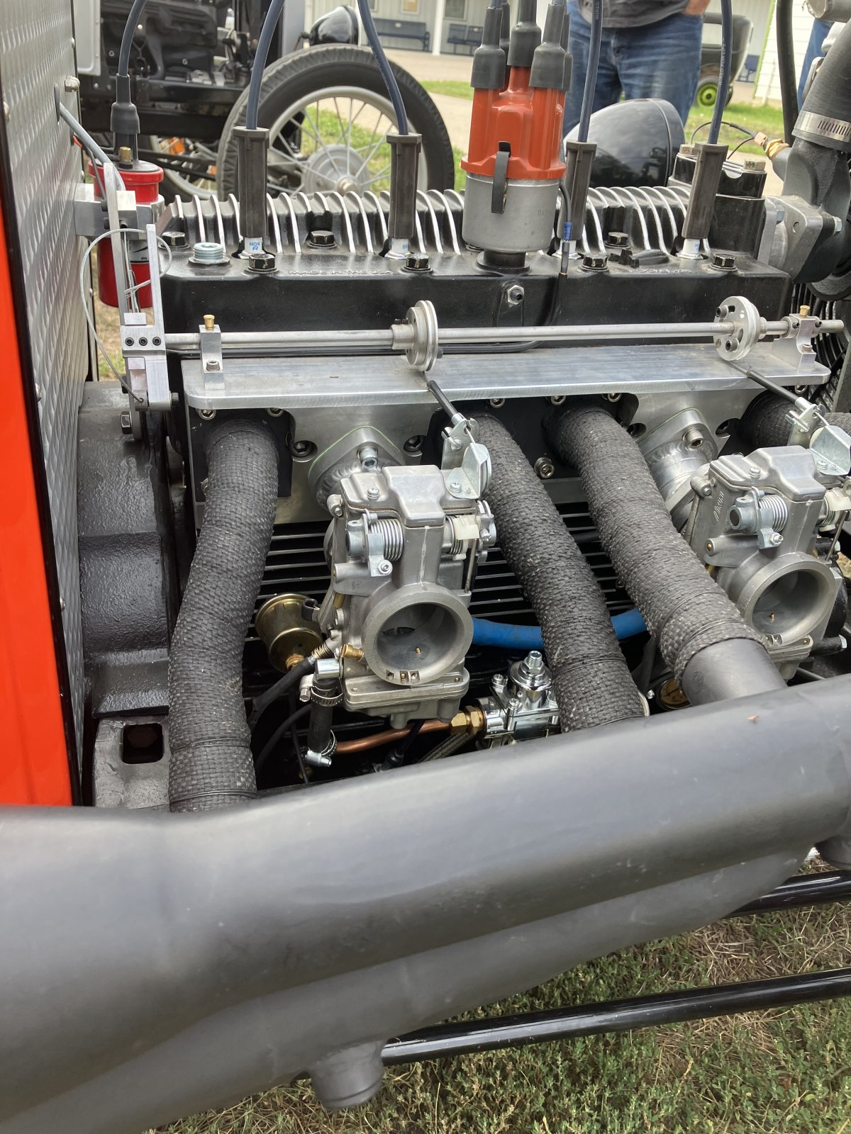

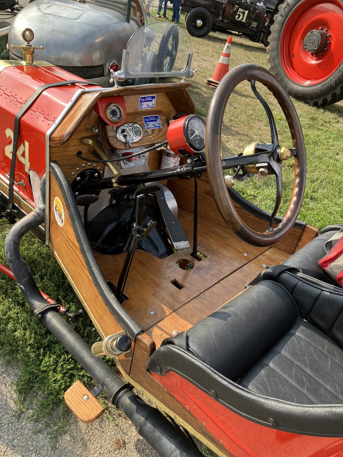

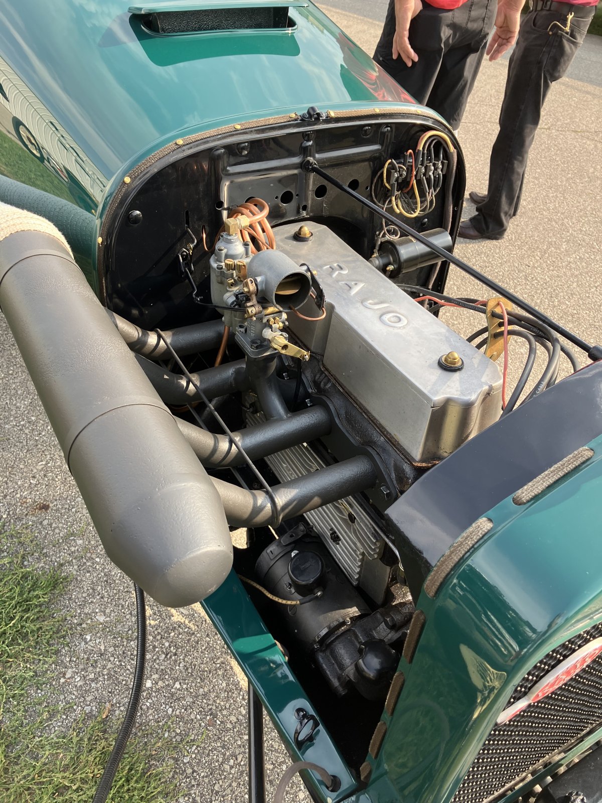

    Todays King of the hill at the F A S T Iowa Hillclimb. 44 mm flat slideMikunis the manifold and valve cover plate, were machined in one machine piece with the oil galley and an external pump driven by the side drive. One more of Dean Robertson’s crazy concoctions, he helped Tom Rowett build and tune, they kept after it in the pits until it the last two runs was in the eight second range for King of the Hill

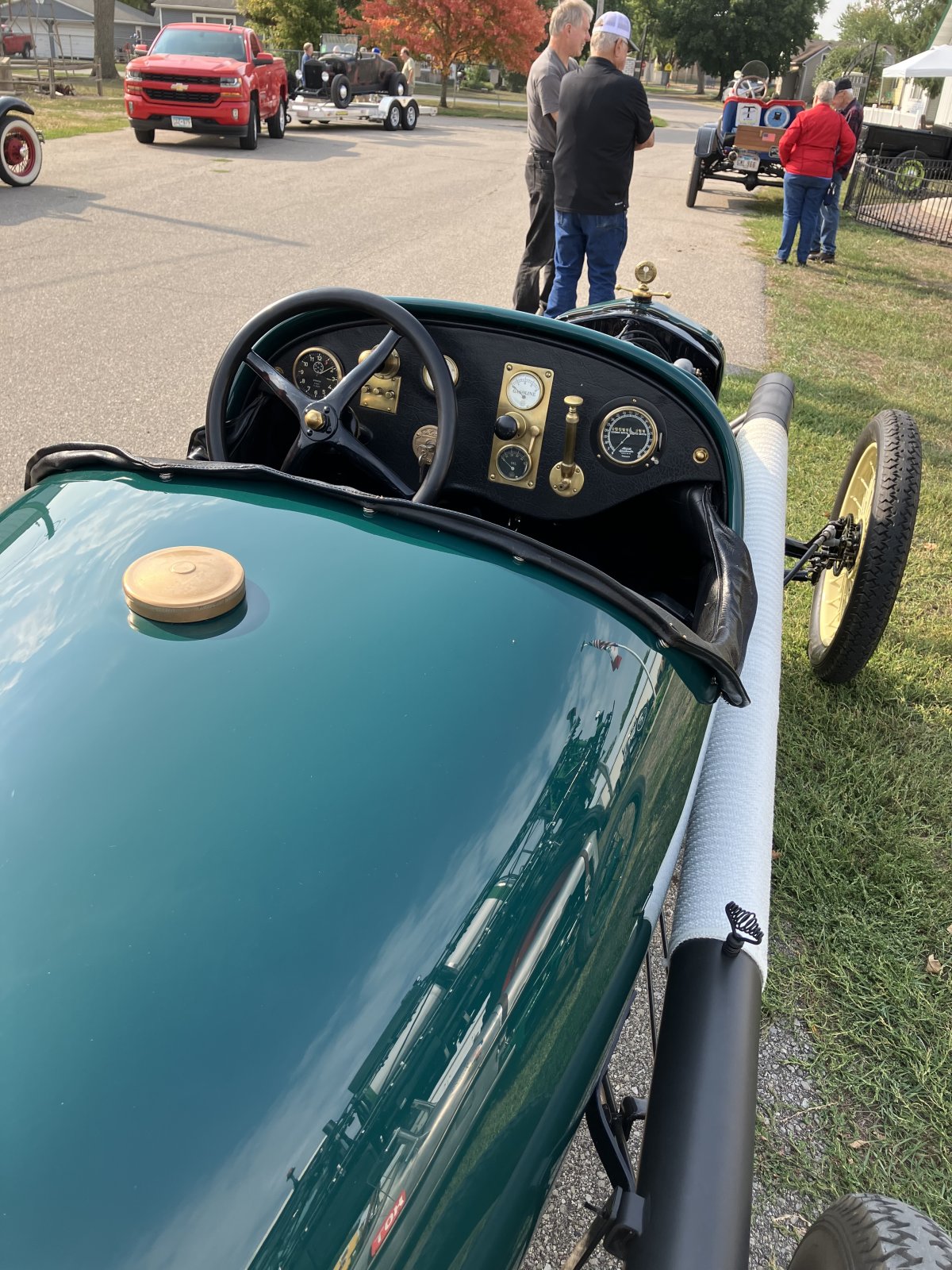

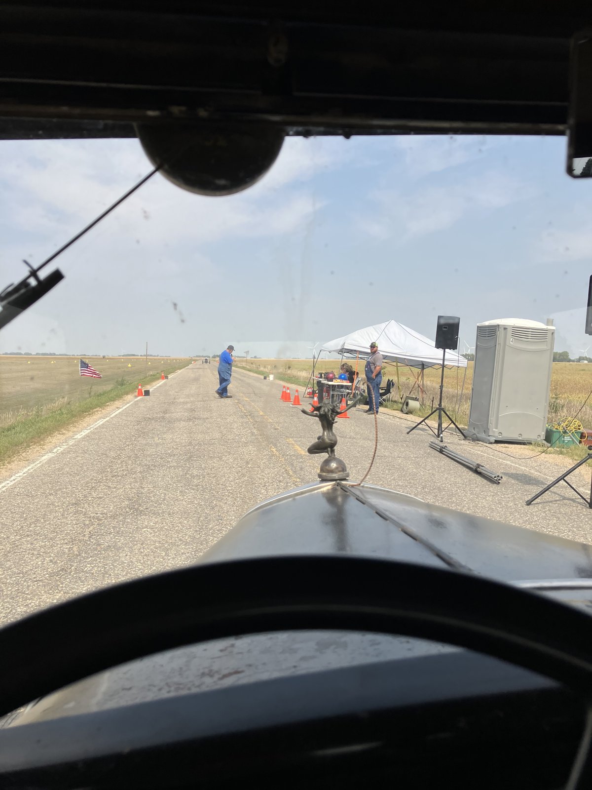

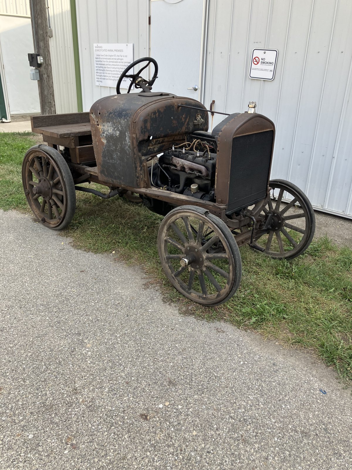

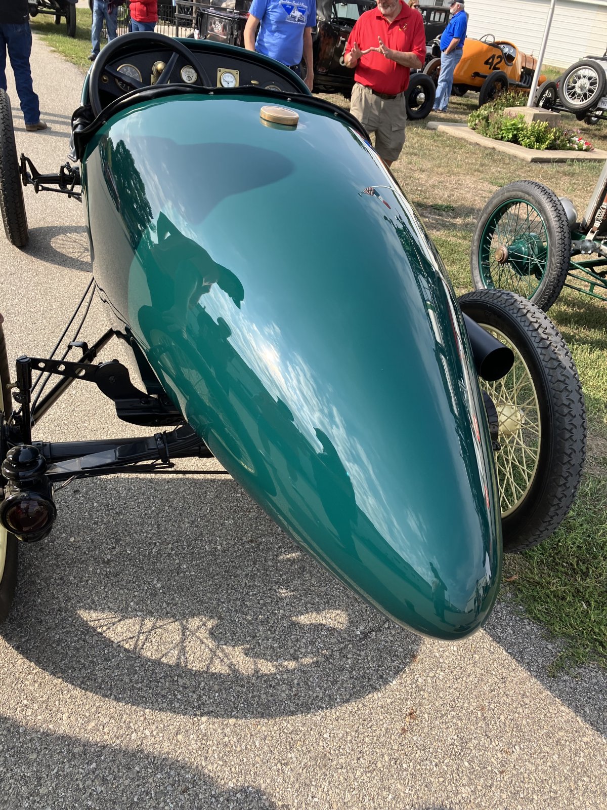

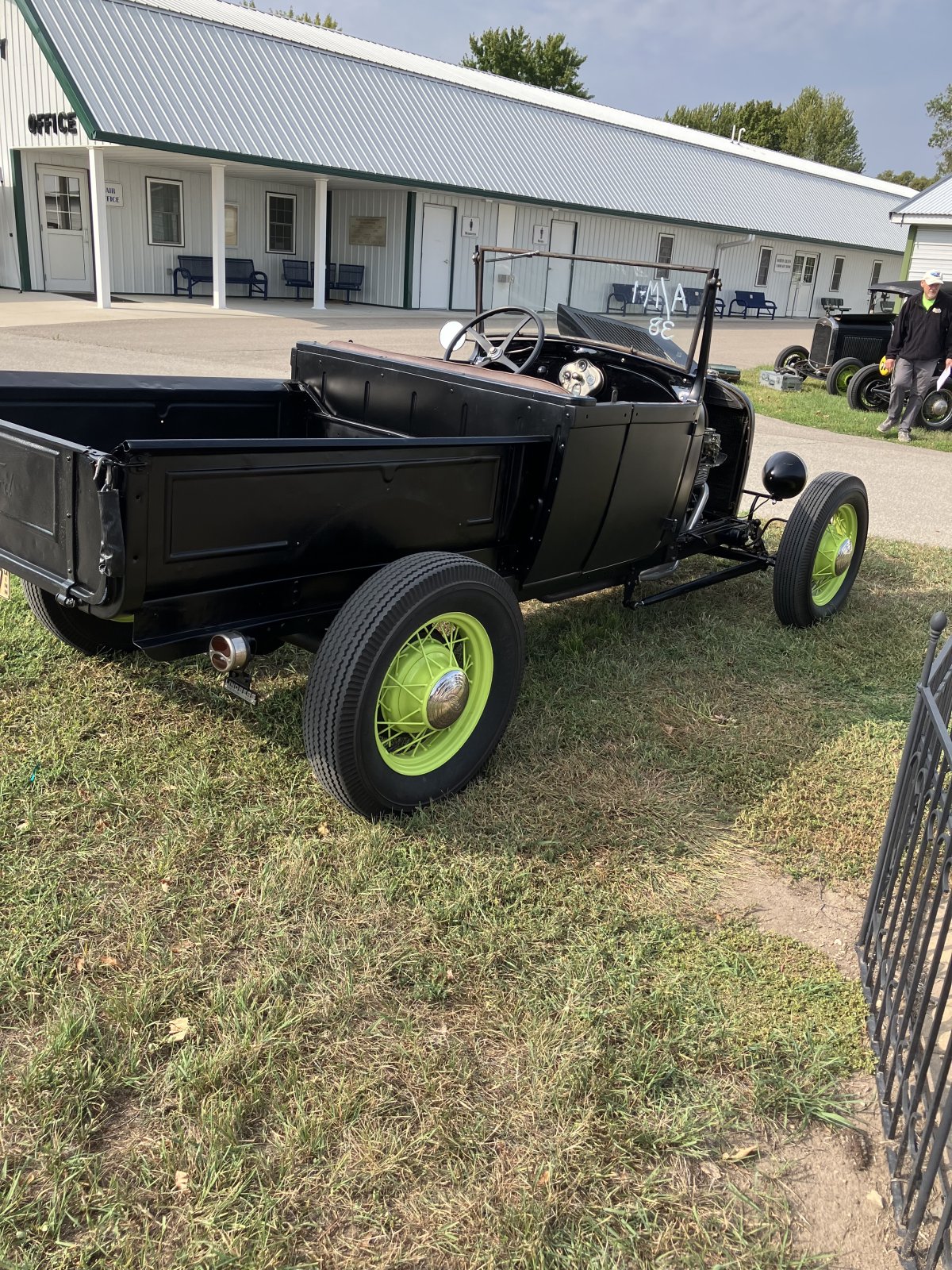

    A few more photos from today.

    That's quite a machine, what is the head?
  13. brjnelson
    Joined: Oct 13, 2002
    Posts: 636
    brjnelson
    Charlie Yapp's Rocket head
    winduptoy and Outback like this.
  14. Outback
    Joined: Mar 4, 2005
    Posts: 3,443
    Outback
    from NE Vic, Oz
    I hadn't seen one before, same combustion chamber as the Lion Speed head?

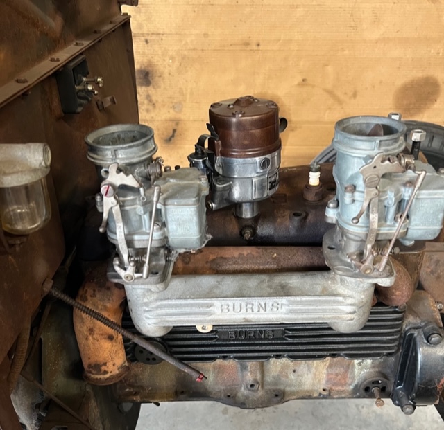

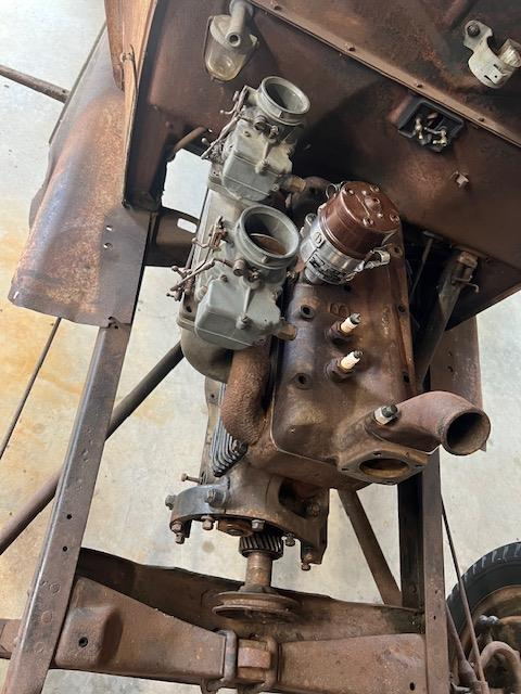

    Slowly getting my project closer to the fual/air phase of the build and did a quick mockup this last weekend. I've got
    a POLICE "B" head, stainless cupped valves, adjustable lifters, and a touring cam with a Burns intake and two 97's.
    I really don't like electric fuel pumps and was wondering what mechanical options are out there for bangers?

    carter P9091 rotary electronic pump puts out a consistent 2 psi.. no provision for a cam operated fuel pump on a model a engine 1618.jpeg

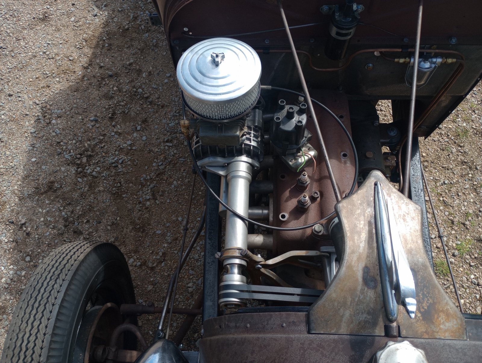

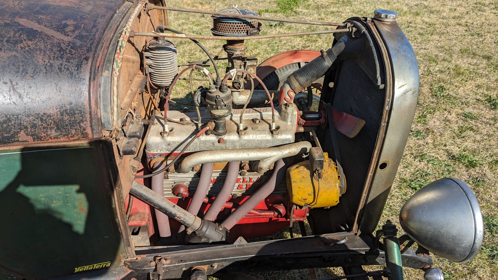

    Another unusual mini supercharger setup, seen today at the Model A 95th birthday in Gulgong.

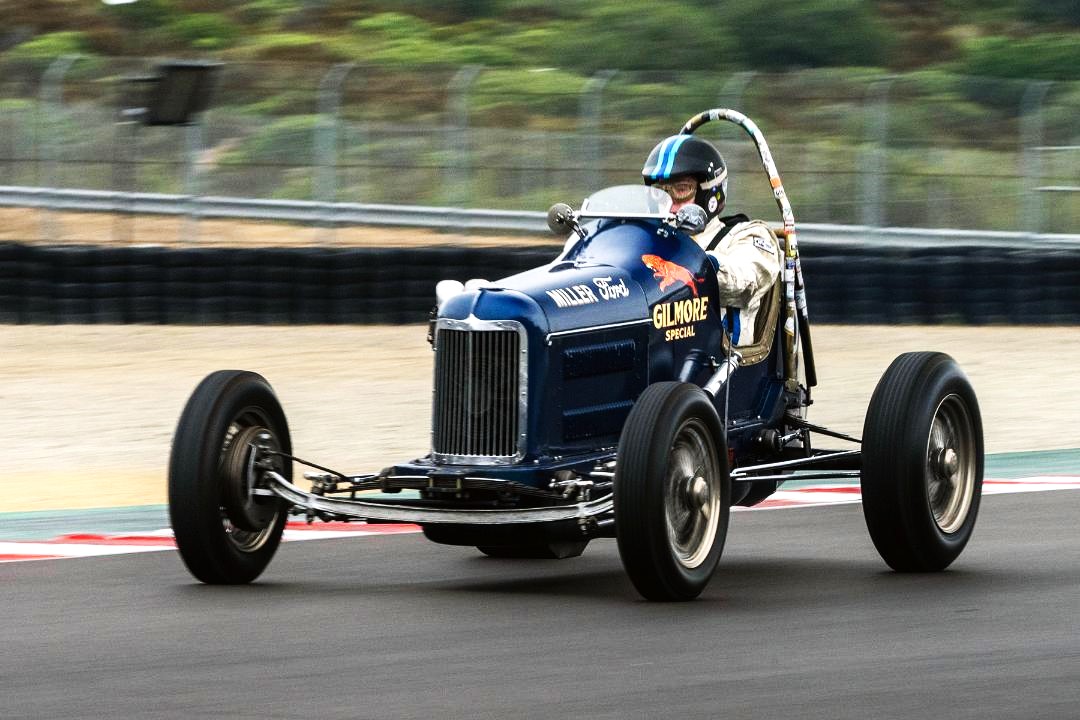

  28. Coming off the hill, down to Turn 11 at Laguna Seca Raceway. I was way off my best time as tires were going off fast! 2023RMMR(4).jpg
