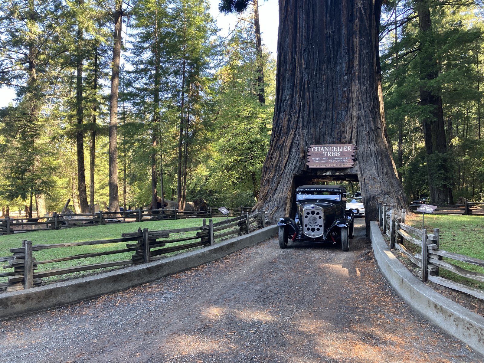

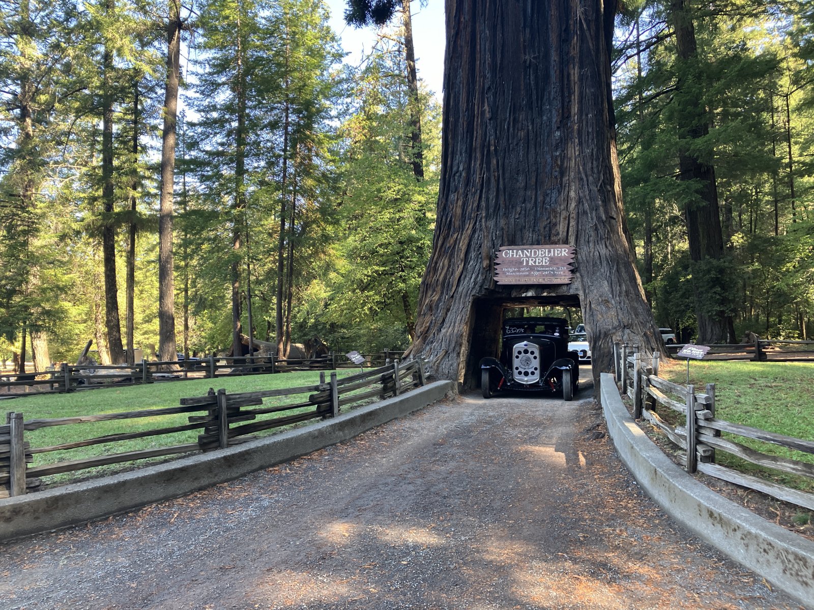

    Had to unload and drive the hot rod through the Chandelier Tree on the way home from RPM Nationals.

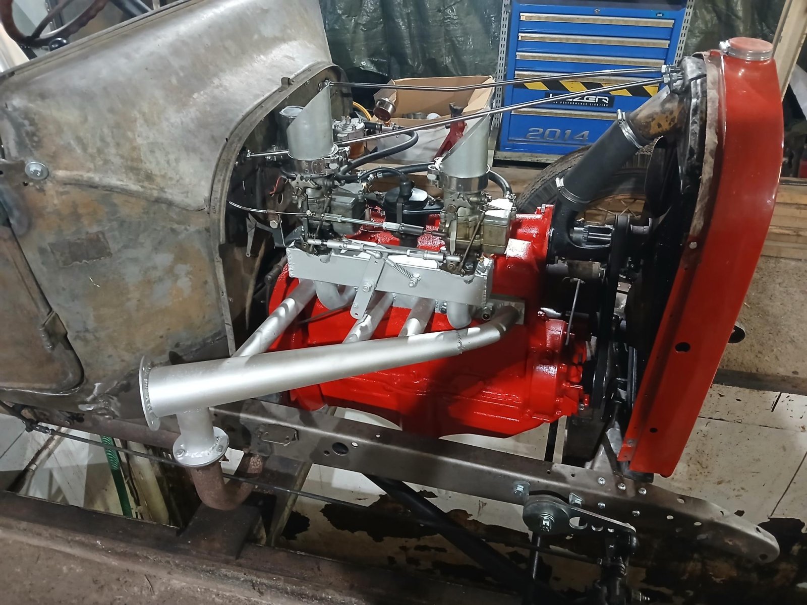

    I found this timing tip somewhere, i don't remember where. Not really accurate, but this is how i did it:
    - Find the TDC with timing pin and model A timing cover
    - Turn distributor rotator so that it is NOT centered to distributor cap #1 cylinder lead, but rotators trailing end is meeting #1 lead. This should give you about 19deg advance
    As i said, not really accurate. Works for me pretty good. After running engine, i retard timing just little, cause starter had hard time to turn engine when hot.
    This is my set up: Model B engine, Head milled to about 5.2:1 compression, Lightened flywheel (about 14 pounds lighter than stock model B), Dual Stromber 81s and Model A timing cover (cause i did not have anything else!)

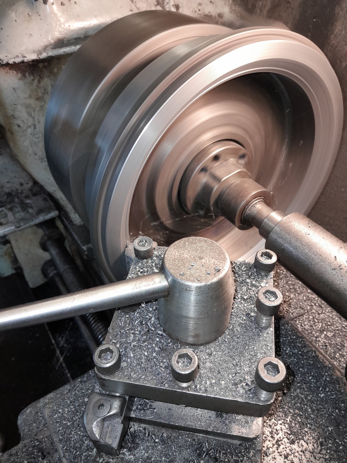

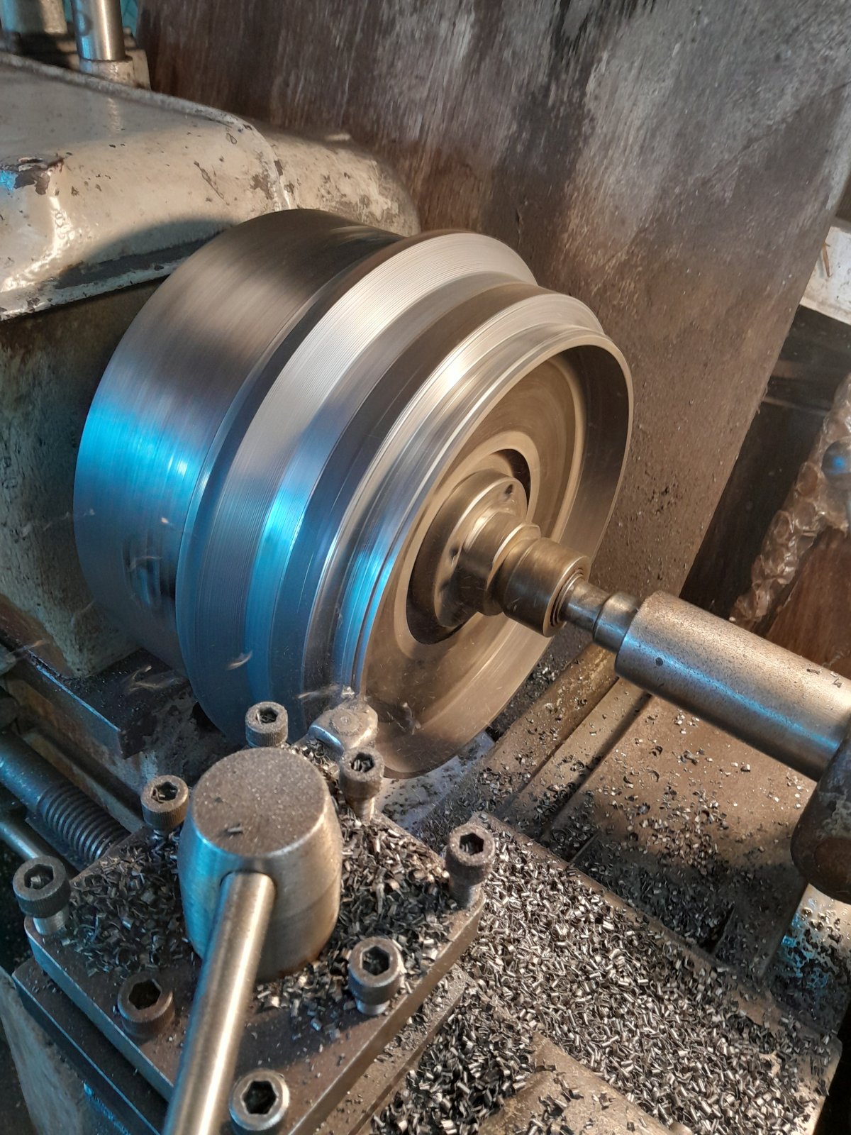

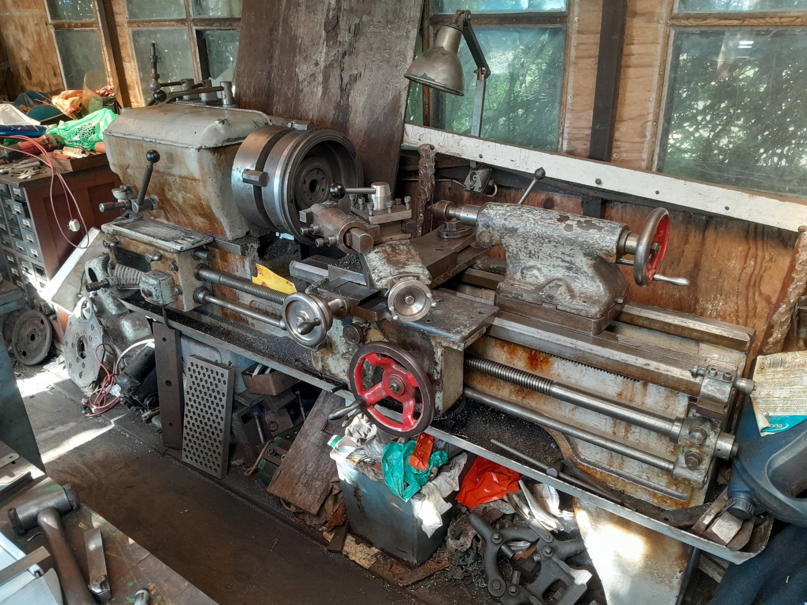

    I decided on a Burtz after all the sneaky cracks in my B block made them selves known, being over here I reckon it's probably the cheapest and most reliable option.
    Just spent a few happy hours on a friends big old lathe hacking the flywheel down to around 35 pounds.
    It was a bit of a hand full after my little Atlas lathe!

    When a lathe makes a flywheel look small you know it's a biggin!
