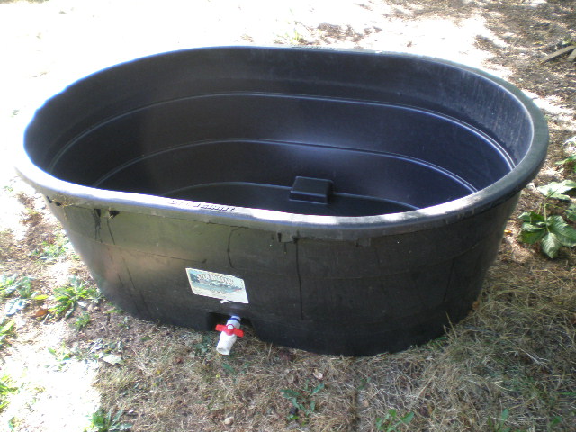

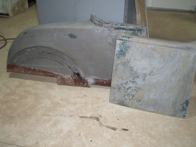

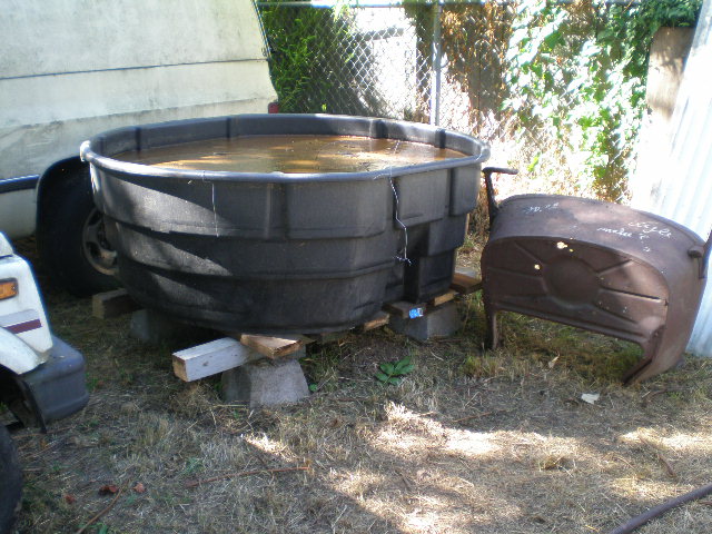

    I have the results of my first efforts with Mol***as. The pictures of the quarter panel and door show the results after 7 days in the tank. The tank was a 150 gal. plastic stock tank from a farm feed store. I poured 5 pails (3.5 gal. each) into it and filled it with water. I pulled the parts out after 7 days and rinsed with a water hose then hit it with air. They started to flash rust within one min. I brushed on a mix of 1 part Prep & Etch and 3 parts water and it stopped the flash cold and even reversed it. The parts have been sitting in my shop for the past week with no rust. The panels originally had some paint on them but were mostly rust. The rusty panel is one that I used a black stripper pad on and is the mate to the clean panel. The clean panel has a strip of rust along the bottom because the 150 gal. tank wouldn't take the whole thing. I have now bought a 300 gal. tank ($160) and five more pails of mol***es (see picture). I'm now soaking a '29 Chev roadster cowl, a '25 Chev roadster cowl, a Model A cabriolet door, 2 partial quarter panels and 3 or 4 other small parts. Life is great. :D The stripper Guys wanted $300 to do just one cowl.
    Prices:
    The Mol***as was $12.25 for a three gal. pail. If I wanted to drive 40 miles it was $9.99 a pail or $99.00 for a 50 gal. barrel.
    Prep & Etch $23.00 at Home depot.
    Evapo-o-rust $23.50 at Harbor frieght.
    The tank sizes:
    150 gal. 56"x40" @ the top. 48'x30" @ the bottom. 21" deep
    300 gal. 65" at the top. 60" at the bottom. 24" deep.
    I have four bodies that a junkman would walk away from so stripper prices don't make sence.
    I once made a lame attempt with electolisis and am sure I could do better, but I don't think I'll even try after this. My bodies can be broken down enough to fit in this 300 gal. tank so this works for me. A week+ wait is no problem. The stripper always seems to have a two to four week wait.

    Why is the tank elevated off the ground? I think I am going to do my coupe like this.
