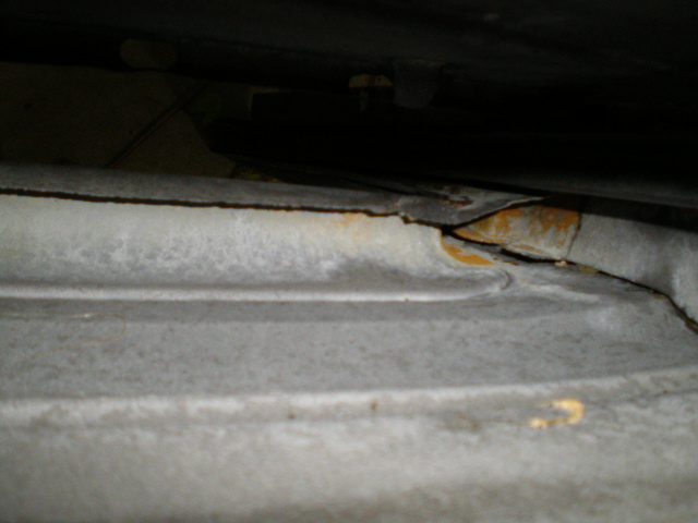

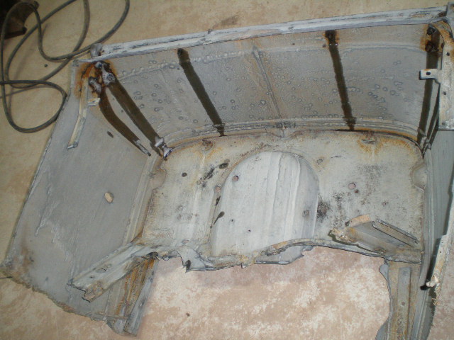

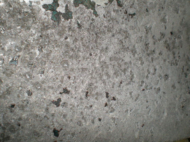

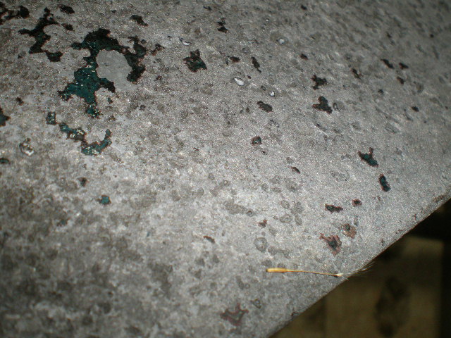

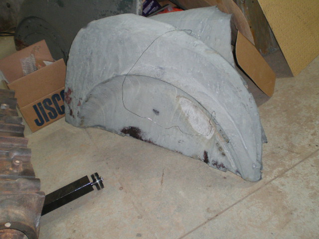

    Pulled the parts out of the "soup" after 7.5 days. Pictures show the results for the cowls and quarters. Had to put the door and back panel back into the mix. They were too badly pited to clean up in 7 days. Will pull again in 2/3 days. Also put in three quarter panels and another door. Pictures will show some areas that didn't clean entirely. This was caused by air pockets. The '25 cowl was laying engine side down on the bottom of the tank. I may finish cleaning with a wire brush.

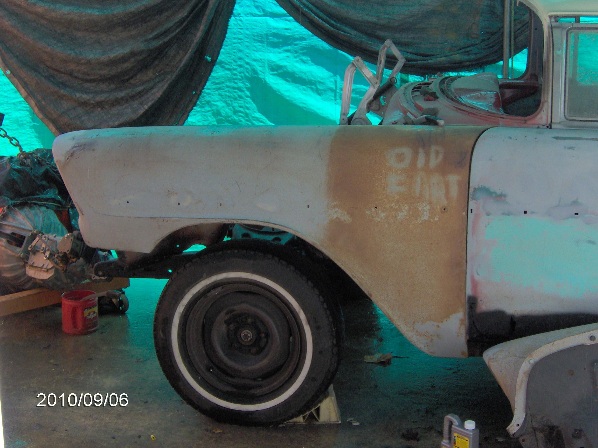

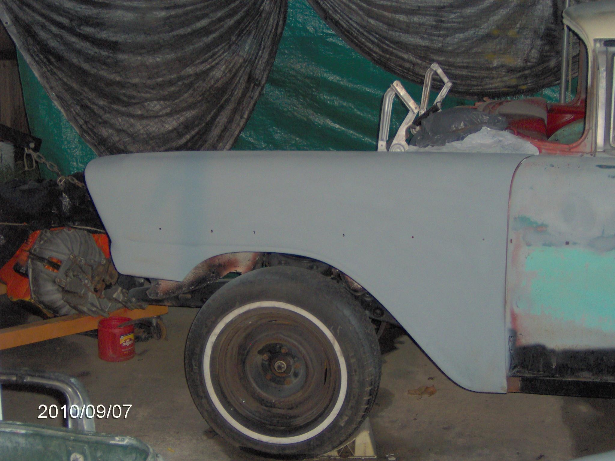

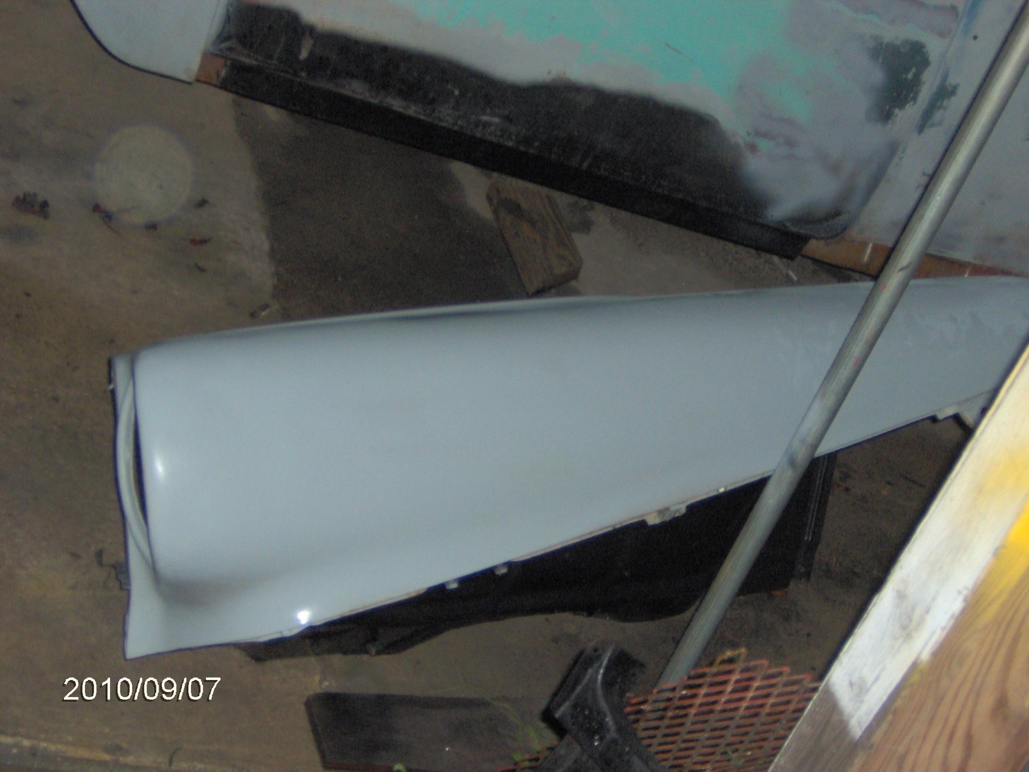

  17. My 56 was sanded primed then let to sit for years.It had surface rust all over the fenders.Someone suggested CLR so I bought a bottle $5.
    You can see the results after 3 applications.I put it on ,let it sit for 5 minutes then scrubbed it w/steel wool.Not too bad for $5. There was enough in the container to do both fenders.
    The last 2 pics are after applying new primer.

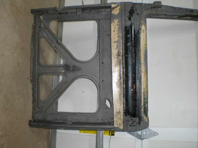

    Ok, four days later and the door and rear body panel are done. These parts were really bad. I wasn't lucky on the rear body panel. It has a number of very small pin holes and some very deep pits that could be holes. Any Ideas on how to repair. Anyway here are some pictures. check out the inside of the door shots. How about those pits.
