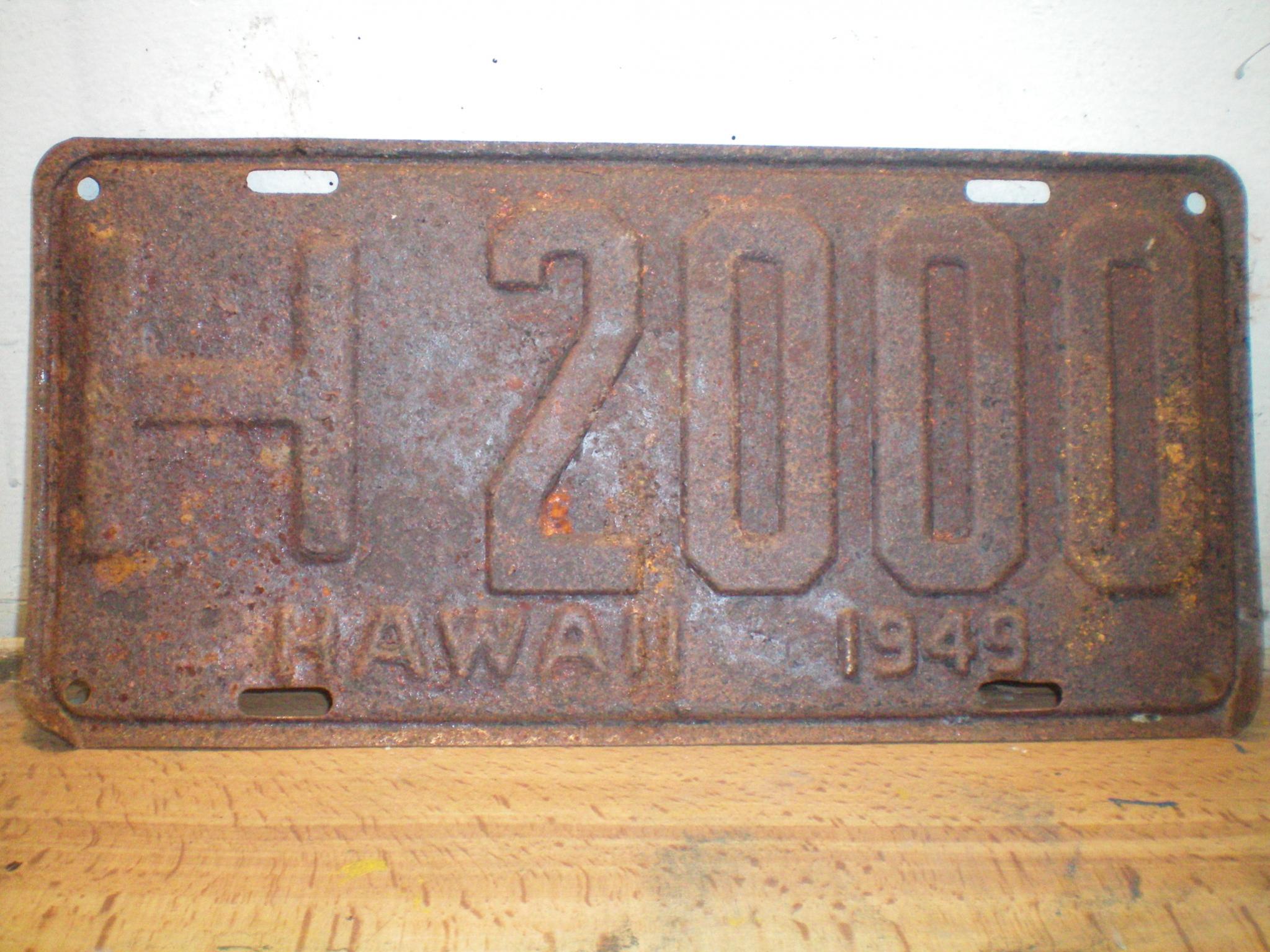

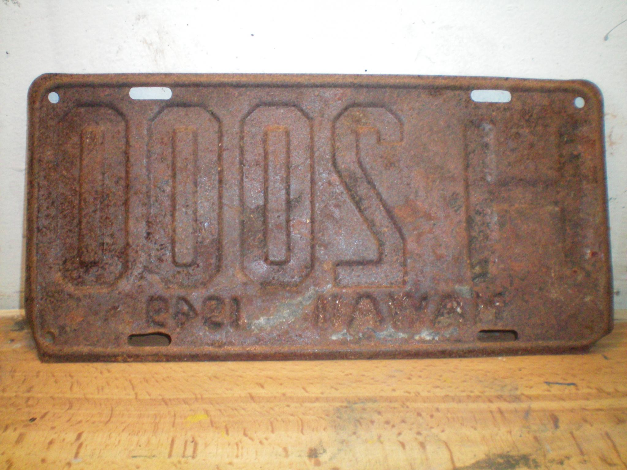

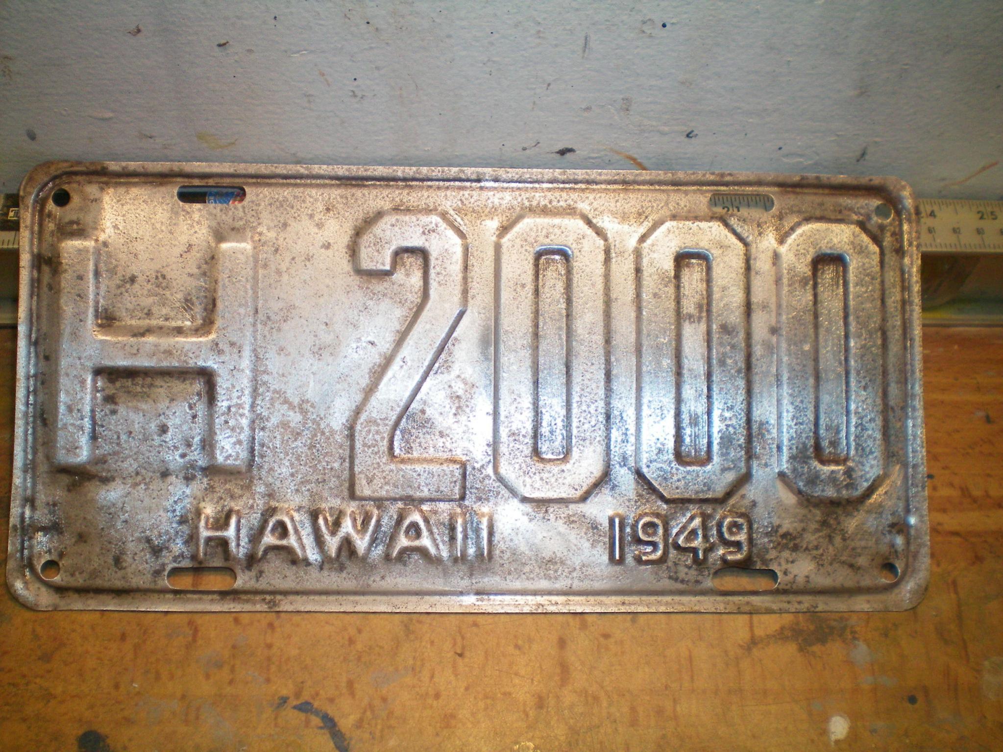

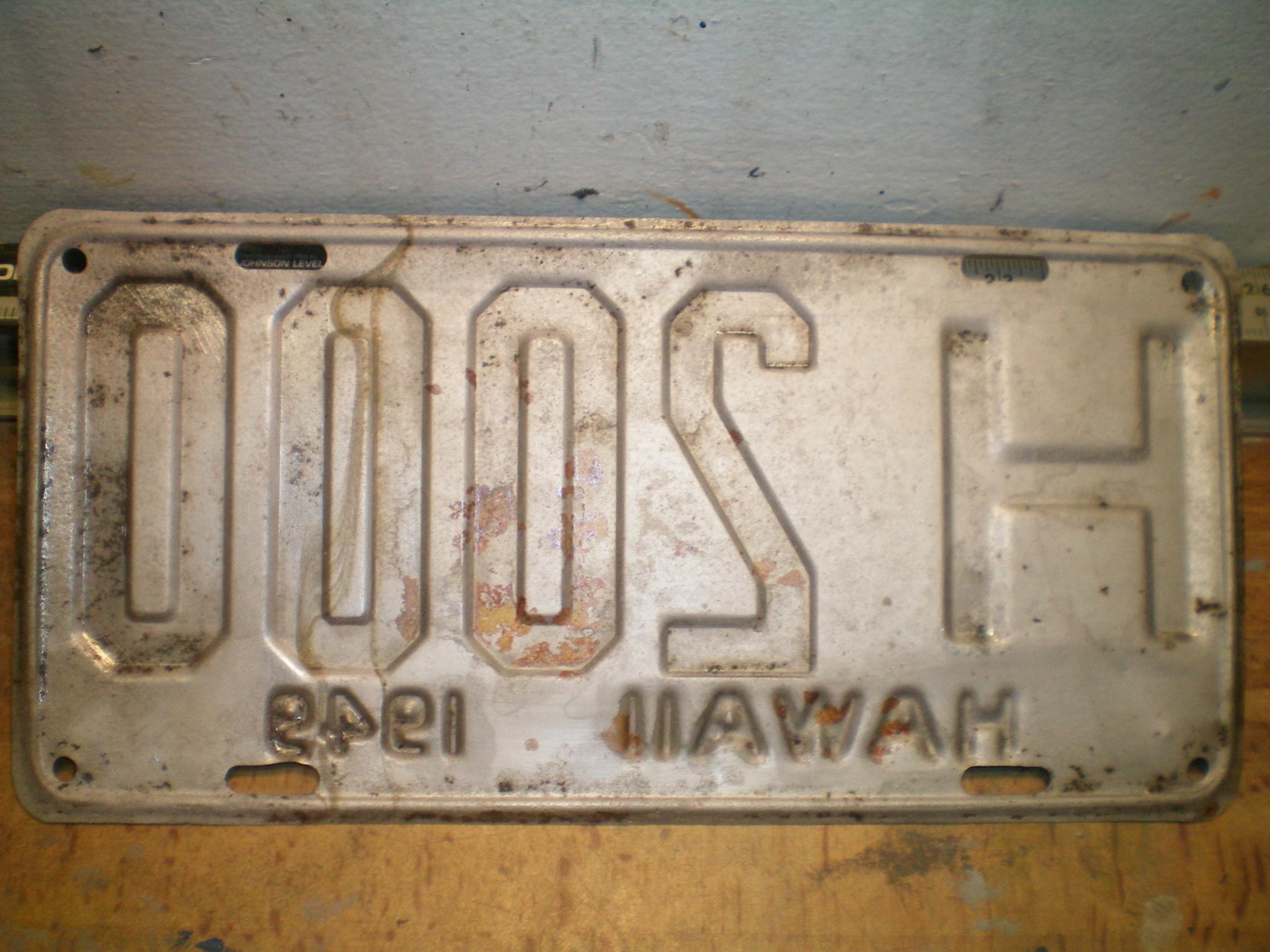

  9. CHECK OUT THIS SITE I USE FOR SMALL PARTS. IT C/B USED OVER AND OVER AGAIN. ALL THE TREE HUGGERS LOVE IT.
    CHECK OUT THE PHOTOS BELOW.
    MENTION I SAW YOU AT CARLISLE PA SHOW AND $5 WILL COME off OF A GALLON. I THINK HE SELL IT 5 GALS AS WELL. IT TOOK 3 OVER NITE BATHS BUT THERE IS NO LABOR INVOLVED.

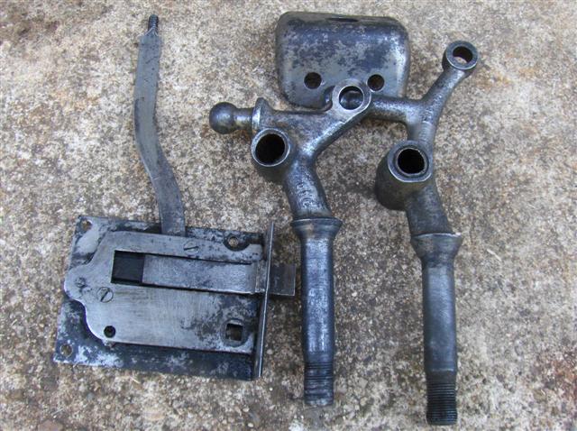

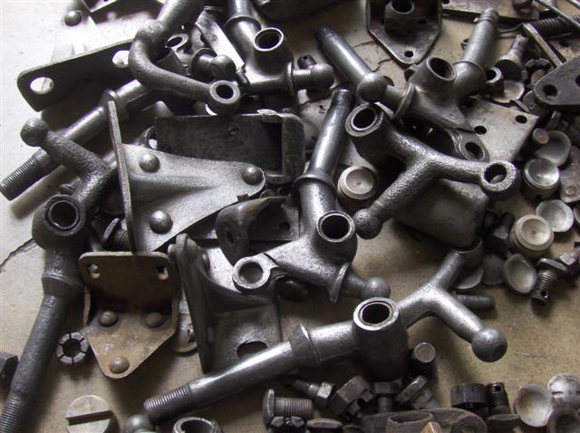

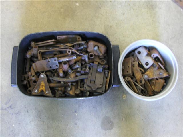

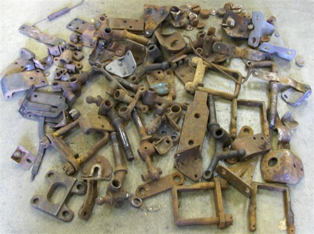

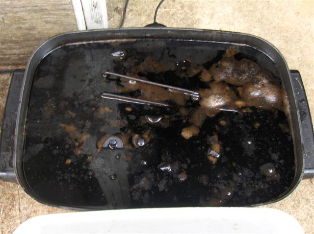

    I have been reading the threads about mol***es for awhile, decided it was time to try it out. Bought a 5 gal bucket of it from the grange $19.00 enough to do alot of parts. Picked up a rice cooker from goodwill, and i had electric skillet already. I used a mix of 1 part mol***es and 4 parts water, loaded up the parts and set them to cooking. Someone poster before that it smells like ethnic cooking, that's spot on, it has a kind of a sweet ****ey smell.
    I pulled the parts out at 5 days and gave them a scrub, it's working, back in for another 5 and they are done. Some of the parts are missing in the before and after pics as they had paint and a light film of grease. The mix does nothing to paint or the grease. The pots were around 130 degrees, i have read that this works without heating but i think the heat really speeds up the process. Hinges that didn't move and the door latch that barely moved, all work smoothly now.
    These are my results, very good and for not much $$$, i am working on a 100 gallon tank for body pieces...rust be gone:)

    Technical note: the black stuff IS a form of rust. The electrolysis of red rust to black rust is a reduction reaction (essentially converting red rust to magne***e and iron metal). While the black rust is fairly stable, it tends to flake off leaving fresh, exposed iron; so be sure to protect that new surface quickly to prevent new rust from forming!
