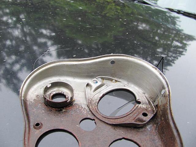

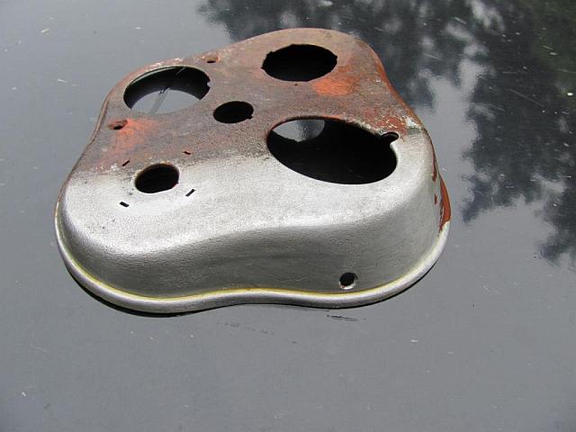

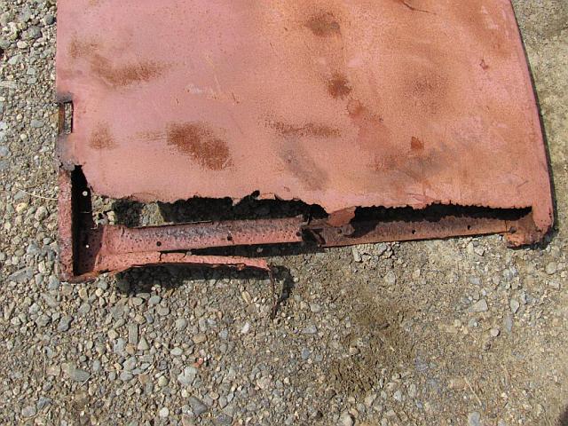

  18. GizmoJoe
    Joined: Jul 18, 2007
    Posts: 1,300
    GizmoJoe
    Sorry in advance for the long post... :eek:
    I'm never in enough of a rush to want to use a chemical that will kill me or flash rust every piece of metal in a 30 sq. ft. area... or use an acid that you need to neutralize or it will keep eating away at the part I'm trying to save.
    I really like using electrolysis IF I have a simple part with no nooks an crannies, which this method won't clean well enough.
    I love Evapo-Rust but I only use it on parts that I don't know what metals they are made of or if the part is super important. It's faster than some methods but it ain't cheap and I am.
    I'm hooked. I will ONLY use mol***es now.
    I'm not in production.
    If a part takes 2 weeks to clean I usually have plenty of other work to be doing while waiting. Plus if I have enough parts on the go that I won't be waiting for the parts to clean.. they will be waiting for me!
    We have rust. Serious rust. Blasted or dipped metal will flash rust in less that 5 minutes on a humid day. 5 minutes! No joke or exaggeration.
    Our humidity levels are high some days.. well over 80%.
    So I take rust seriously.
    This is what I do on most parts:
    1. Wash and degrease the part. If it's not degreased you are wasting a lot of time.
    2. Wire brush away as much rust as I can. Why not? Why make the mixture work harder than it needs to.
    3. Dip in 1 part mol***es to 9 parts water. Stronger doesn't seem to help.
    4. Remove from dip after 3 days and clean. Re-dip. Helps it work faster and you get to check the progress. Been told not to do that because it slows it down a lot. Not in my experience. It helps.
    5. Remove from dip when you are satisfied with how it's done, wire brush while running water over it.
    6. I may rinse with Evapo-Rust to get any left over rust then water rinse.
    7. Dry as fast as possible. Hot air seems best. Depends on humidity level.
    8. Spray or brush on a rust convertor like the one Plasticote or Rustcheck make.
    I bought some parts from an older gentleman and wanted to show him how this works.
    The attached pictures where done for contrast to show him and others.
    I did finish them after. :rolleyes:
