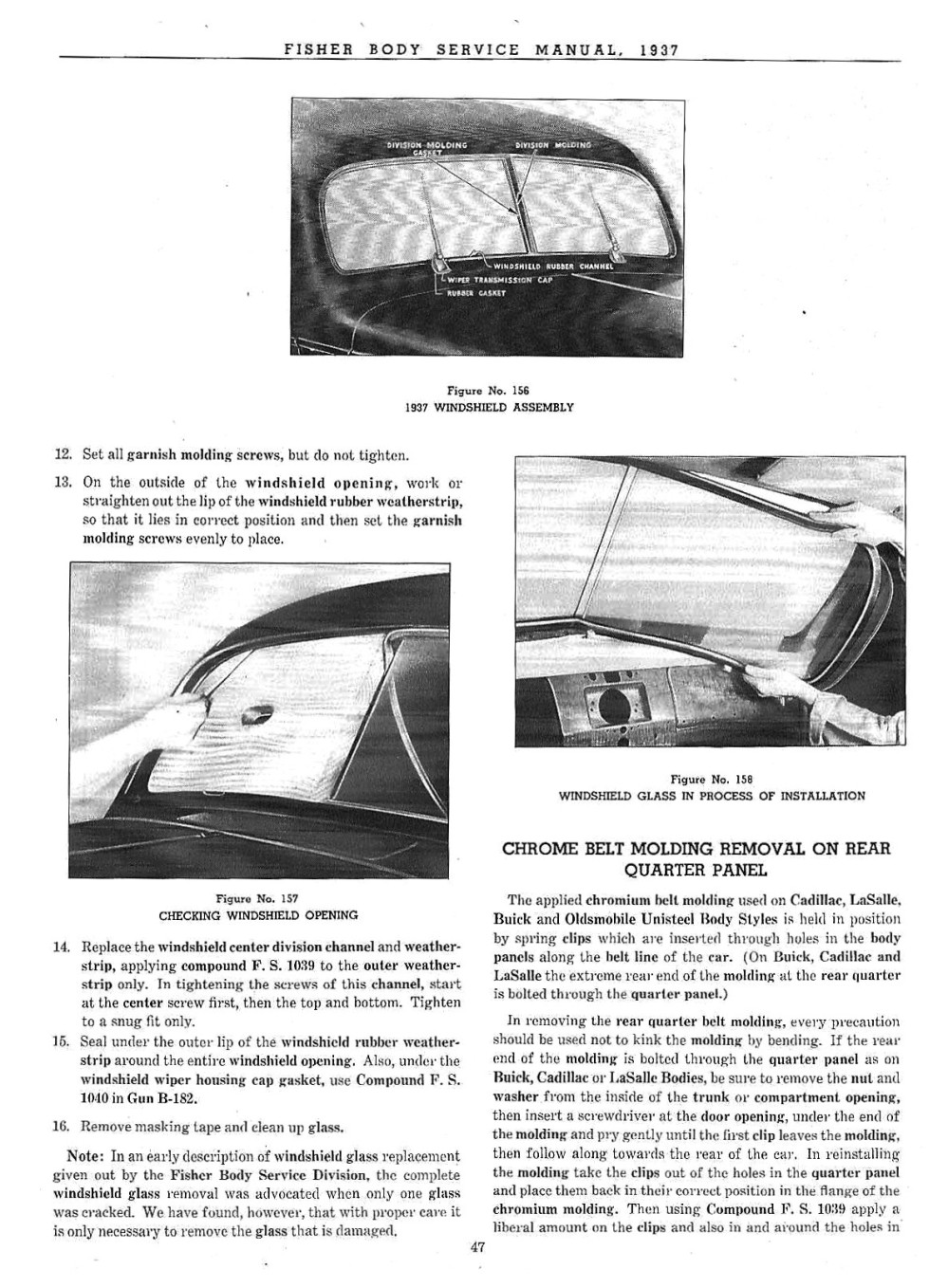

    Never saw a " glass inside the flange" mounting .
  21. squirrel
    Joined: Sep 23, 2004
    Posts: 59,682
    squirrel
    well, you've been missing out on a lot of fun.
    Here's the Chevy version
    INVISIBLEKID likes this.
  22. INVISIBLEKID
    Joined: Jun 19, 2006
    Posts: 2,647
    INVISIBLEKID
    from Gilroy,CA
    Mercury is the same..... ^
  23. squirrel
    Posts: 59,682
    squirrel
    this is the 39 plymouth manual....just for reference
