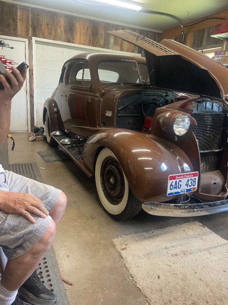

    I did a quick search and didnt see it. So I had an axled for a 38 Chevy dropped by Sids and am using 6 lug discs on the front. yeah I know not 100% HAMB worthy but I want the thing to stop. Somewhere along the line between the drop and the brakes the wheels sit too far outboard by about an inch. I want to keep the stock wheels. How does a guy find a wheel shop that will do this? If it means anything I am in South Dakota. Am I likely to find any shop local to do it or is it a thing of the past?

    I noticed the installation has a 1” or so spacer/bearing race. I imagine that is the width problem. They probably had to do that to accommodate their caliper bracket design. Looks like if you want to use that kit it is either a stock axle or a dropped one which is made to allow for it. Really can’t see how a different backspace is possible with those wheels to accommodate the situation.
    I am not sure if it is “deception by omission” or lack of research by the buyer. Although the bracket on the car does not look like the product shot.

    I am not sure if it is “deception by omission” or lack of research by the buyer. Although the bracket on the car does not look like the product shot.[/QUOTE]
    Oh I dont agree with this. They knew exactly what I was trying to achieve and wanted to get a sale rather than tell the truth. When I call and ask if I will have any problems with the original wheels with their kit and a dropped axle and they say "no", it is a little deceptive. I suppose I should have asked specifically how far it will push the wheel out. A reputable company would have it advertised and in their product description and would have known what I was asking. When asked the company stated it doesnt push the wheel out - its negligible I didnt choose the right words I guess. you know the saying "a fool and his money...."
