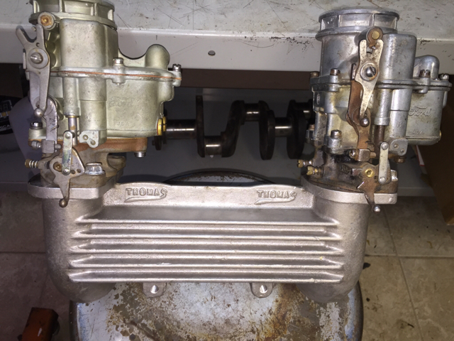

    I thought I may get a couple more responses it I started a new thread about this. I found a good matching set of Holley 92/81 carburetor with AA 7/8 bases to use on my build. I'm in the process of rebuilding them and need some input on what size jets and power valves I should start with. It is a 6:1, 080 over, with a Thomas repop intake, stock size valves and a Winfield 1R cam. I just looking for a rough starting point so I can order the parts. Any input is needed.

    I looked in them tonight and they have .043 jets in them now. As for the power valves they are 7.5hg stock and I have heard that 3.5hg to 4.5hg when running duals. But this isn't from anyone's real world experience. ImageUploadedByH.A.M.B.1452222310.970571.jpg ImageUploadedByH.A.M.B.1452222335.513741.jpg

    Thanks I will start with 4.5 PV in them and try to see if the stock .043 jets can be dialed in I might also get a set of
    .042 jets just incase they need to be slightly smaller. They seems to have a fair amount of adjustments built in to them to work accelerator pump adjustment holes are a plus as well.
